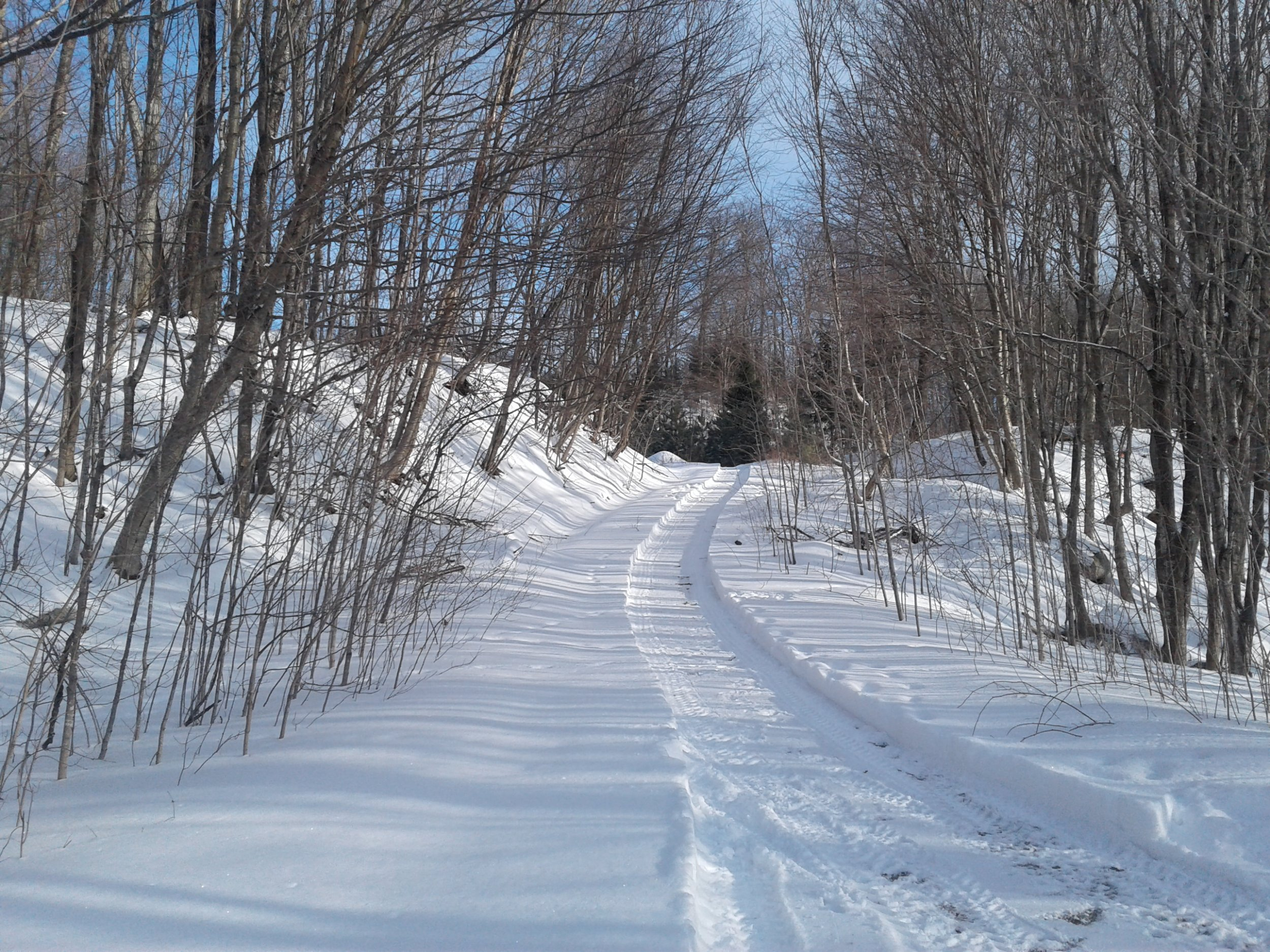

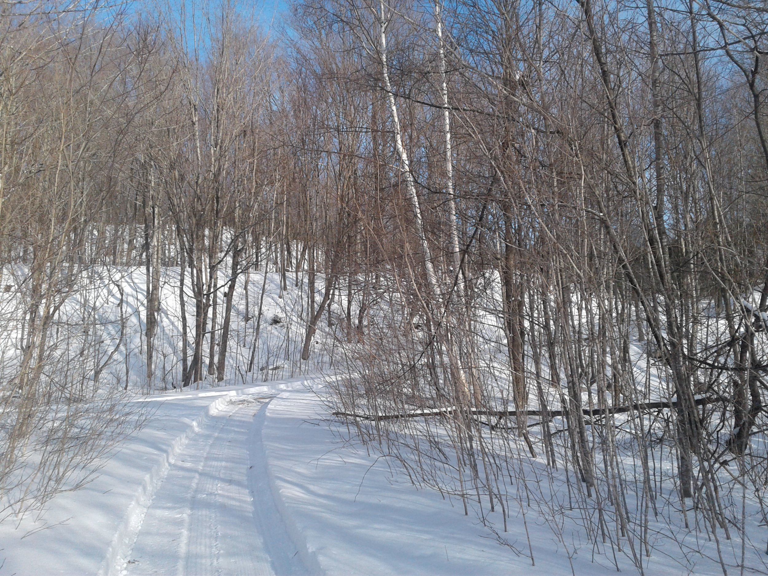

Funny, but I have no problem with R4's on snow and ice. Last winter my 2013 B2620 started getting hard to steer on ice because the original R4's have some wear and the lugs don't have nice sharp square edges any more, so I put fresh new R4's on and no issues. Just proper air pressures and throttle control.
I plow and snow blow up this hill no problem.
And my driveway has about 30 foot drop over 200 feet.

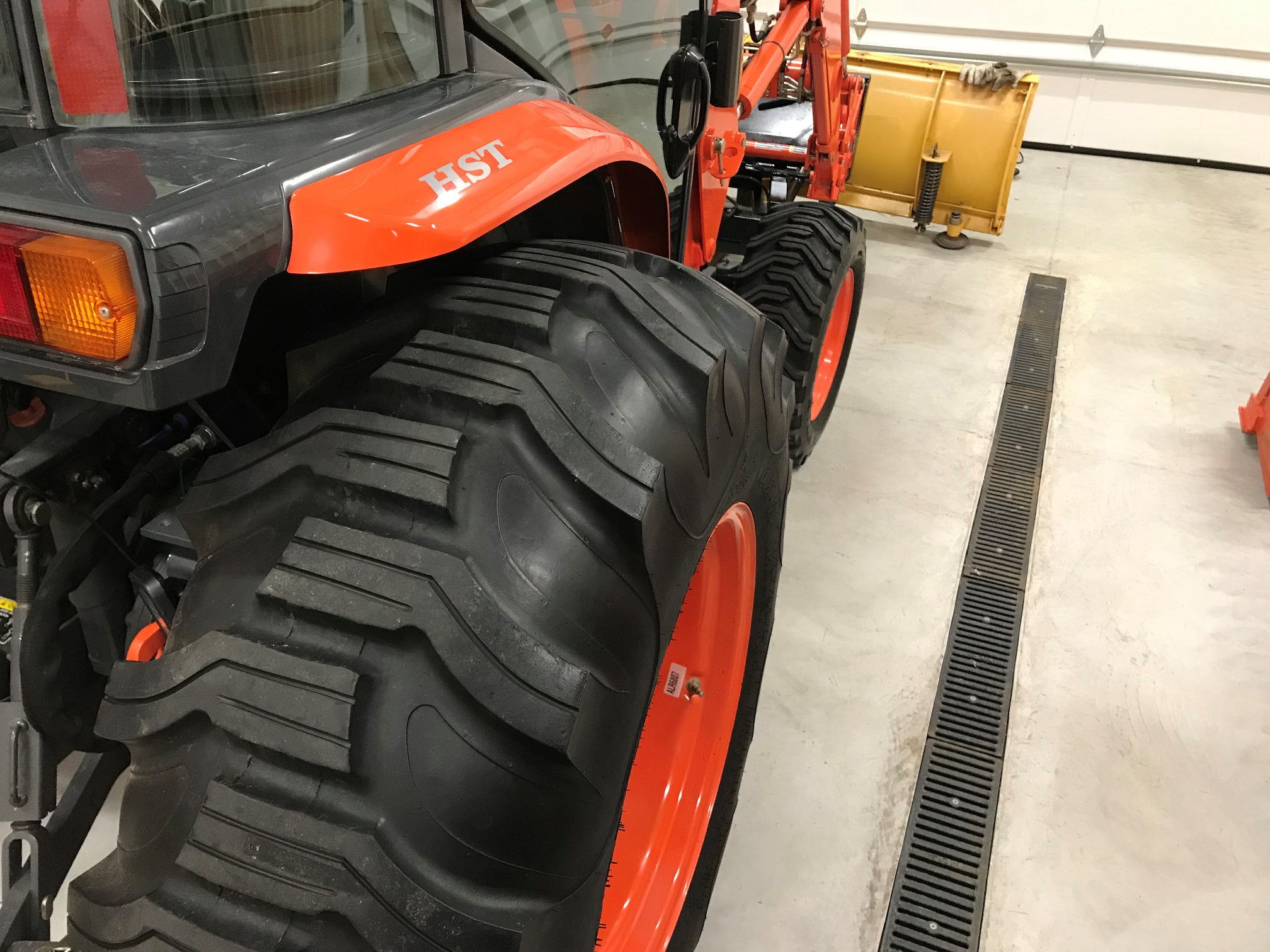

I'm sold on grooved R4's but admit to having fantasies about Nokian tires.
I've had a 2WD with diamond turfs (no go on level ground without plowing. Added chains and it was almost unstoppable)
R1's on the 4WD Ford 1210 and it moves lots of snow with a rear blade.
R4's on various Kubotas (B7500, L3200 & current L4240). They worked OK on the B7500 and L3200. Snow removal was with rear blades, loader and the L3200 had a rear blower for a couple years. After grooving the tires on the L3200 it went much better. Here's a post from a couple years ago after grooving the L4240's R4's and a shot of the L4240's tires:
