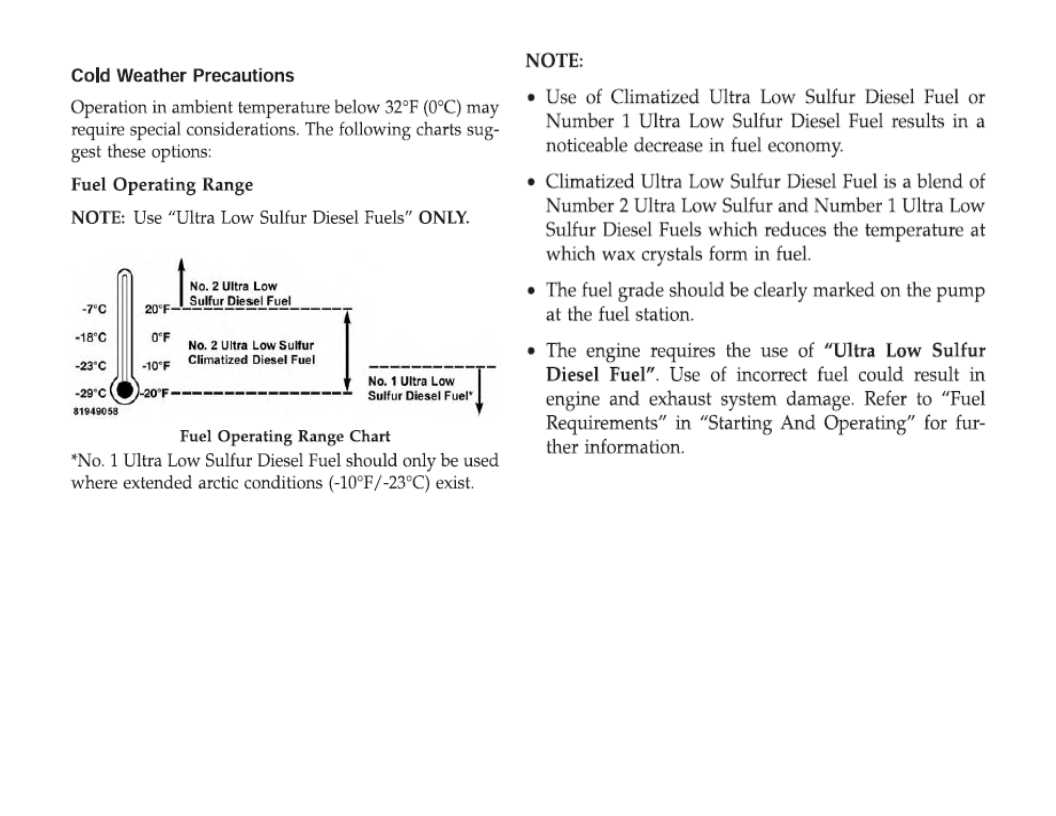

I just posted a pdf on fuels from my owners manual for my RAM 1500.
View attachment fuel and fuel heater.pdf
On the 3rd and 4th page,
They have one definition of fuel types and temperatures.
enjoy

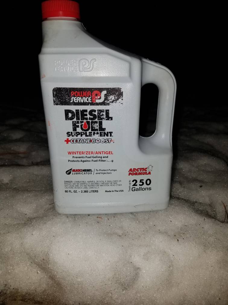

I use the gauge on the side of the jug. I glug, glug, glug. Rough guess. Always error on the high side. It's not rocket science.
Very respectfully NO, NO, NO ! You do not want to add more then suggested by the maker of the anti-gel. Learned that the hard way when I "glugged, glugged, glugged" in some on one of my tractors years ago. What it basically did was turn the diesel into something closer to gasoline and the tractor barely would start and most of the time could not be kept running. I strongly suggest to NOT TO OVER GLUG the anti-gel.
Wow, you must have seriously over treated. PS jugs have an ounce gauge on the side of the jug. If I need 15oz, I glug glug using the gauge and call it good. It's very possible that I added 16oz. But I didn't add 20oz.
   / Winterizing diesel #46
Yes I did. I wish I knew how much I added but being ignorant about the effects of the additive if used in excess I just poured what I had left over from a several year old container. NOT the way to do it. I would guess I added 4x-5x the suggested amount but that is only a WAG. When I drained the tank the "diesel" was very thin, almost like gasoline and it did not even smell like diesel anymore. Again, do not add more then you should is my advice.

This is from my pickups owners manual, FCA's definition of fuel types;
we will see if it's legible.
