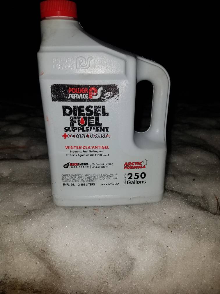

I buy the 80 oz jugs which treat 250 gallons.
I keep some in stock all the time so can shop sales. I usually pay $11 for 80 oz.

Diesel Fuel Supplement +Cetane Boost - Power Service
mplete directions are printed on each container label.
This product is to be added to the fuel. DO NOT ADD TO THE DIESEL EXHAUST FLUID TANK.
If your vehicle will not start or gain power in cold temperatures, use Power Service Diesel 911 (in the red bottle) as directed on the container. After the engine is running, add Diesel Fuel Supplement +Cetane Boost.
16-OUNCE (PART NO. 1016)
At temperatures above 0°F., add entire contents (16 ounces) to 40 gallons of diesel fuel. When temperatures drop below 0°F. or when using biodiesel blends, add entire contents (16 ounces) to 20 gallons of diesel fuel.
32-OUNCE (PART NO. 1025)
At temperatures above 0°F., add entire contents (32 ounces) to 100 gallons of diesel fuel. When temperatures drop below 0°F. or when using biodiesel blends, add entire contents (32 ounces) to 50 gallons of diesel fuel.
80-OUNCE (PART NO. 1080)
At temperatures above 0°F., add entire contents (80 ounces) to 250 gallons of diesel fuel. When temperatures drop below 0°F. or when using biodiesel blends, add entire contents (80 ounces) to 125 gallons of diesel fuel.
as you can see, based on their list there is a difference: 2.5 gallons per ounce on the 16 ounce containers, 3.125 at 32 ounces, and 3.125 at 80 ounces. Why the difference at 16? I don't know, probably to idiot proof harry the home owners 5 gallon jugs. It basically doubles at 0 degrees, 1.25 , 1.56, and 1.56
