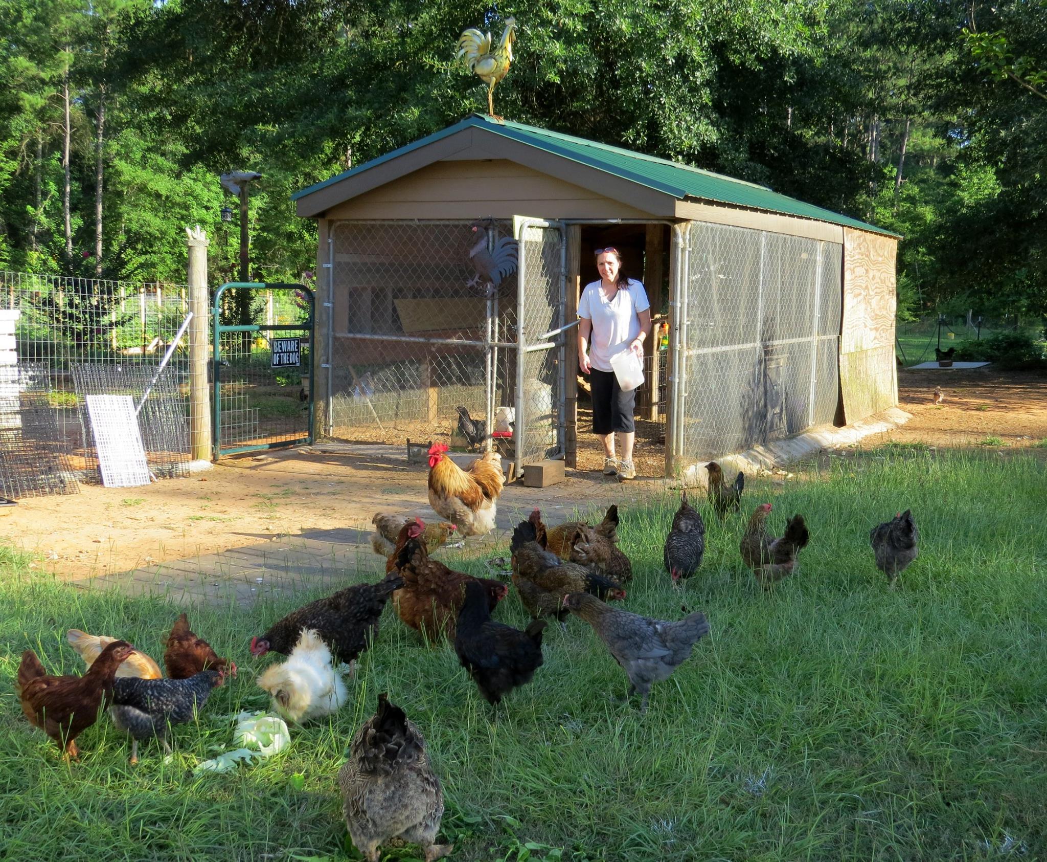

This isn't hard to do, Eddie.
Back when my pool was being built in 1998, I made a ground tamper out of 2" solid railroad steel rod about 5' long and a railroad tie plate. It looks sorta like this:
th
Fast forward to 2015 or so and I needed to fence my dog run with +200' of fencing. In this case 5' goat fencing I think they call it. At my age, there is no way I'm walking around trying to unroll a 100' of fencing. :(
I simply clamped the tamper to one of my forks on the front of the tractor (using another tie plate and some bolts to do the clamping), put the fencing on the steel handle vertically and then unrolling it by driving backwards where the dog run is located.
I don't have pictures of the tamper or while doing the operation but here is a pic of the final product:
In the pic above, you can see my chicken coop attached to my chicken run (two 10'x10' chain link dog run minus one gate section) and then the dog run surrounding that using the one chicken run gate section as the gate for the dog run.
It's in the middle of my Poplar grove so it was a bit tricky maneuvering the tractor while driving backwards, but it worked out great. The fence was tight and is working pretty good (except for some storm damage from falling limbs).
Good luck!
