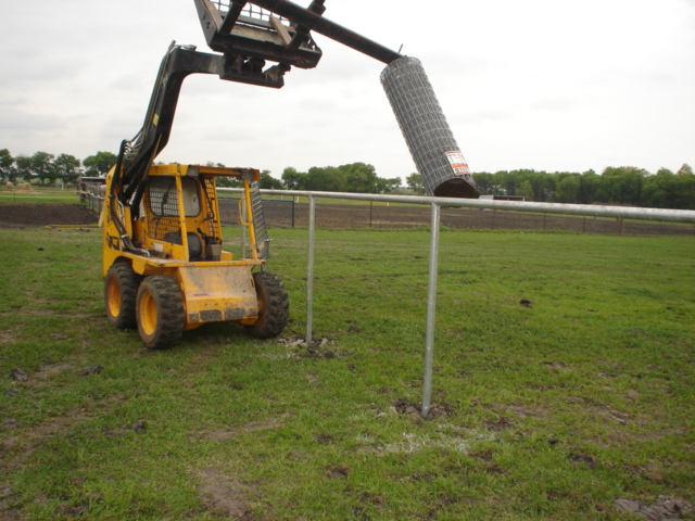

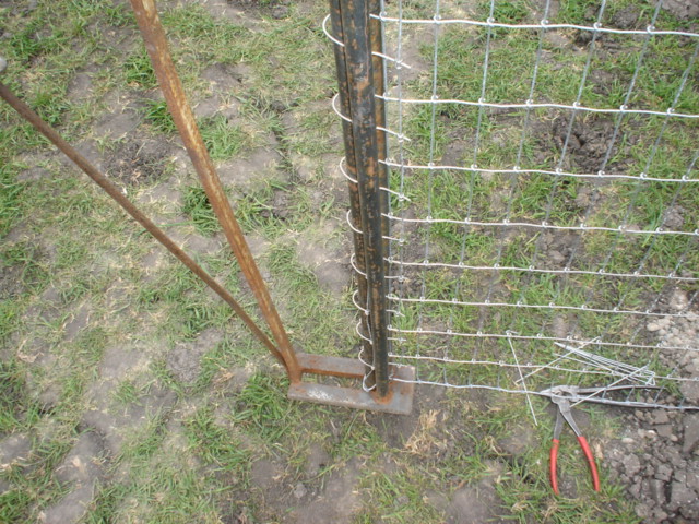

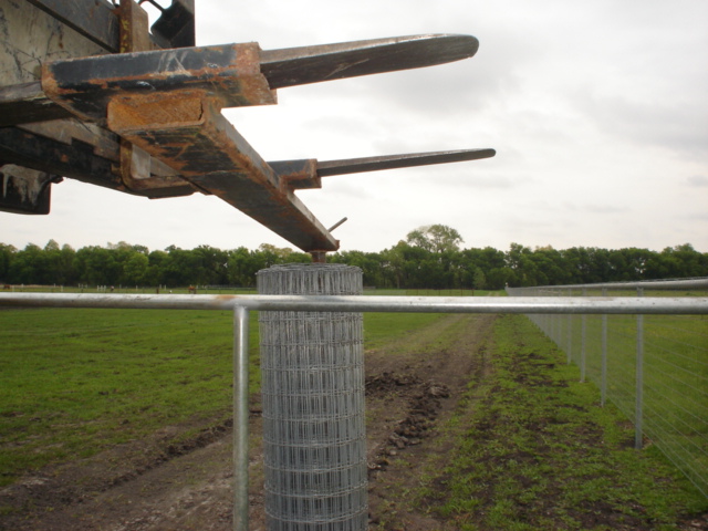

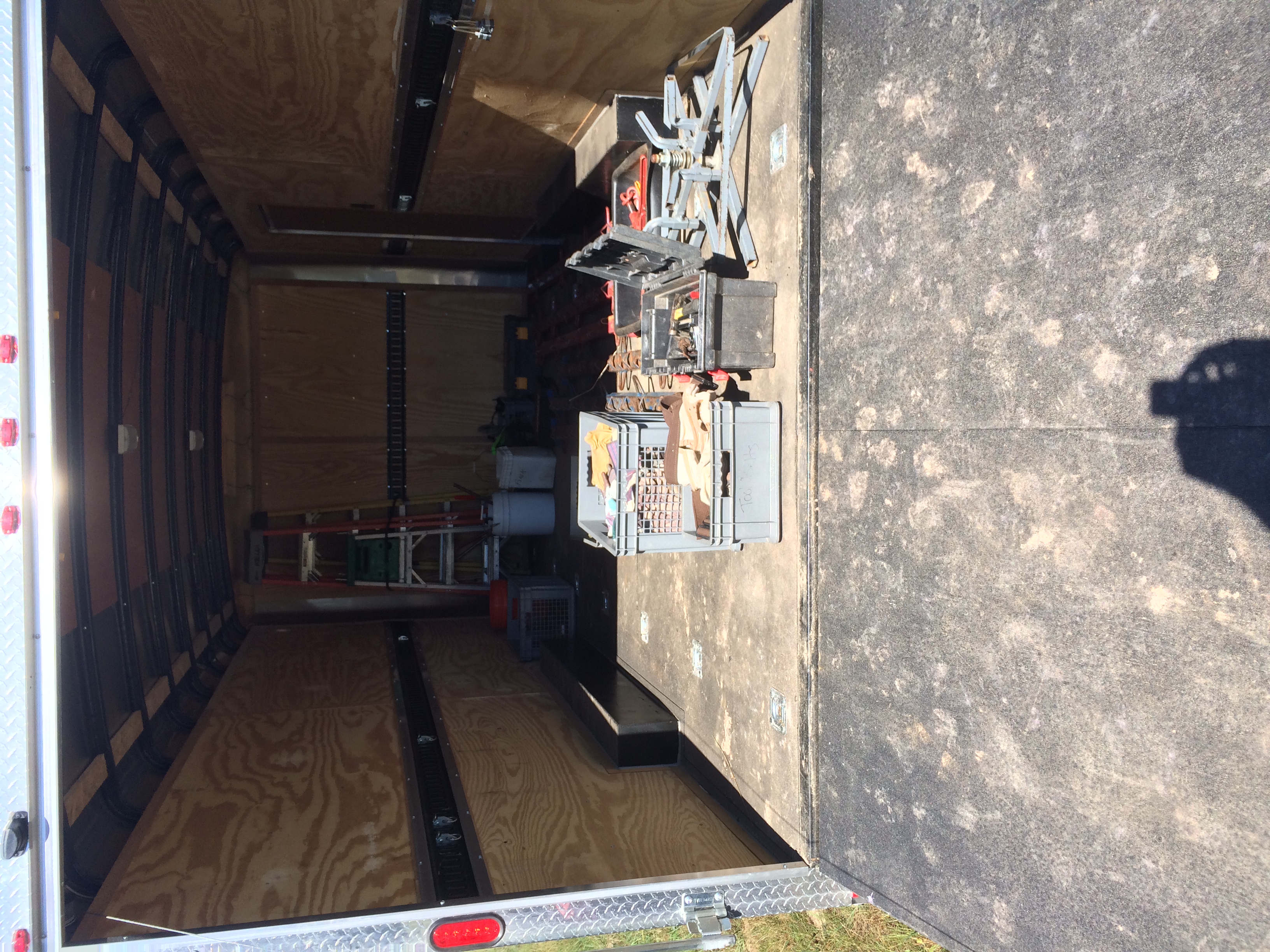

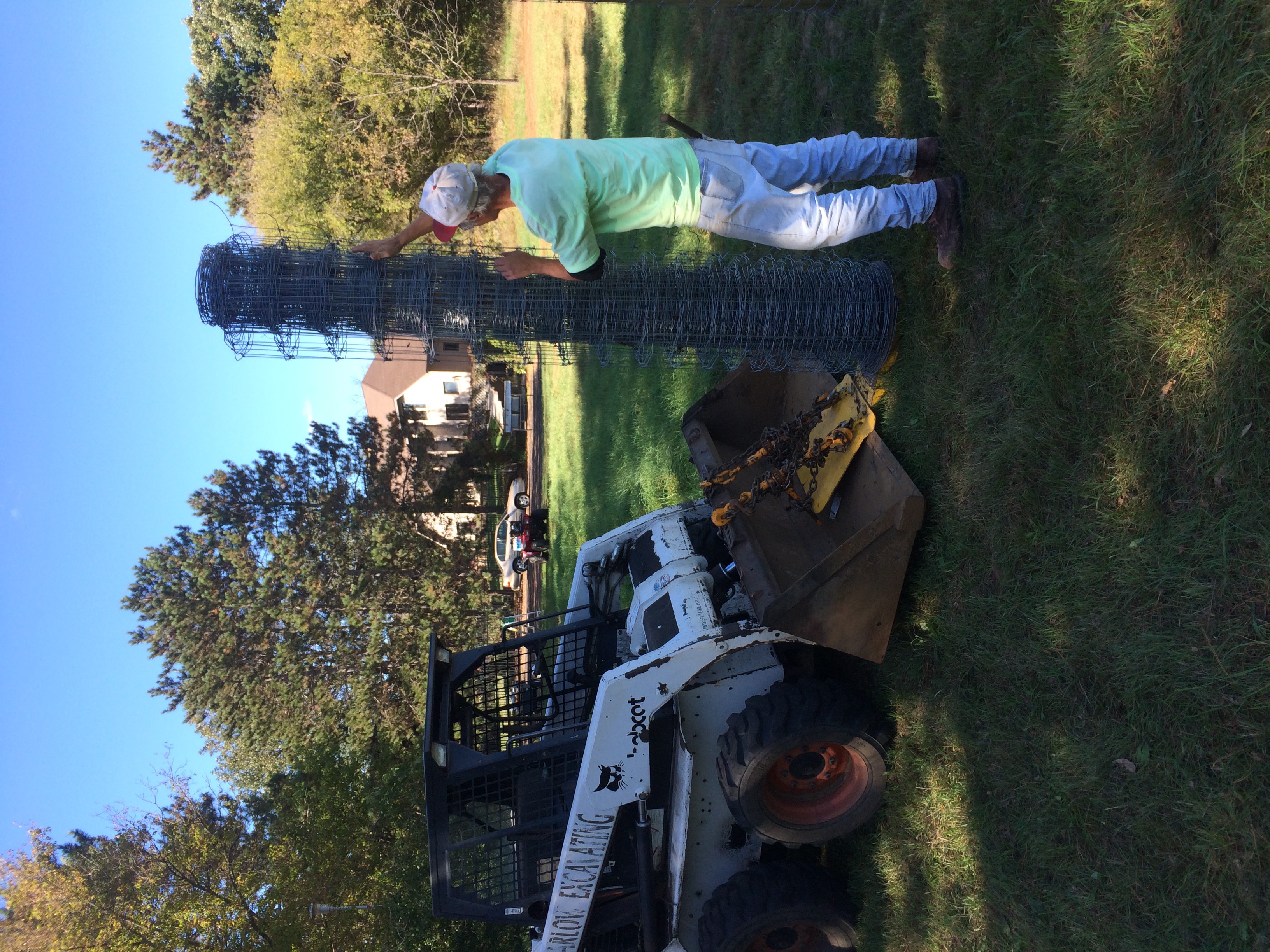

We had some deer damage to our grape vines. The Minnesota Department of Natural Resources gave us $5000 worth of fencing materials for free. Our fence cost $7000 so I had to make up the difference.
But the DNR also showed up with an enclosed trailer full of all of the tooling for installing fencing and left it on-site for a week or so until I was done. That was sweet!
Another way to attach the fence unroller.
The attachment to the front bucket looks very interesting. Do you have any more pics of that?

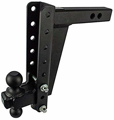

I would find or make a 2 inch insert sort of like this one:
Then make a vertical post out of either round or square pipe and put a flat plate on it for the spool to sit on so that it is taller than the receiver insert.
Then you can load the roll of fence wire onto the spindle while it is leaning down and then flip it up and pin it in place to unroll it along the fence line.
