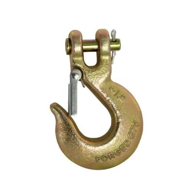

Another good thing about chain is the hook ends are easily installed without any wire splicing.
This hook has a more heavy duty latch mechanism. Amazon.com
I've not had any trouble with the slip hook coming loose on the log end.

I have a bucket full of 3/8" chains but the past few years have been almost exclusively using 1/4". They're much easier to work with and can handle a lot more tension than my L4240 can dish out.
I have a few chains that I made up with slip hooks like the ones below. Also made a short chain with two grab hooks like WranglerX shows for oddball applications. Regular slip hooks have such flimsy keepers and are about worthless.

I have at least two dozen hooks with those lever keepers, between various chains and tow straps. I can tell you not a single one of them has ever survived more than a few uses. They're all bent, distorted, jammed, or broken. I usually get around to grinding them off, if they're sewn into a strap, or replacing them with non-keeper hooks if they're on a chain.
I do like using chain as a choker, I have four made up with a grab hook on one end and a slip hook on the other. I've found that the keeper really isn't necessary, if you lay the chain right when setting up to lift or pull. If you can't manage that, I'd bet WranglerX's mousing trick is more reliable and less frustrating, although I've honestly never tried that.

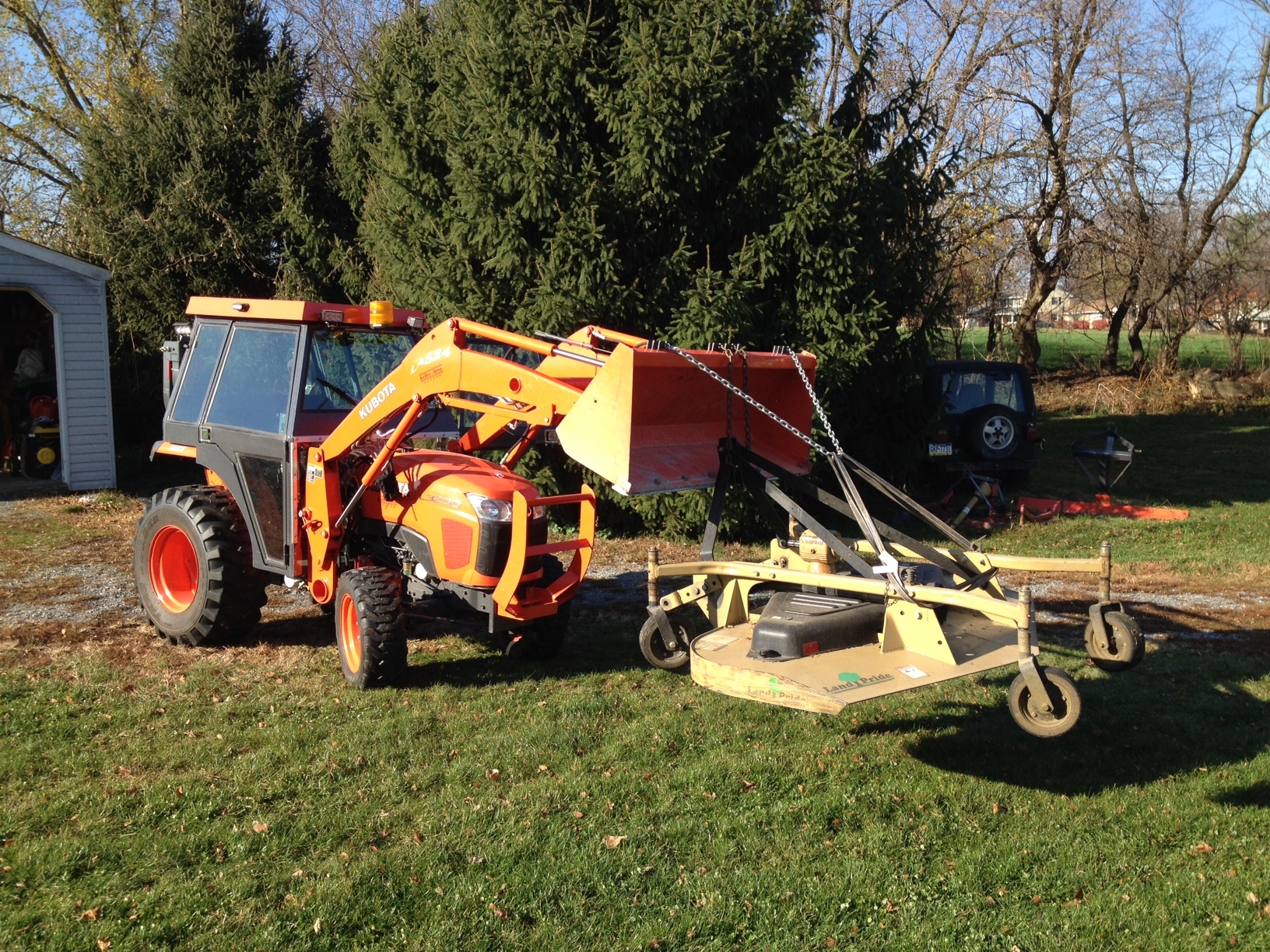

I generally center the load on the loader. Not sure it's necessary, but have a feeling it could lessen the chance of tweaking the loader frame. I have no concern about using the center slot to grab any load. In the picture below, that 6' LandPride RFM on the L3200 is rigged that way because of the location it needed to be picked from. That weight with the chains at that angle placed a lot of stress on the rigging.
