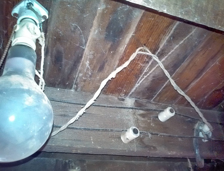

Here's a photo illustrating the worst of the farm wiring I've encountered. I went down in the farmhouse cellar - dirt floor, low ceiling - to see if it is reasonable to string Cat5e to move the principal router to a better place in the house. Looking up at the wiring there ... just plain scary. :eek: The barn and cabin were wired in 1968, 30?? years after this old farmhouse was wired for electricity so their wiring looks cleaner than this but who knows what amateur non-code wiring might be in those outbuildings.

That is what they refer to as "knob and tube" wiring. I used to cut through a lot of walls in older homes in Chicago adding ductwork, it was always "fun" when sparks flew and the lights went out!
