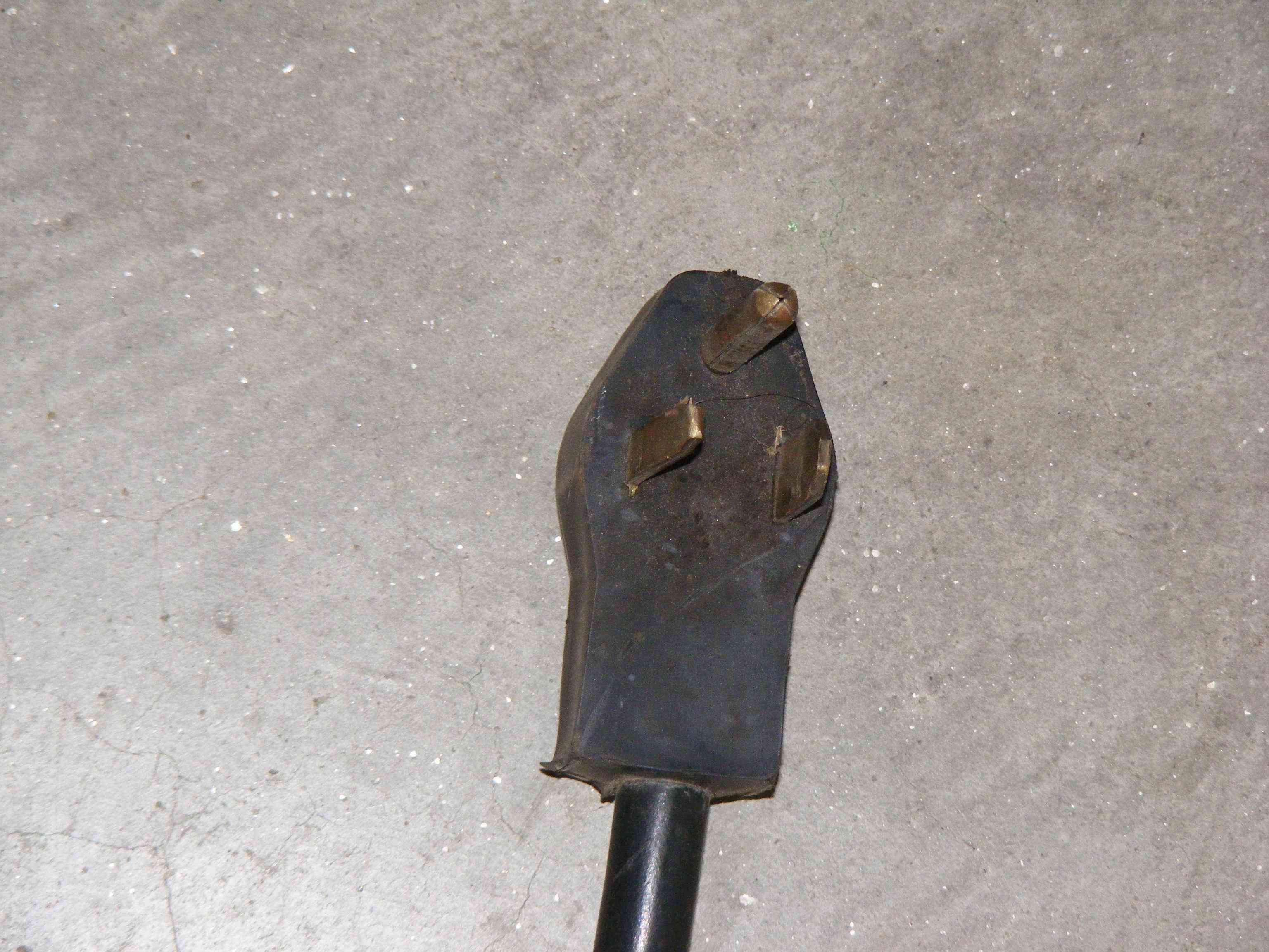

First, I think it's wrong for a manufacturer to include a plug that will fit into a range outlet. One is a NEMA 6-50R the other is a 10-50R. The 6-50R is the correct one. Most welder supply houses will have it if you ask for a welder outlet. Is it more convenient to install a range plug? Yes. Because they are more readily available. And people don't know there is one dedicated for a welder.
If you look at Table 310-16 of the current NEC, there is an asterick on #10 wire. The asterick directs you to Article 240-4(D) which directs you to 240-4(G) for Special Conductor Appilcations. That in turn says to look at Article 630 for Electric Welders, which says for one welder on the circuit, you can fuse the feed for the welder at 200% of the conductor ampacity. #10 THHN/THWN is actually rated for 40 amps, so if I fuse it at 200%, it's good for 80 amps for a welder.

Man, this is a hot topic, no pun intended. Let me state a few things and hopefully this thread can be put to bed. The difference between paying an electrician and doing it myself is the difference between getting to use the welder and not, at this point I cannot afford to pay someone to do it. I have done electrical work for 20+ years and the final outcome is usually better than if I paid someone, I never scrimp on this stuff just don't want overkill. BTW, my existing welder is in the basement right near the walk out door so that I can weld outside or if needed open the door wide and weld just inside out of the weather with a fane blower out. Any new wire I run will not be within the wall and will be removed if I move. Attached is a picture of the current plug on the welder. Thanks for all the posts.
   / wiring for welding
#50
The picture is on this post. Now that I look at it and google the 6-50R one they look to be the same. So no range plug.
