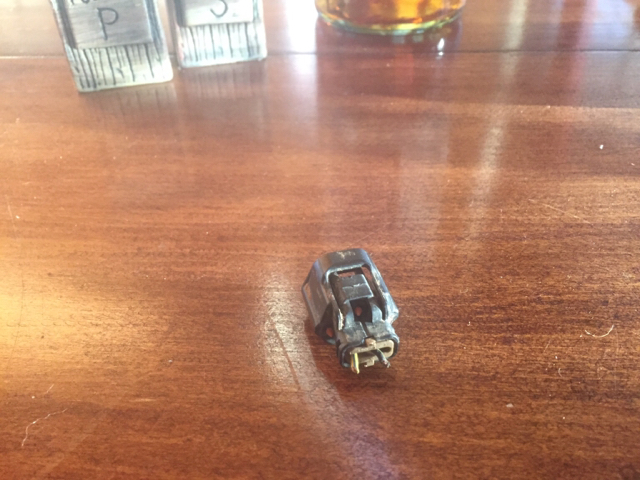

So the mice ate up a few wires and didn't leave me much to splice into.
This is to my gas gage sending unit. Not sure there is enough to solder onto. Can u buy these with a pigtail or is it possible to disassemble?
All advice welcome.

There are kits available at auto parts stores to rebuild or replace the pins in the plug. I have had the same issues. Almost makes me want to have a cat around.
/ Wiring harness connector help #3
Good advice from Dave. If you can see any numbers on the plug google them. You should be able to find an exact replacement on Mouser or Digikey.
/ Wiring harness connector help #4
Use a broken off radio antenna to slide over the pins and pull them out. Resolder and push back in.
I'd solder them how they are but it takes some experience.

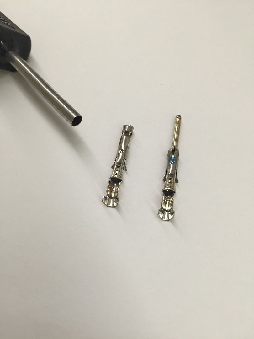

Although I can't see what kind of pins your connector has, they are probably similar to these in the pic. Notice the little barbs on the body of the pins. This is what locks them into the connector body. The black tool is a pin pusher. All it is is a hollow tube which slides over the pin and depresses those barbs which lets them come free of the connector. The antenna is made to be a pin pusher tool.
Clear as mud?

It looks like there is enough there to solder too. Strip the insulation from what wire there is, lay the stripped end of the patch wire against the stipped stubs then wrap them together with some small copper wire wrapped around both several times. Then solder them together and add some heat shrink over each wire then add some larger heat shrink around both wires to provide some strain relief and annoy the little varmints who what to chow down on your wires again.

Thanks guys! After. visiting a few auto stores that had no clue I picked up a small Soldering iron and did exactly what u said. I'm estimating there was about 3mm exposed so I soldered up, individually heat srinked, couple individual wraps with electrical tape then both wires wrapped with tape then large piece of heat srinked together then loom.
Resistance checked out and gas gage works again.
