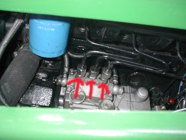

Well I be XXXX the wife wanted to learn how to drive it so after an hour of lessons she managed to get it stuck and stalled it out going uphill. I thought no big deal told her to restart, well all we got was engine just turned, no smoke no start. Tried several more times, same results. I got the started fluid sprayed a couple of squirts, engine coughed and knocked but didn't catch. So now I am thinking since it's pointed uphill perhaps it ran out of fuel. Filled up the tank still no start. I just don't think it is getting fuel. Any advice?

Sorry, I did prime it I also unscrewed the bleeder screw [the one with the ring]. Is there a certain proceedure to this, meaning do I first unscrew the bleeder, then pump??? I did notice that as I suspected there is no fuel going into the injectors. I unscrewed one of the injector fittings on top of the fuel pump then turned it over, no fuel came out. Is there supposed to be fuel coming out while using the manual primer pump? Less than 10 hours and already broke. That's a new record for me.

Running out of fuel also sucked the fuel filter dry. If you didn't fill the fuel filter after topping off the tank, you're going to have to do a LOT of pumping to fill IT up - BEFORE you get any fuel at the injectors.
Loosen the fuel filter, pump till you see bubbles coming out the top. Tighten it slightly, pump some more - till raw fuel runs out. Tighten it down completely. Loosen the hard lines at the injectors slightly and repeat the process. When raw fuel runs, tighten down and try starting again.

Do as Greg stated and also make sure fuel shut off didn't loosen up and let lever move to fuel shut down even though knob might be pushed inward. Stranger things like this happen once in awhile.

The second thing I did was to unscrew the lines leading to the injectors to check for fuel. I am unsure if I have the right ones please see the picture with the red lines. I unscrewed all three and pumped, no fuel came out. Now what?

Greg, I hope I followed your directions. If I missed something please let me know. I don't mind trashing the fuel filter if it will get it started,,,,
