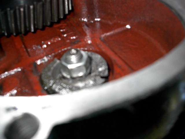

Alright here is what we got.
This is a picture looking into the housing from the front of the engine, I took the radiator hose free for better access.

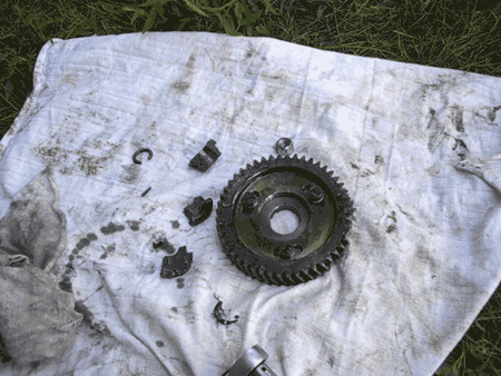

Re: Won\'t Start after Stall
Here is a picture of the gear after being removed. I only had to pull mine out but you would normally remove the center nut.

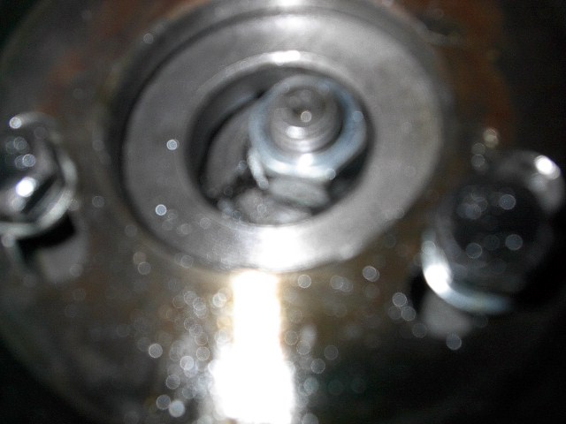

Here is the damage inside the housing.

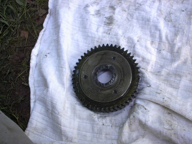

With center nut removed I pull the pieces of metal out and assemble on ground.

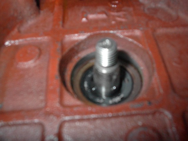

And this is the inside of the housing looking at the injector pump shart. I am afraid the shaft is too damaged to use. What do you all think? Picture might be grainy. But the key way is ground down on the front of the shaft. The rear of the shaft looks fine.
   / Won't Start after Stall #46
Have you checked the pump to see if it will turn? Looking at the exploded hub, I am afraid the pump may have seized. I hope not.
Changing the pump is not too big a job. YOu should be able to get the parts from your dealer, hopefully under warranty. If not there are many sources where you can buy parts. we do stock that pump, but I do not have the flange that the gear bolts to in stock.
Let me know if we can help.
#47
Bluechip I have not checked to see if it would turn, from just looking at the shaft I feel it is a loss and a new pump assembly is in order. Since it is under warranty its a no brainer. I will go down later today and see it I can get it to turn. Should it spin freely or provide resistance?
   / Won't Start after Stall #48
They are pretty stiff to turn, especially if there is fuel in the lines. IT is similar to turning over a small engine, three cylinders trying to compress diesel fuel, well sort of. If you crack the hard lines open it sould turn easier.
   / Won't Start after Stall #49
7corners bummer breakage:
to test turn I would loosen the injector fittings on top and crack the D-ring drain fitting too, lets fuel flow freely. .. just to check to see if the pump turns, I would say if there is any damage then get a NEW injector pump from them ASAP.
ANYHOW that was a good catch and yes a PITA but all is not lost. maybe ask the dealer to get you a NEW pump & gear assy from one of the other dealers who has one in stock cheaper or ask to get a NEW loaner tractor while this one sets... NOT SURE who you're dealer is but some of them have enough in stock to swap emo ut. and or maybe swap out the parts...
