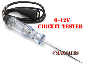

That unit seems neat. What I really need I saw on a UTube video. A mechanic was chaseing a short on a jeep. From the unit and a drawing he isolated it to a specific wire harness. Using a 12vDC probe he would get the short to trip the probe. Then knowing the short was in front of him he would use an amp meter which could tell him if the wire was hot. He kept doing that until he discovered a short from the Oxygen sensor without cutting any bundle of wires. The meter would tell him if a wire in the bundle was good or bad. Neat
This sounds like the 'Power Probe' device? You do not need one.
You need a basic 'test light' or the standard VOM. Test lights are of this form (A clip to 'ground' one end of the wire and a spike to probe with the other end. A bulb in the handle will illuminate if power is present.)

So you've ordered a fuel pump solenoid, but never tested the existing one to see if it was cutting out as the engine stalled out? Please confirm this specific question, without all the description of shipping and handling issues.
And as far as your VOM, put it on DC Volts scale and use black lead on ground and red lead on hot and see what readings you get when testing DC circuits.
And if testing something like a possibly blown fuse, put it on the Ohms scale and use it to test open or closed on non energized fuses and such. Every other scale is mostly irrelevant for what you're doing.
