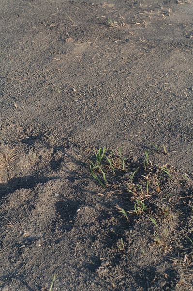

PhysAssist, I think it would. The key, IMO, is having enough weight to keep the contraption from just bouncing around or riding over the tough spots.
When I moved into my new house, all I had was my GT235 garden tractor. I used this pallet I found in a construction dumpster to prep my yard for laying sod. It was free except for the cost of a few feet of 1/4" chain and the hardware to attach it. I eventually added some weight to the top of it to make it bounce around less. It took a lot of passes to level the yard, but it worked well.

Improvise, adapt, overcome.
Sign of an active mind.
