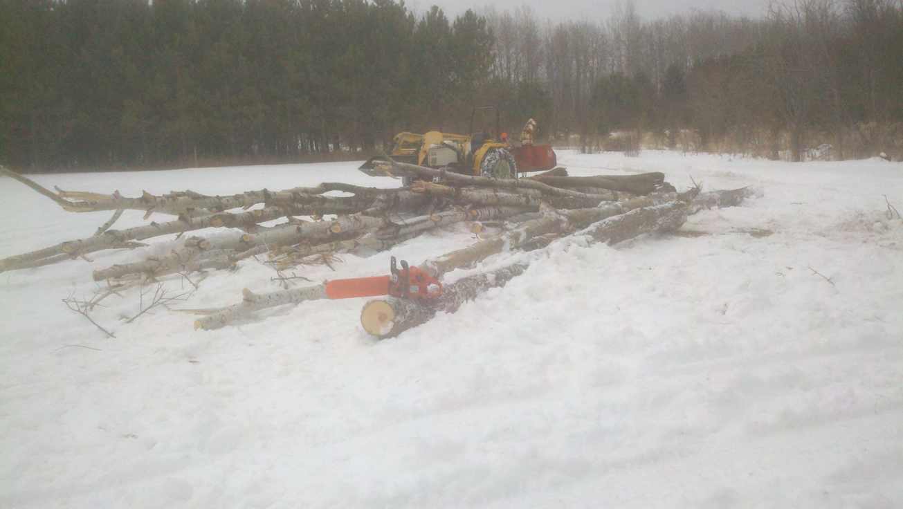

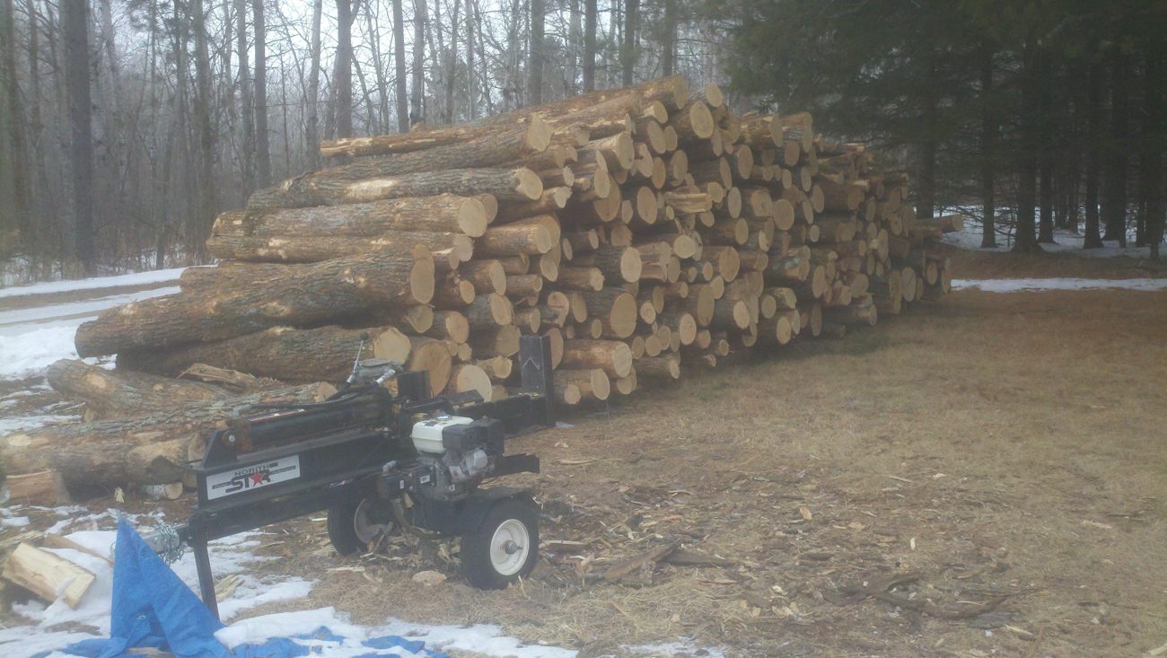

It is my first year burning wood. I do not mind the css it is the feeding the beast every four to five hours that I do not care for.
I did purchase a ten cord load of red and white oak for $70 a cord.
I also have a lot of poplar on my property I can harvest.
Right now I am in the research faze of the purchase. Actual purchase is most likely one to two years away.
