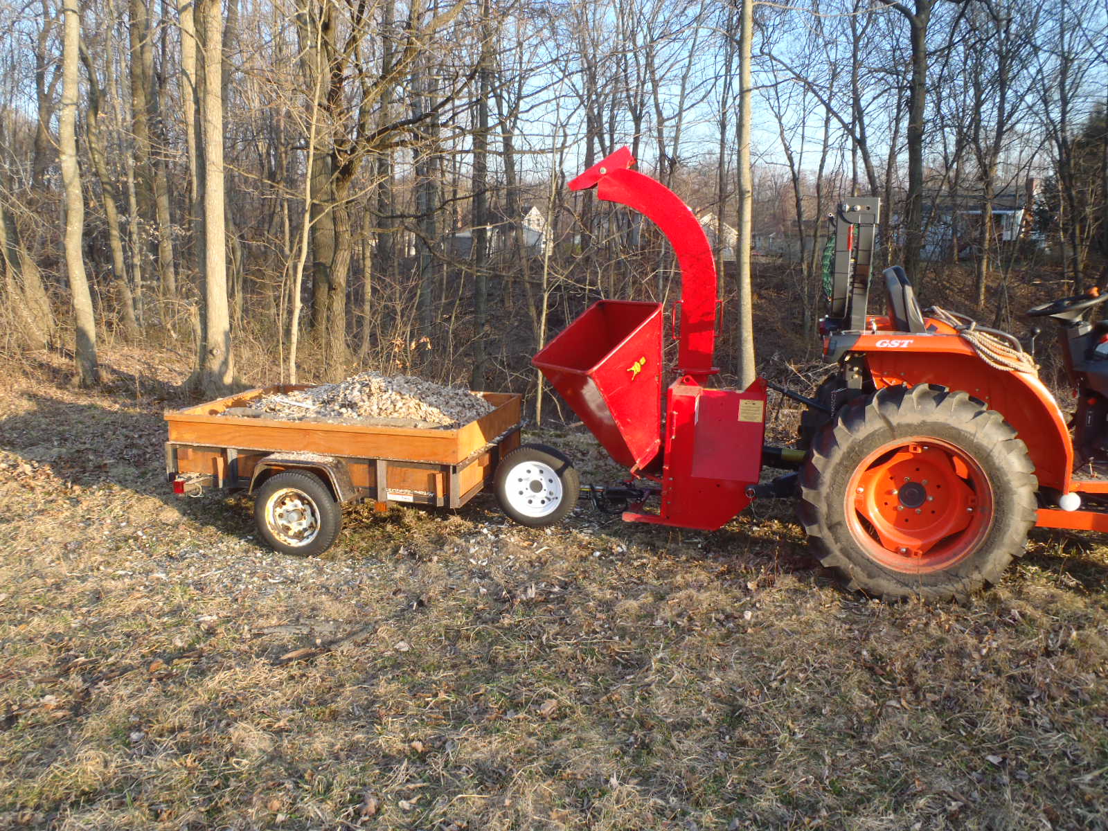

I bought a used Patu Chipper for my B3030. I figure that every 6 months we seem to get the storm of the century, so I want to be ready.
Good luck.
Attached is pic of my chipper.

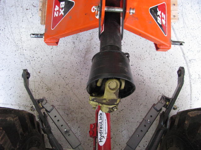

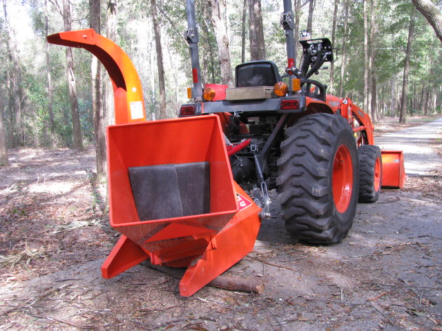

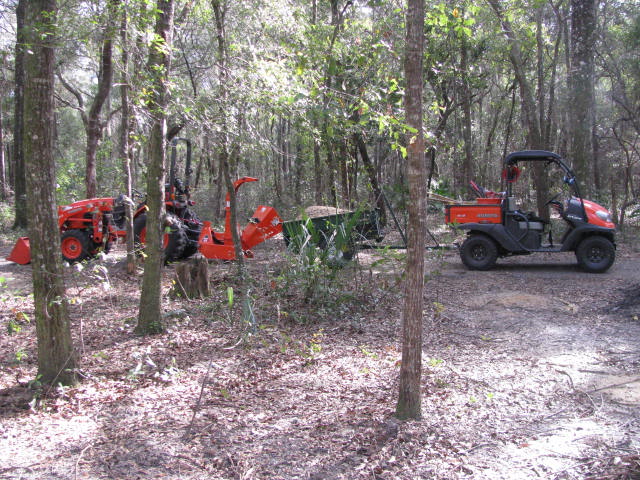

Another vote for Wallenstein from contented owner of a model BX42s. I think this model will run FINE behind your BX25. And, yes, that 4" X 10" mouth to the chipper knives is a BIG positive.
The rotor/flywheel on the BX42 weights 110 pounds, the heaviest in 4-5" class. Once the PTO has rotor spinning at 540 RPM the inertia power of the revolving rotor, not the tractor engine, is supplying most of the energy to the four chipping knives bolted to the rotor.
Wallenstein chippers are manufactured by EMB Manufacturing in St. Clements, Ontario, so you likely can purchase cheaper in Canada. PH: (519) 699-9283
I store mine on a dolly in the garage. Lesser implements remain outside under canvas.

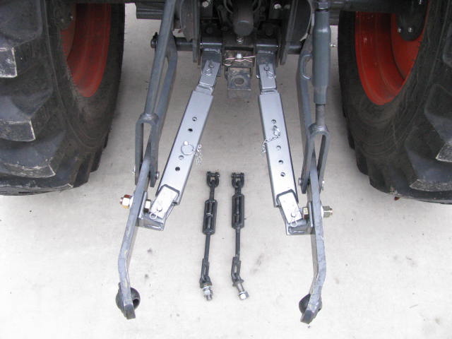

I replaced Kubota factory "check chains" with pin-adjustable, rigid, stabilizers from Stabilworks. Stabilworks' mechs make loading implements onto the three point hitch a breeze. Well worth <$200. Stabilworks' mechs also strengthen bracing of lift arms by 50%.
LINK:
Kubota tractor stabilizers Kubota [url]www.stabilworks.com - YouTube[/url]
My tractor is a Kubota B3300SU / 33-hp---> 25-hp PTO / 1,800 pounds.

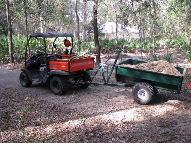

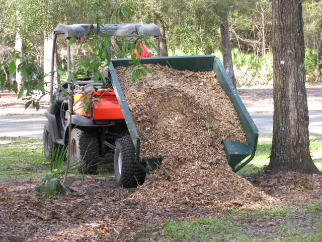

Shoot, I may as well plug excellent MUTS (Canadian built) trailer too. Great for hauling/dumping chips.

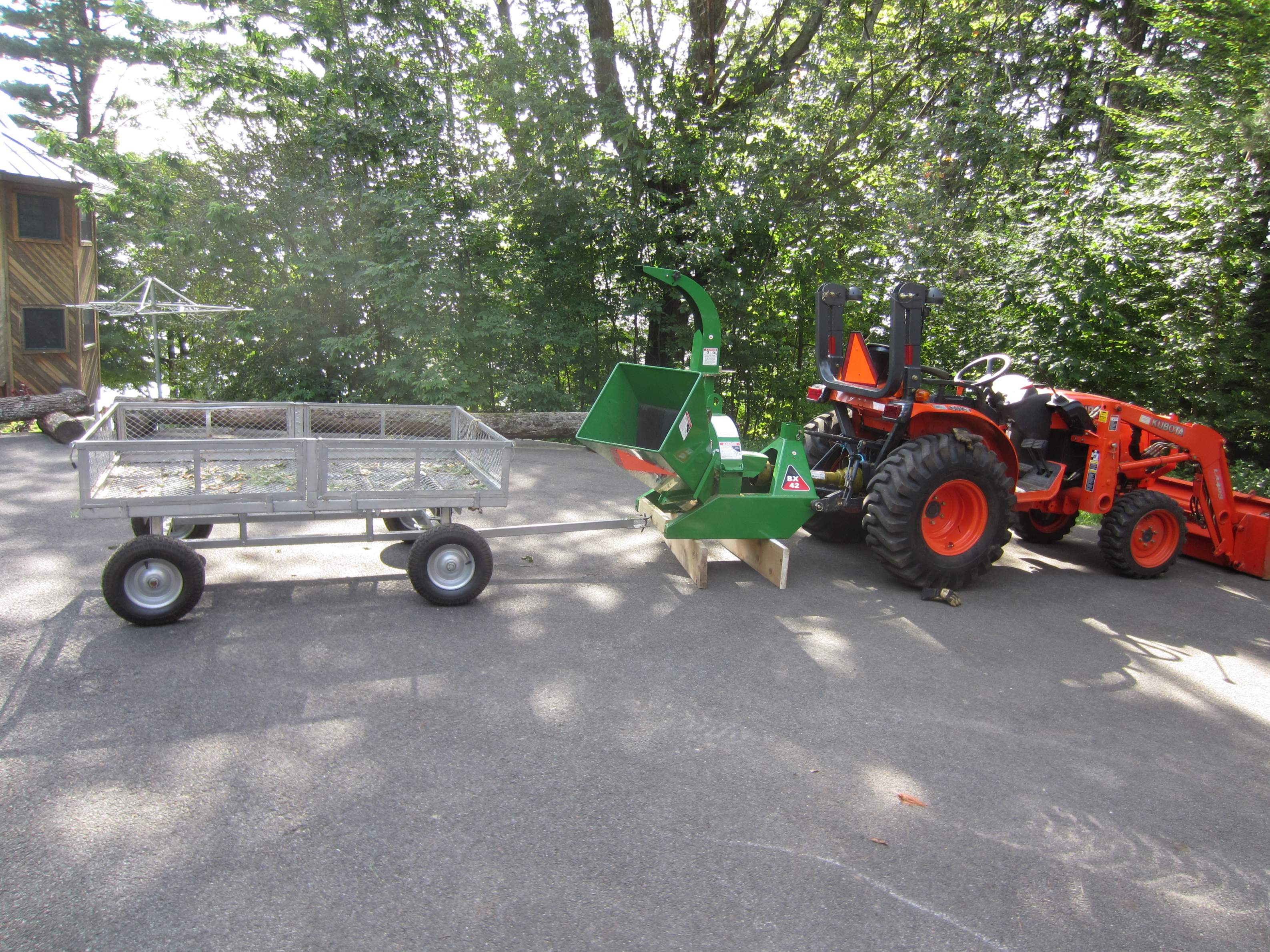

I agree with all of the favorable comments on the Wallenstein 42 - a great machine. I run it behind a BX25 and B3030. One useful item I added was a hitch for a trailer so I can shoot chips into the trailer while moving around the property. It works very well.

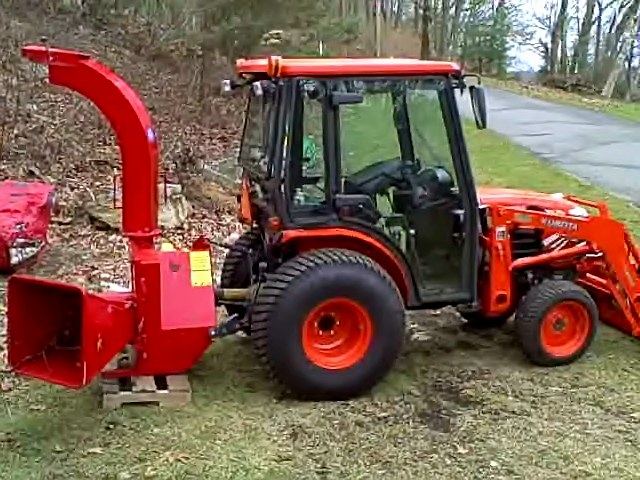

Another vote for the Wally BX42 which I run behind my BX25. I did have a DR PTO chipper before that which also worked well, but the Wally handles the 2"-4" material much better. It will self feed larger material better than twiggy stuff but you will have to trim large-crotched branches so they feed in. I would not rule out hydraulic feed if you can swing it. I don't know if the BX25 has sufficient flow to meet the spec's for the hydraulic motor on the BX42R, but I"d sure like to try it. Just couldn't swing the extra dinero's for hydraulic feed.
As you can see from the pic's the Wallenstein is much more substantial in size/weight, though the performance of the DR wasn't that much inferior than the BX42. The DR uses a belt and gear to turn the rotor at higher RPM while the Wally is a direct drive that rotates at PTO speed. The DR unit pictured is an older version as they now offer a top side chute for chip ejection, but it doesn't swivel I believe. Anyway, I think you'll be pleased with a Wallenstein unit for your BX25D to be!
