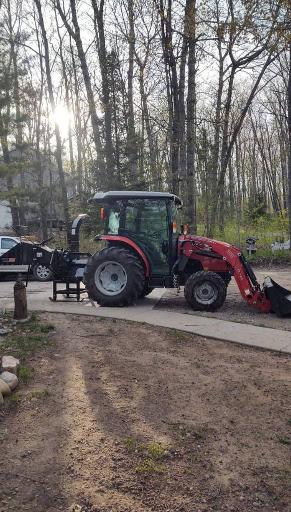

I bought a lightly used woodmaxx wm8m and its been fantastic. I wouldn't trade power feed for gravity feed any day of the week. I've run it on a nh 1620 and a massey 1740m. Obviously the massey runs it better with another 13hp, but it was still very usable on the 1620 for things that weren't firewood size. As others have said, the bigger the throat is, the less trimming you have to do when feeding it. I'd absolutely love a 12"x12" opening chipper even if it "only" could handle a 4-5" branch by hp limit.
