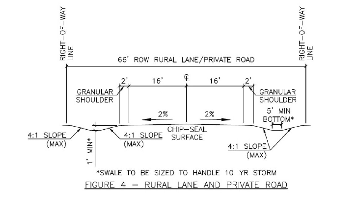

Another thought is drainage. Tend to any drainage issue that may be contributing to exasperating the water collection problem. You may need to divert or drain water from the problem area.
   / wood pallets under gravel driveway? #12
Mushroom man?, those may be kinda cool. so does the geo fabric keep it from pushing through the mud? I may do that. Thanks for all the comments!
Yes it keeps the stone on top of the clay. You probably should have a word with a local dirt guy (contractor), he'll know the local soils and how to handle your situation better than internet solutions. For instance the depth of cut for the right depth of stone on top of the type and behavior of your clay. It's not exactly just rolling out a layer of fabric and dumping on 6" of crushed stone on top.... but it can be.

You want a fairly uniform surface and material under the fabric/netting material, as free from organic material as possible, place the fabric, then some of them are made to basically create pockets of gravel, others, you just spread whatever locally used road base on top of.
Basically, you don't want plastic (gumbo clay/fat clay) or organics below the road bed. Either will pump when wet, but with organics, you also are dealing with long term deterioration of the material, that also leads to settlement. This goes for any type of roadway. Water makes everything worse.
In principle, to create a good road bed, you first cut the ditches, rolling good material up on to the road bed, then box it out, and place your base. So, by default that creates a road bed approx 6"-12" higher then the virgin ground was, and also gives an area to contain/channel water. If the subgrade (soil below your base material) is suspect, and the ditch/scale Hold water, that is also a problem, as the water will get to the subgrade from the side ditch, and cause problems over the coming years.
   / wood pallets under gravel driveway? #14
For unpaved road surface, around a 6% cross slope or crown (depending on what the area is doing) helps clear what from the road bed. Here's a random cross section from google.

This is basically in front of my shop in the back yard so it doesn't really have much drainage. However, including the diagram you sent, I have another project on old logging roads on our mountain property where that road drainage will be really helpful. Not going to start that till the spring. Thanks for looking that up!
