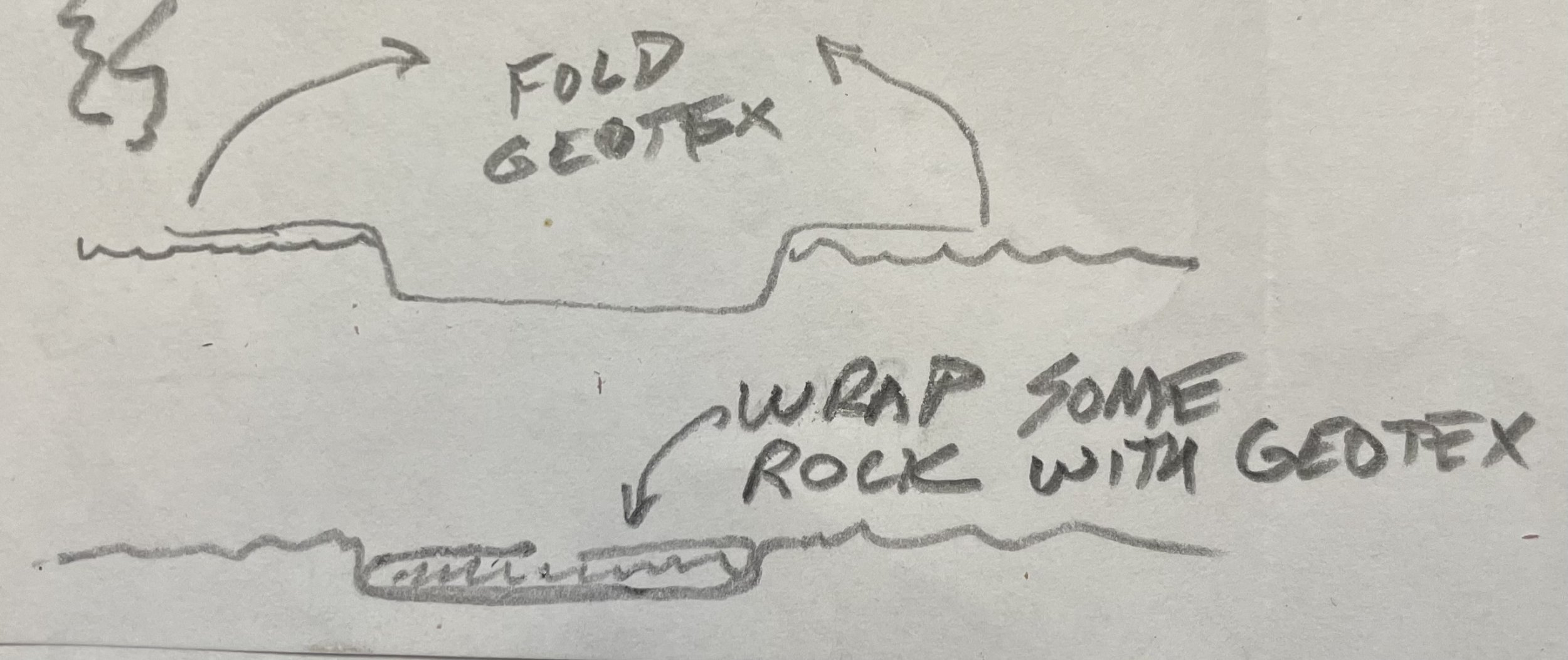

Don’t use wood. It will become “compost”. It turns into “nothing” a void. Make this subgrade structure with geotextile and rock. Second choice is geotextile & soil (which is probably already onsite! Maybe it has some gravel in it.
The geotex and the rock will let water pass thru, its better. But getting the rock there can be a hassle. Soil may work if it hardens, but has the risk of capturing the surface water. You’d want to time this project just before summer, if using soil.
The burrito will “harden” and it will spread the load, and if the area doesn’t pump, it won’t sink. Don’t use blue tarp, it breaks down too; get geotextile fabric made for burial, it’s structural. Used carpet could work too but can be hard to find at the moment you need it. This will work and its easy.

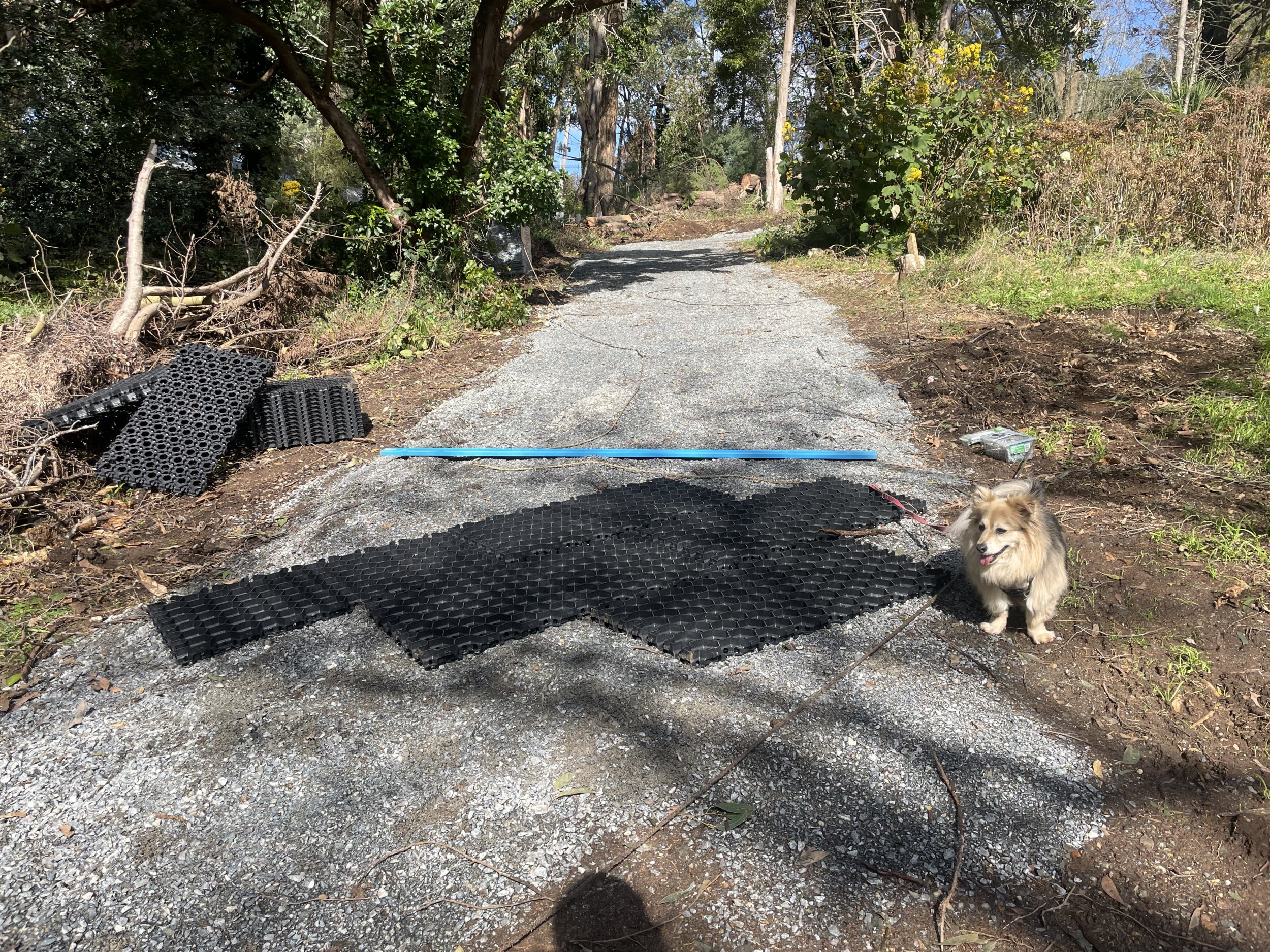

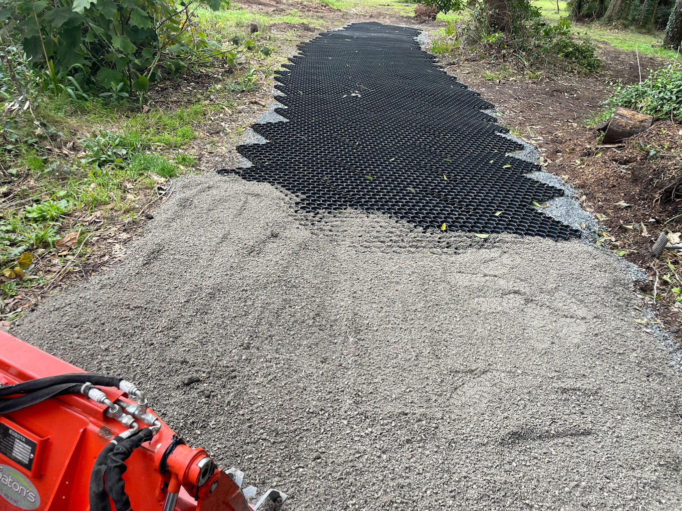

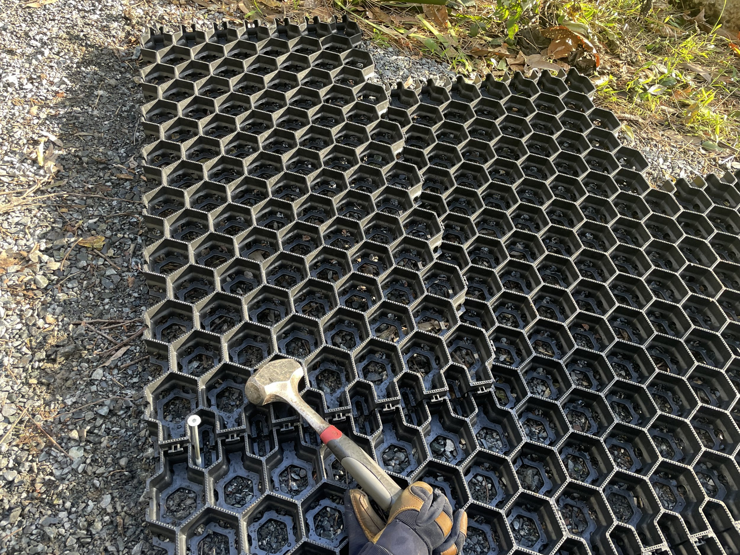

We have this clay here and a 15 deg slope.
- box bladed subsurface clean
- laid weed mat fabric on clay with pins
- a layer of crushed rock with fines
- compacted
- geohex panels with pins
- finished with ‘toppings’ crushed rock
Expensive but I’ll only cry once
