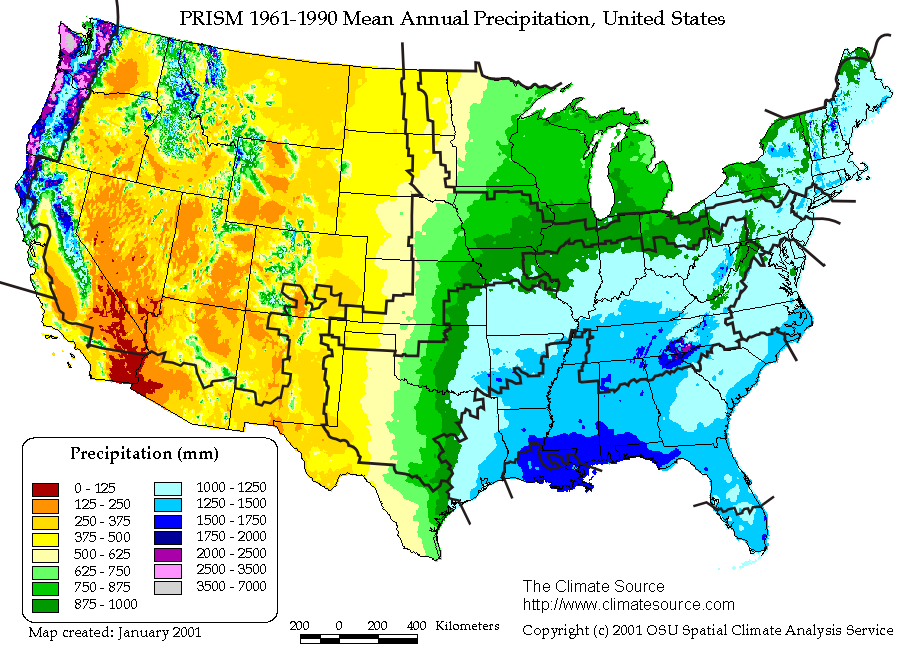

#1 item is drainage, get the water away from the road. If I have really soggy areas, and I do, I use road fabric under 1 1/4- followed by 5/8-. I would give anything to live in a green area but alas, I live in a light pink area of the below map. We know water... :)
