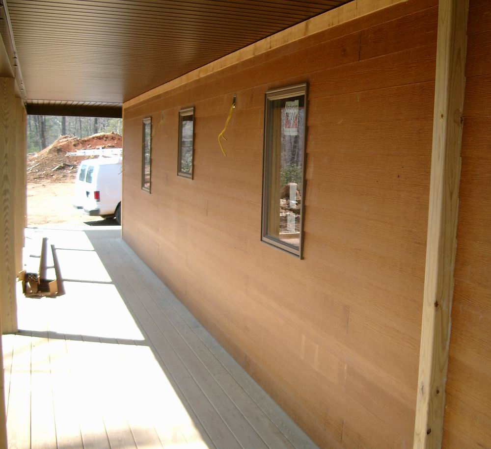

I know you said you weren't interested in Cement siding, but there are some things to think about. Do you have wood boring bees in the area where you are going to build ? The boring bees don't (can't) get into Hardy Plank Siding. Siding8.JPG This is the Pre Stained Hardy Plank in Cedar Stain with 50 year warranty - Most of ours is under wrap around porch - no bees in our siding !
/ Wood Siding Recomendations #12
I know you said you weren't interested in Cement siding, but there are some things to think about. Do you have wood boring bees in the area where you are going to build ? The boring bees don't (can't) get into Hardy Plank Siding. View attachment 404049 This is the Pre Stained Hardy Plank in Cedar Stain with 50 year warranty - Most of ours is under wrap around porch - no bees in our siding !
That is really nice looking stuff there!

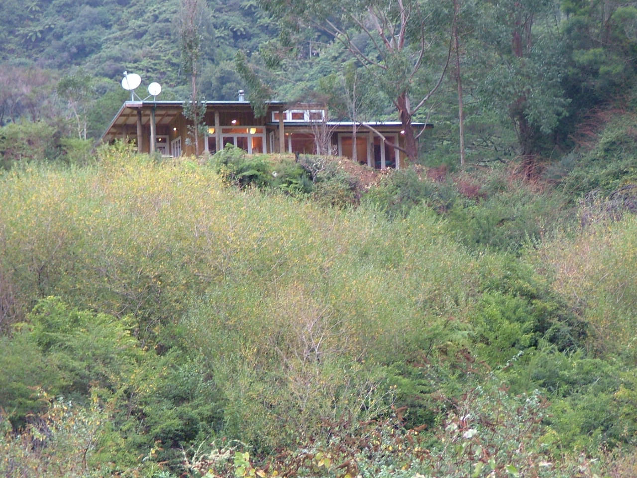

My next house is going to be clad in Thermowood (Lämpöpuuyhdistys ry)
A chemical free process to modify timber to make it more durable and resistant to swelling and shrinkage with moisture changes It is Finish (Finland) technology that we use in New Zealand to turn Pine into a more durable and stable timber at least as good as cedar for a lower price than Cedar. There are some mills in the states with the Finish “Thermowood” technology and others with a similar system Google Thermally modified timber
Below a couple of photos of the last house not “Thermowood” built before I got the Finish Modification chamber so using chemically treated (copper chrome arsenic) pine
