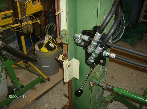

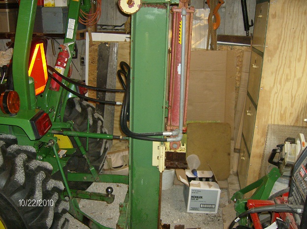

Got the splitter plumbed today, $23 from JD for the male couplers, $70 for two 3/8" x 8' hoses & $95 for a control valve, plus assorted pipe fittings. Don't have anything home right now to test it, but it works fine w/o load!
Just went to the bucket cylinder connections, won't be using the bucket & splitter at the same time anyway! Tarp strap the joystick to the fender & go to work! ~~ grnspot110

Looks good EXCEPT for that galvanized water pipe:eek: That stuff-especially the fittings are only rated for like 300 PSI.

Hasn't been that long ago some machinery companies used galvanized pipe & fittings for implements Glenco for one! ~~ grnspot110
