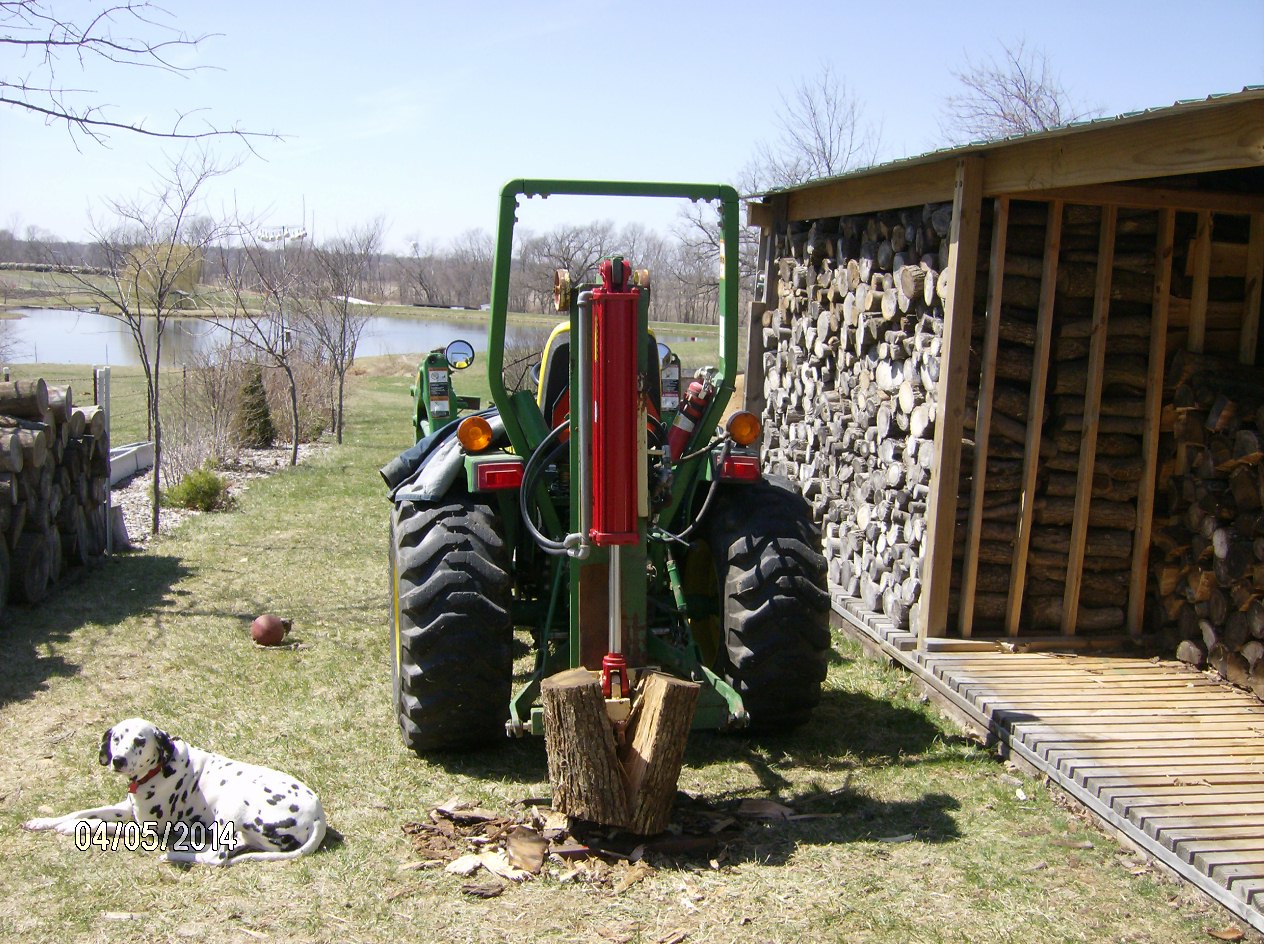

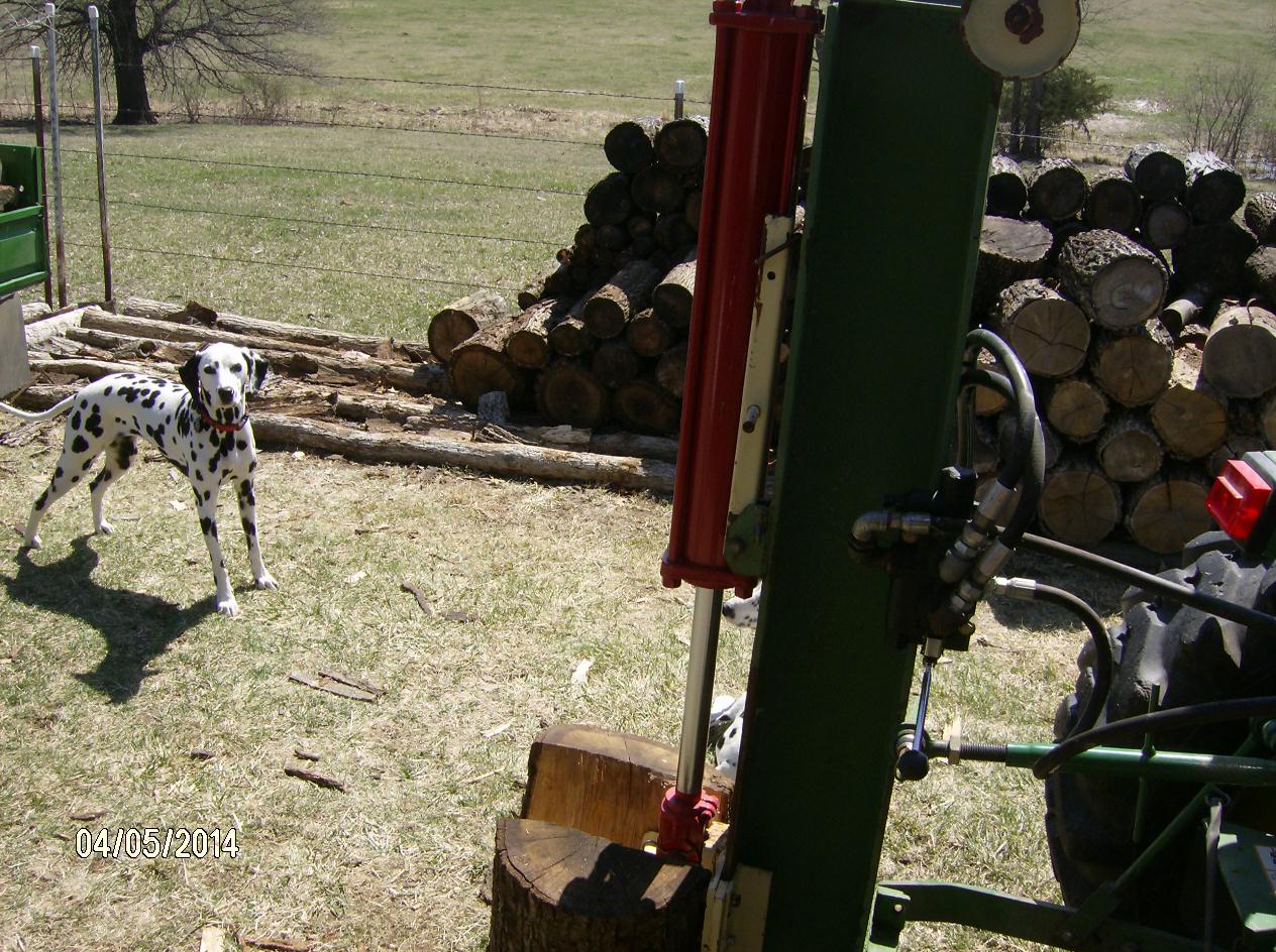

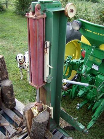

It all depends on your needs! I have a 3-pt splitter that I made for a 1958 JD 520, using the tractor hydraulics: Picture 264 (Small).jpg

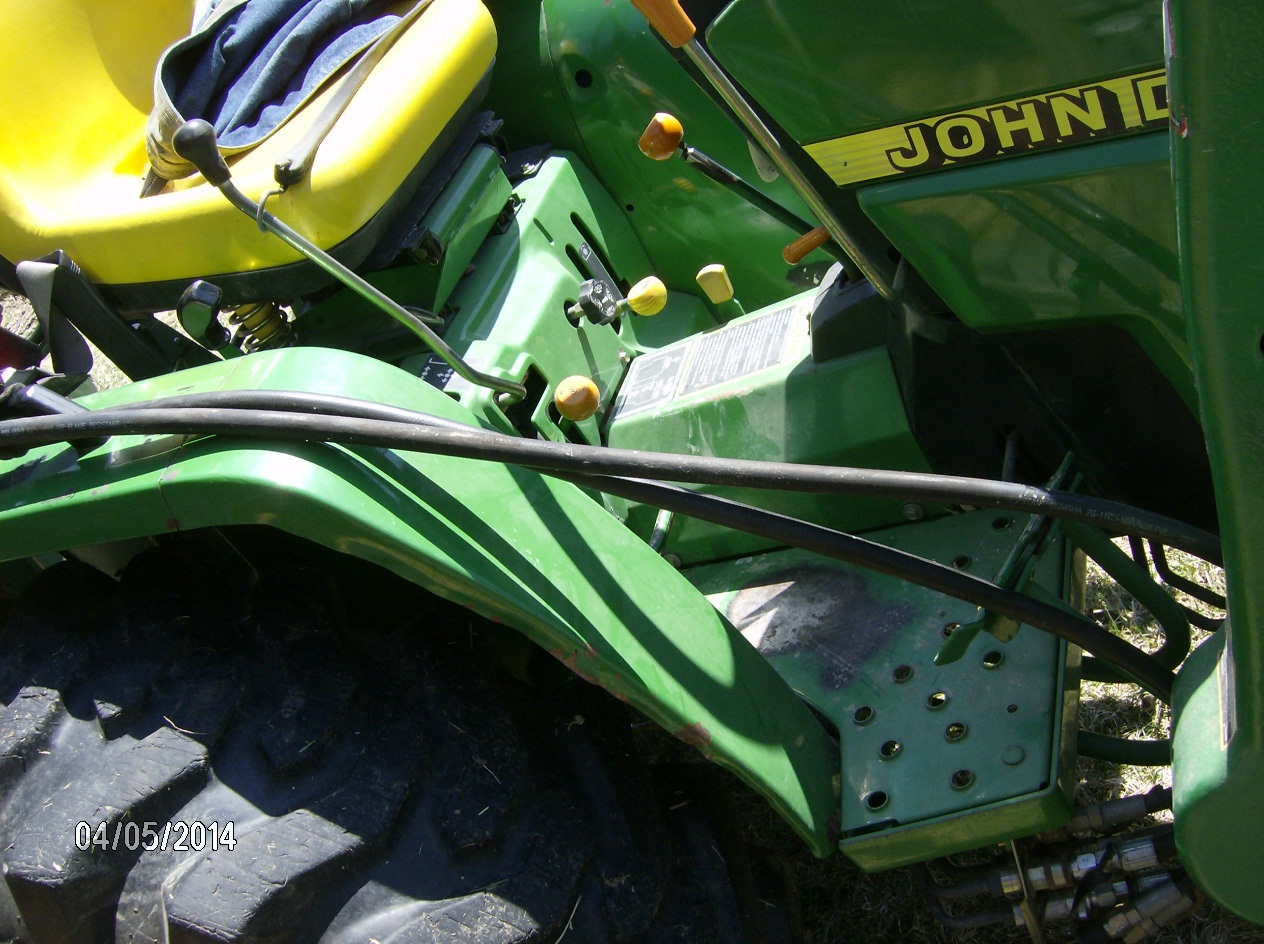

When I sold the 520 & bought my '04-790 I had to add a splitter valve & long hoses to reach the loader bucket connections. I tie the joy-stick off to the opposite fender with a tarp strap & use the splitter valve. HPIM3027.JPG HPIM3028.JPG
I bring my wood home from the farm & stack it along the fence about 20' from the woodshed. When I get ready to split, I just park the tractor between & go to work, HPIM3026.JPG No, it's not fast, but I work alone & it keeps up with me just fine! As for putting hours on the tractor, I put around 100 hours/year on the 790, another 5 or so/year isn't going to wear it out!
The splitter originally cost me $250 to build with a new cylinder & used iron, the new valve & hoses doubled that. So I now have a whopping $500 invested in it with several years of use!
