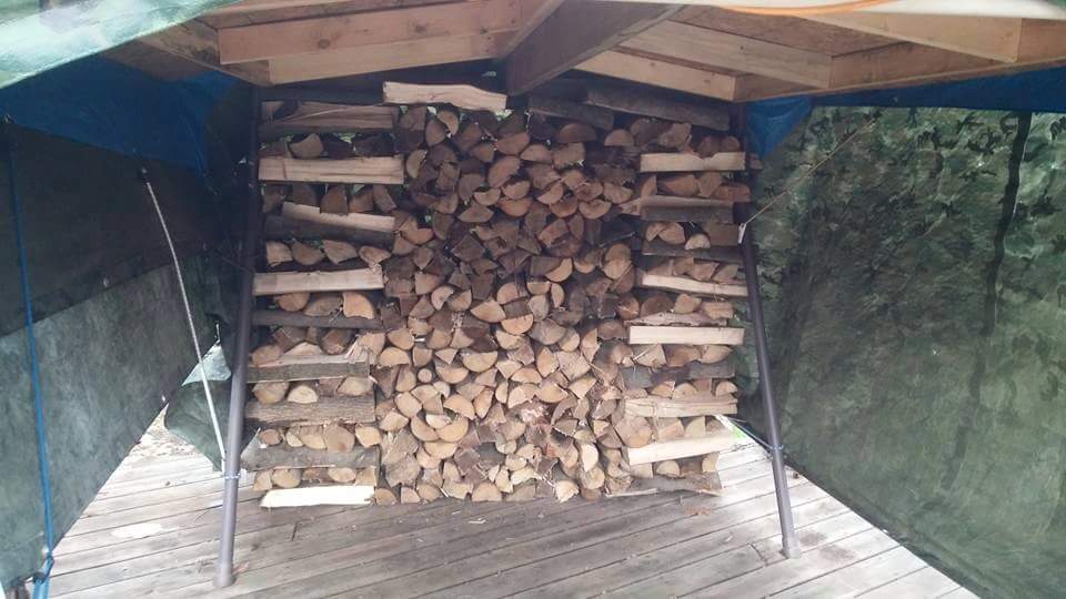

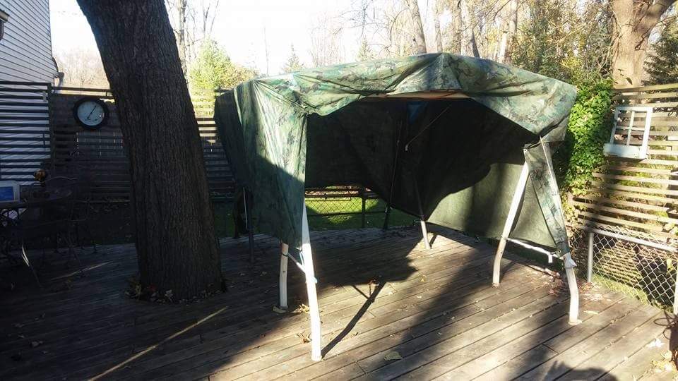

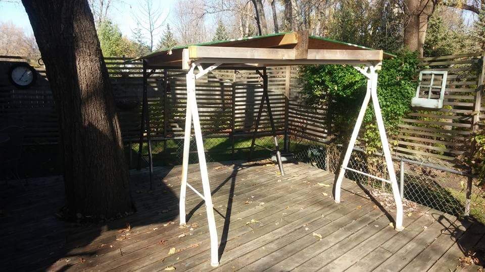

This is what I did for this winter. It sits on the deck, outside the door.
I used a couple of garden swing A-frames. One, I already had and the other I got on Craig's List for $20.
I hammered together the roof using a salvaged 2x12 for the ridge board, some 2x4s and a couple of sheets of leftover OSB. Then I covered it with a Harbor Freight tarp.
I have a ramp to the deck and have been wheelbarrowing the wood up there for the past 15 years. Until this year I left it uncovered, digging it out of the snow all winter. Now that I'm old it's time to do things differently, so I am covering and using a recently purchased Mahindra 26xl.
The intent is to have something that can be dismantled and moved once the season is over.
Not sure how I'll cover for next winter, but I will be using the loader to fill the deck from the side. I need to redesign the trellis so it can be folded or moved.

View attachment 459146View attachment 459147View attachment 459148

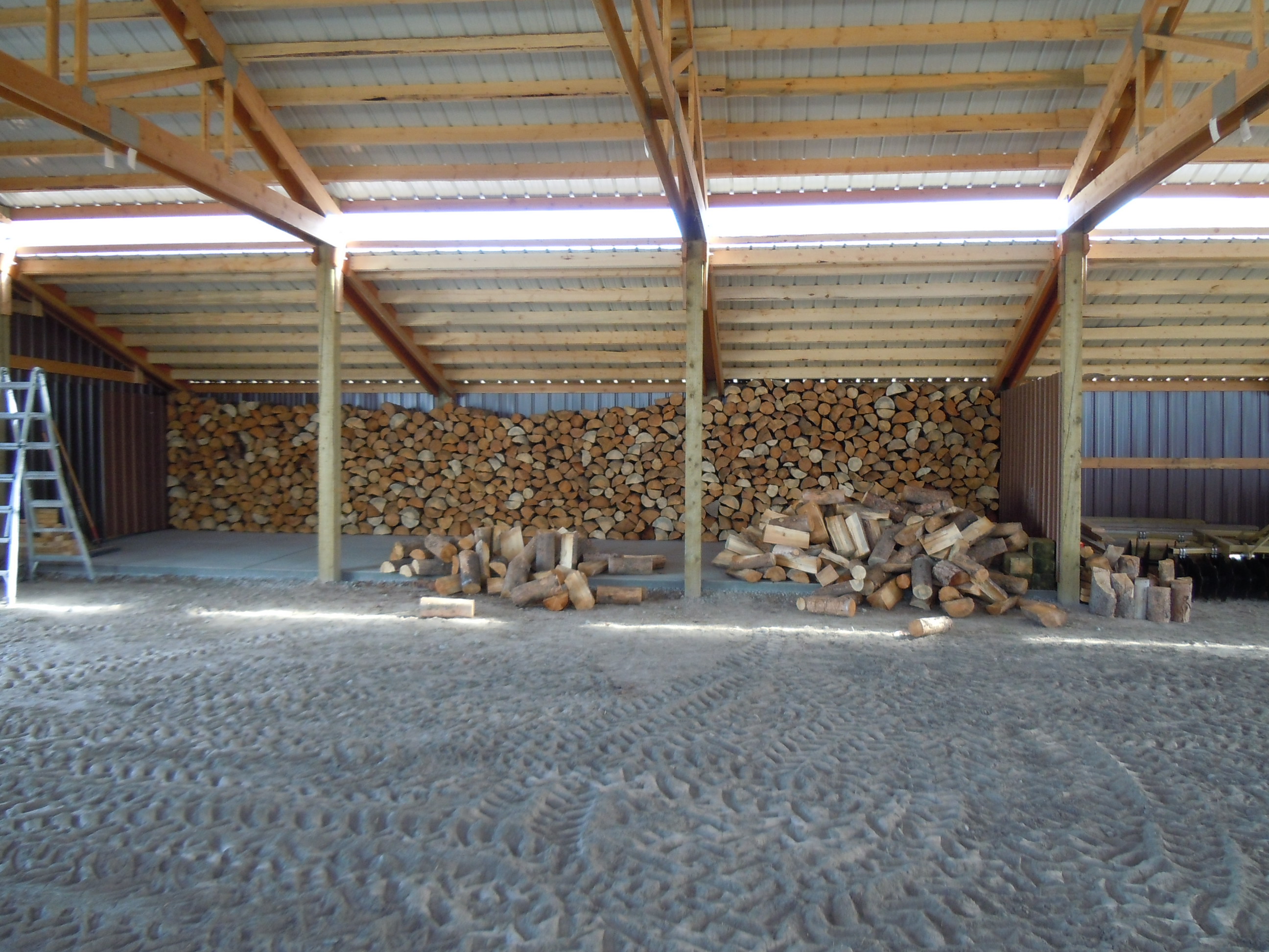

To the original post;
If you are going to stay in your home many more years, build a wood shed. It's one time and you'll be happy not to mess with a tarp anymore.
DSCN1916.JPG This was my old wood shed.
DSCN2320.JPG I built a new barn (where the old wood shed was) and made it big enough to have a bigger wood storage area. I smile every time I load the tractor bucket up.
