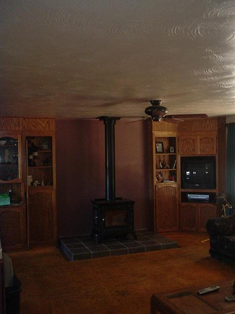

Started up our new wood stove for the first time this weekend. I've been so impressed with the BTU's it puts out. We've not had the furnace kick on all weekend so we're pretty relieved about that (considering we just had the tank filled at $2.15/ gal.:()
Anyway, I'm getting conflicting ideas on how I should best circulate the air with the ceiling fan. Some folks have said that I should have the fan running in such a way that it draws the cooler air on the groud up and mixes it with the warm air that rises. Then again, I've been told that it should be set so that it pushes the warm air that rises, down to the floor.
Thoughts?

We have forced hot water baseboard heat in our 3000 sq.ft. colonial and having the ceiling fan on so that it pulls the heat up really circulates the heat more efficiently in the winter. I have the fans blow the air down to the floor in the summer months because it tends to spread the A/C better.
Here is a little diagram to explain what I mean:
This is from a ceiling fan manufacturers website, Signature Lighting
with a little explanation: " The third pull chain is for Forward/Reverse. This setting would usually be changed once per year .Downdraft for summer to create a wind chill to give a cooling effect. An Updraft in winter to circulate the hot stratified air off the ceiling and back down to the floor without creating a wind chill."

Ceiling fan on low blowing towards the ceiling as described above. Otherwise it blows cold air down on you while starting the fire on a cold morning. Really you just need to keep the room from stratifying into hot on top and cold on bottom so it doesn't really matter until you consider the wind chill effects of downward blowers.
I tried both ways. I run my energy star fan on low (6 watts) continuously through the winter.

The warmest way is with the fan in reverse or blowing up. It will circulate the warm air accumulated at the ceiling to go down gently near the walls. If the fan is blowing down the effect is cooler because of the breeze.
