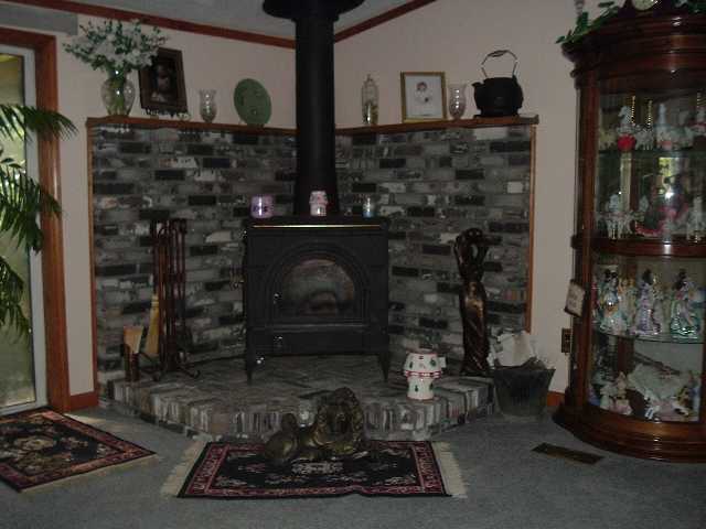

We've been using this one for about eight years and really like it, has a blower and a catalytic combuster that makes it really effecient. It took a while to learn how to fire it, but has been really frugal with the use of wood, only had to replace the door gaskets, it's the Consolidated Dutchwest Extra Large, and it weighs about 400 lbs.

I didn't realize there were so many nice wood stoves out there until I started seriously looking. Thanks for the pictures, lots of good information...
Howard

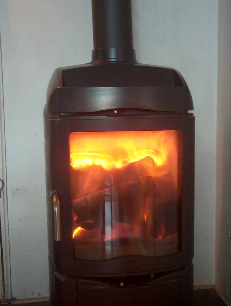

I have a modern "Jotul" It gives a lot of heat, looks good, and burns effective and clean, and I dont like it! Why? The glass door is too big, when i open it, ashes fall on the floor and smoke pours out into the livingroom, making it smelly and dirty. It is like the old Garand rifle, it must be emty before you can reload. I would prefer the old type with a small door that you could open, even if it is burning at "full speed".
Auto Union, I note that yours have 2 doors, does that work well?

</font><font color="blue" class="small">( I have a modern "Jotul" It gives a lot of heat, looks good, and burns effective and clean, and I dont like it! Why? The glass door is too big, when i open it, ashes fall on the floor and smoke pours out into the livingroom, making it smelly and dirty. It is like the old Garand rifle, it must be emty before you can reload. I would prefer the old type with a small door that you could open, even if it is burning at "full speed".
Wow, that is a big window. Great for viewing the fire, but I never thought how that could be a problem. I'll have to keep that in mind when I get a chance to run down to a dealer and buy one.

i use the same model AutoUnion references in this thread. i NEVER load wood from the front door; the side door is the one to use for loading. IMHO, the front door is only useful for viewing the flame (or for the wire mesh insert you can purhcase to replace the door unit).
does your Jotul NOT have a side door? incidently, my Jotul is new, and comes with both doors (front and side).
having used vermont castings stoves for years, i'm VERY PLEASED with the Jotul. i believe it's a better stove.

Jup Jup, if you open the front door too quickly you can draw out some ash & smoke. Generally cracking the front door then waiting just a second or two and then opening it slowly prevents this. Like Psuedofarmer I never load from the front either, I work the ashes a bit from the front but that’s about it.
