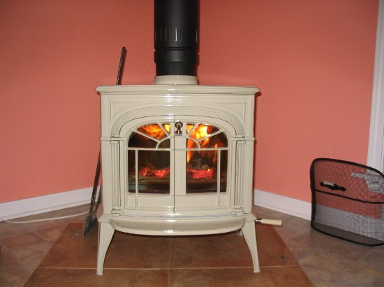

I've got to share my newly installed stove. It's a Vermont Castings Intrepid. It's the smallest of their stoves and rated to heat 500 sf. It's Installed in one extreme end of our ~2000 sf single story home. Although our climate is not the coldest, temps get into the lower 20's frequently at night. If we had a larger stove it would have to be choked down, thereby producing more creosote. This one will keep the house warm enough that the central heat will not come on if I get up one time and refuel it during the night.

geneP, nice stove. I looked on the web at some wood stoves from Vermont Castings. They carry some nice ones.

Thanks Howard. I've burned wood for heat for 33 years, with the exception of a short period before I got this stove. I used a fireplace, a wood heater (the type with a steel firebox inside a porcelain cabinet), a fireplace insert, and now the wood stove. By far the wood circulator used less wood and had a more even heat than any of the rest. The intake air was controled by a bi-metalic strip and would open and close the damper as needed. I could load it and forget it for about 10 hours. It did produce more creosote because it would simmer the fire when the room got warm.
