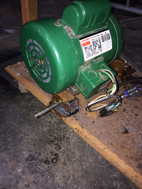

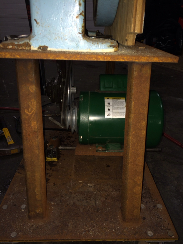

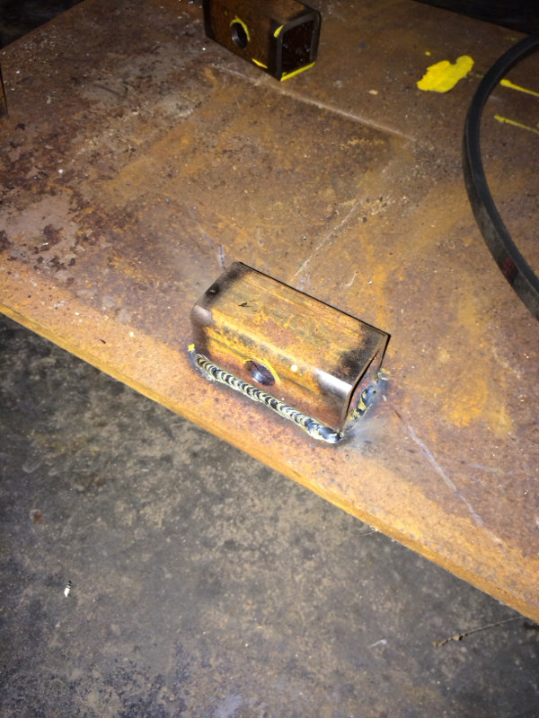

Did some more work on this saw tonight.
Fabricated a permanent mount that leaves me the option to use all 3 pulleys on the motor giving me the ability to still effectively use the saw for wood;eek when needed. Rigid mount made out of 1-1/2"x1/4" wall
Motor mounted
1-1/2"x1/4" wall square tubing drilled. Base plate drilled and tapped to accept 5/16" bolts with lock nuts.
