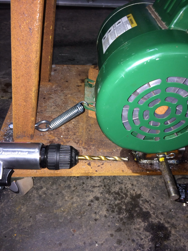

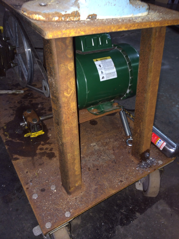

Added a simple tension system. An eye bolt with a 12.5lb spring. I still have room to add a second if needed.
