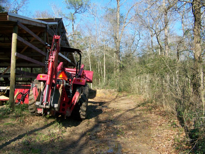

I need to build a temporary work platform for my FEL bucket to install barn siding on the back of my barn. I don't have but 20 feet to the fence behind the barn and cannot get my Mahindra 90 degrees off the barn's backside with the backhoe even turned to the side. You can check out the barn here if you want. http://www.tractorbynet.com/forums/projects/106272-my-pole-barn-solo-affair.html

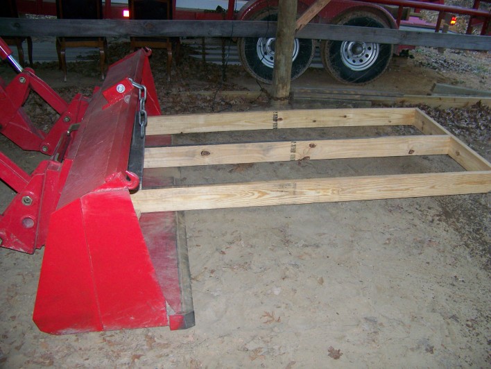

I will be placing the 4x4s in the bucket and adding 2x6s over that. I will support all this from the chain hooks and the receiver tube welded to the top of my bucket. The 4x4s will sit into the bottom of the bucket. I used the bucket on the front side of the barn and the 7 foot wide bucket was nice to work from. So my question....Can I build a platform that sticks out 7 feet that will hold me and the weight of the materials, only secured by the chain hooks that are about 2 feet above the bottom of the bucket and a support from the receiver tube?

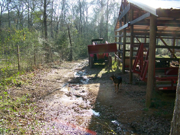

As the first attached photo shows, the ground is too uneven for scaffolding. Not to mention all the time calling to reserve it, pick it up, unload it, erect it, take it down, reload it, haul it back. Too much wasted time and the ground is too soft anyway.
The gooseneck is a lowboy. It would be major pain to move it back there anyway. As you can see in the photo, it is way wet back there.
The second photo shows the basic frame and the receiver tube with a check chain sticking out. It will have two chains supporting in and the back end wedged into the bucket with additional bracing. Oh yeah, it will have railing.
The third photo show the back of the barn from the other direction. Notice the tilt of my Mahindra and the fence row to the right.

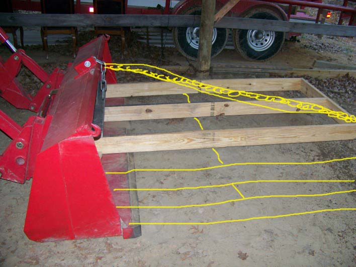

I took your picture and crudely added to it. Take a look.
Add 2x6's to make a larger platform. That way you can work from either side.
Run chain or a strap from the receiver hitch on the top of your bucket out to the end of the platform to hold it up. Can't see it but I'm sure you are blocking the end inside the bucket to hold it down.
For sure, no matter what you end up with, take Catman's advise and test it thoroughly.

Thanks for the suggestions! How do you draw on the photos?:confused: I have wanted to do that before.;) I won't need a full 7 foot wide platform, which is the width of the bucket. At first thought, I was going to do that. But I figured since I only have easy access from one direction, I will just make the platform on one side. It's the KISS principle.;) It will have chains supporting it, similar to the layout in the photo below. I won't be using the full length of the platform. I will put handrails at 5 or 6 feet. No need go out that far as I would have to get down the ladder and raise the bucket anyway, so I can just move it forward at the same time. I left it 8 feet long because I didn't want to cut the boards and plywood shorter. Don't worry, it will get tested before I use it:D .

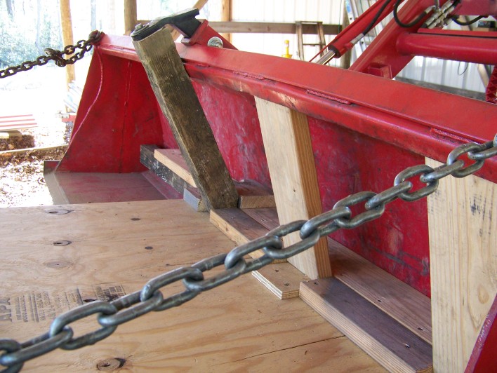

Brandi; You didn't acknowledge weldingisfun's statement about the blocking inside the bucket. I feel this is a critical safety item, that wood/platform must be held downward inside the bucket. Without this, the wood platform could cock/tilt IF you were to stand at other, outer edge of the platform(farthest from the bucket) even with the chains at both ends. You may already know this, but it deserves repeating.

Yes, I got detailed photos.:D I added a 4x4 attached with 1/2 inch lag bolts to the back slope of the bucket and blocked from there using 2x4s as spacers and stops for the blocking. One 2x8 and two 2x6s are jammed up under the bucket lip, along with a 4x4 knotch cut to fit good, attached to the ball mount on the receiver tube with a 1/2 inch lag bolts. Luke and I both jumped on the end of it and nothing happened. It creeks and groans only when I first pick it up off of the ground. It didn't creek or groan during the jumping. We had the tractor front end bouncing up and down like a low rider! :D The frame is 3 eight foot 2x6s under 3/4 inch.

It wouldn't work at all without the blocking. Thanks for the input.
