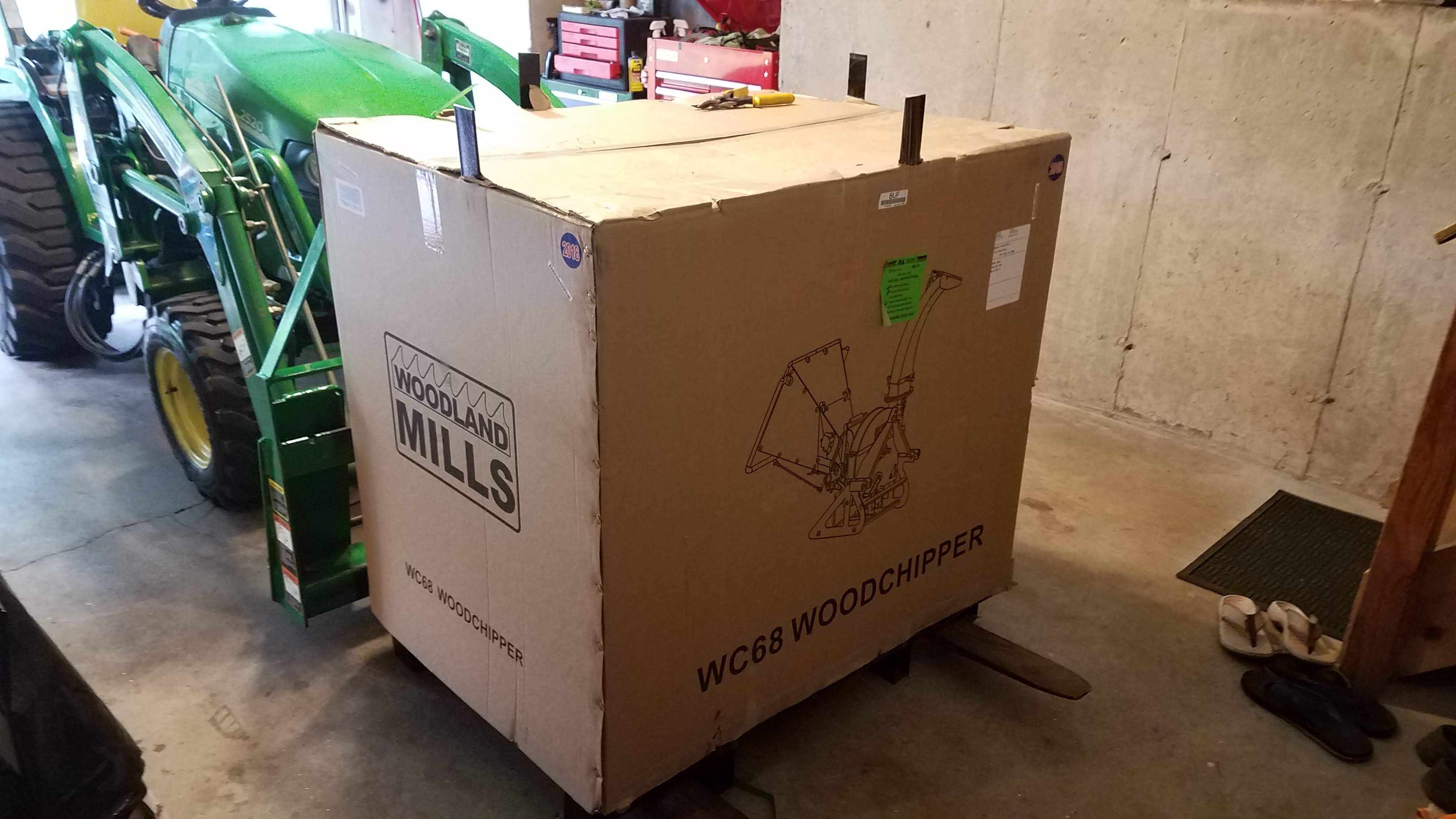

Finally arrived late today. RL Carriers with lift gate. It is heavy but 2520 handled it with no problem. Hope to get it going tomorrow

Mcastles, you're way ahead of me on WC68 work time :) I've had mine for about 3 weeks. It certainly works flawlessly - and a LOT faster than I can feed it. Yesterday I chipped one cubic yard of chips in less than an hour. I know it was 1 cuyd because I used the cardboard box that covered the chipper when shipped.
I put the box on a little m/c trailer, filled the box and and spread the chips in the garden. That system was a pretty good one-time event though. I had to tear up the box to get the chips out. I suppose a small dump trailer would be ideal, but I didn't see one sitting around in my tool area. Minor problem - I'll deal with that.

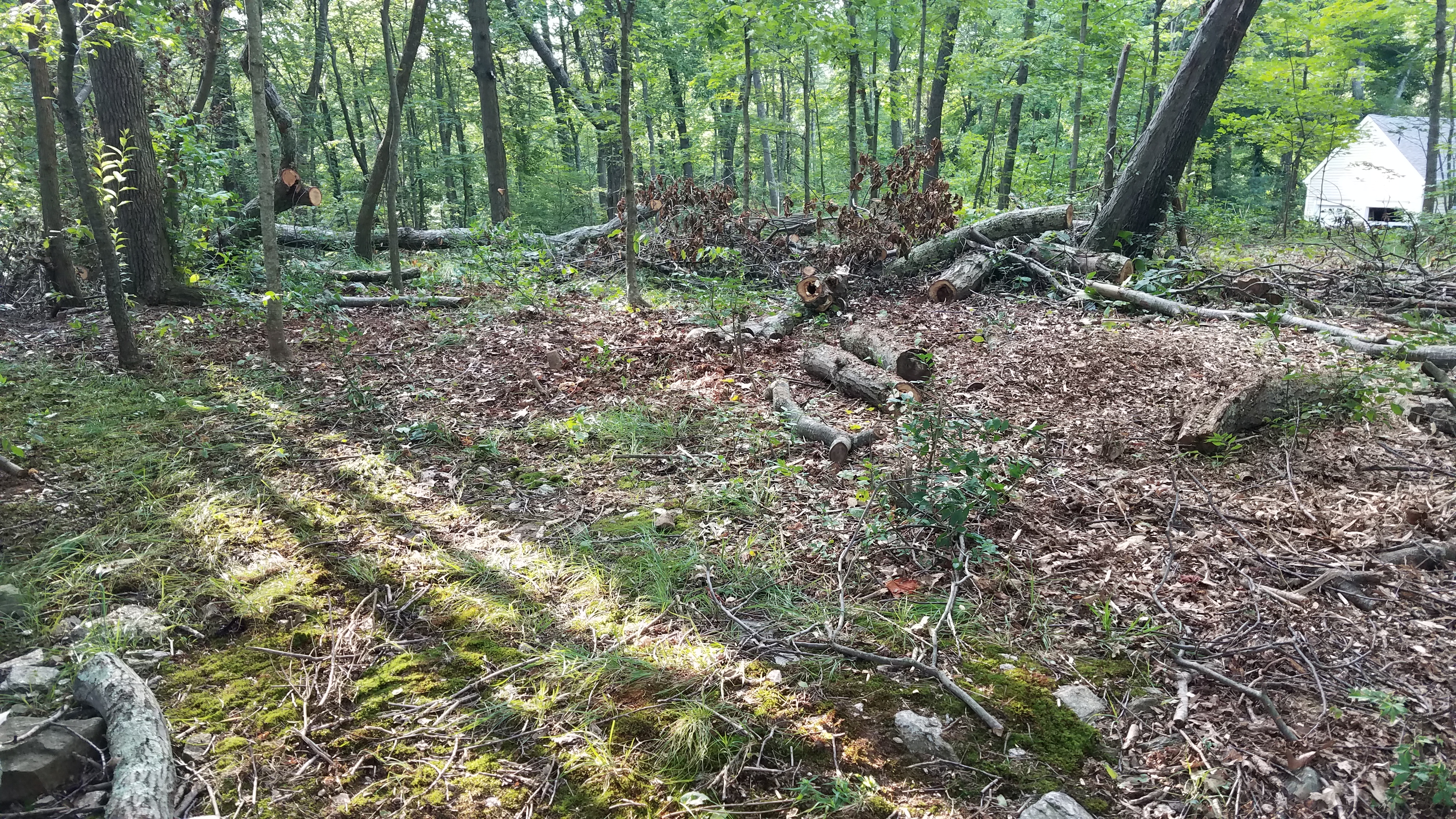

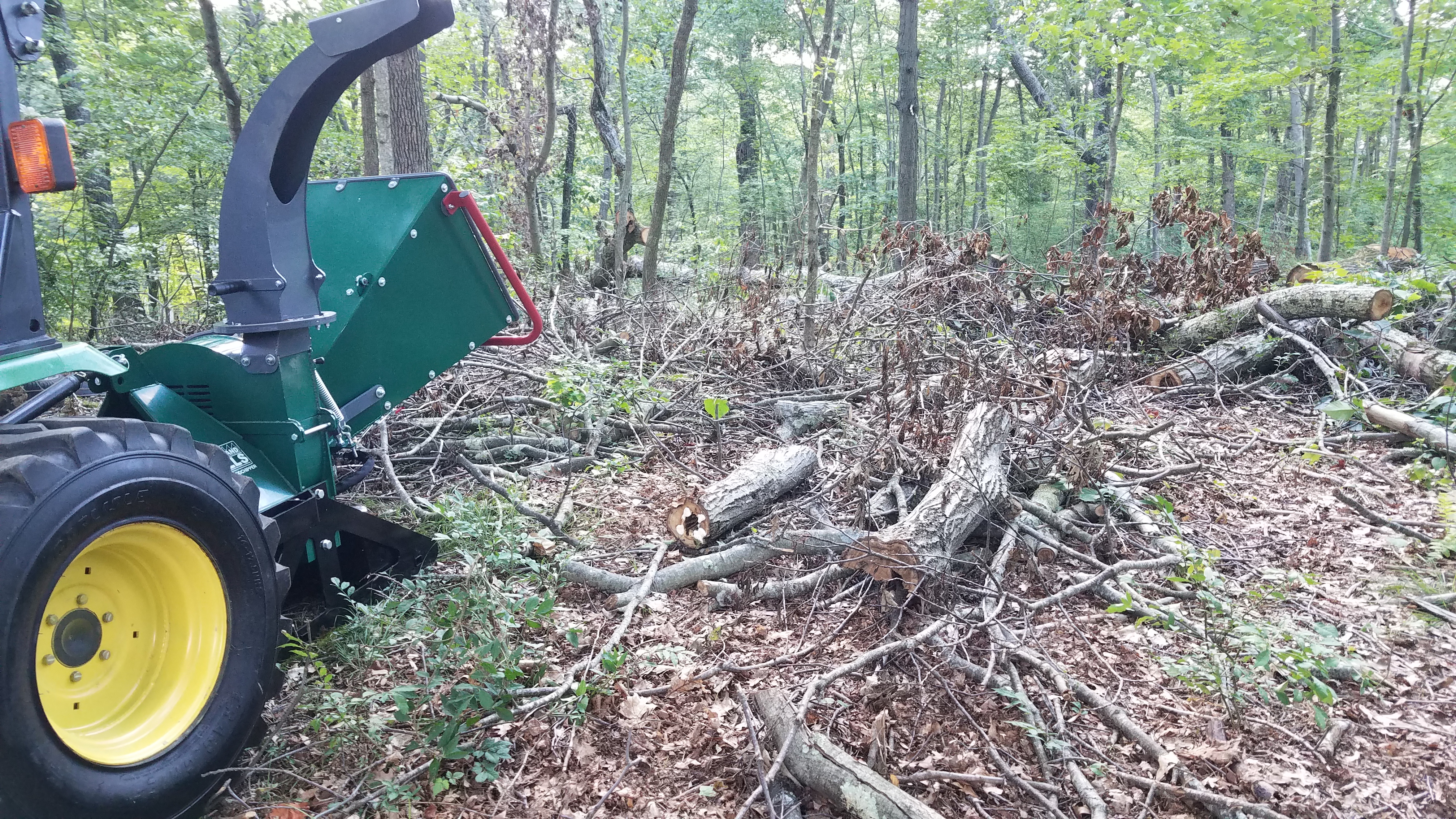

Well, logging time is not actually by design. Major storm cleanup after tornados came through CT back in May.
Great news on your results with a bigger tractor and about 30 hp. I would guess as you approach 40 hp, there is no stopping that chipper :). For those of us around 20 hp, just need to be a bit more patient and have the proper expectations. Very happy with it
See some before and after pics of storm cleanup. Still working on it

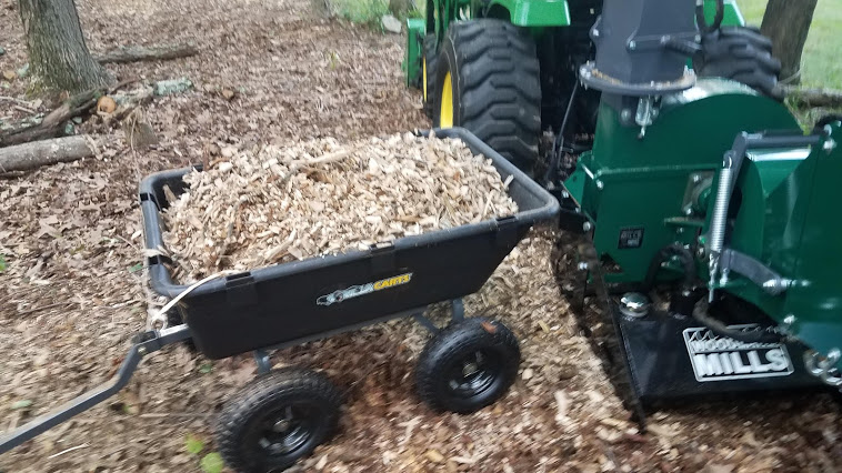

Certainly 35 hp would be great with the WC68, but as I described for me, it performs very well. Just have to understand the limitations and if I do upgrade to a larger tractor at some point, I am set. Plus the portability is great. I can put that chipper anywhere and go to work. Can't do that with a tow behind, plus renting just doesn't work for me. I work all day and then chip when I get home for an hour or so at a time. It is slow but can get a lot done that way if your patient.
I am sure the Woodmaxx is also very good, just wasn't willing to wait and I liked the full hydraulic feed. Delivered in 1 week from time of order. Can't beat it. There customer service is very good and willing to talk to you.
Here is pic for Gem99. Cart works very well
