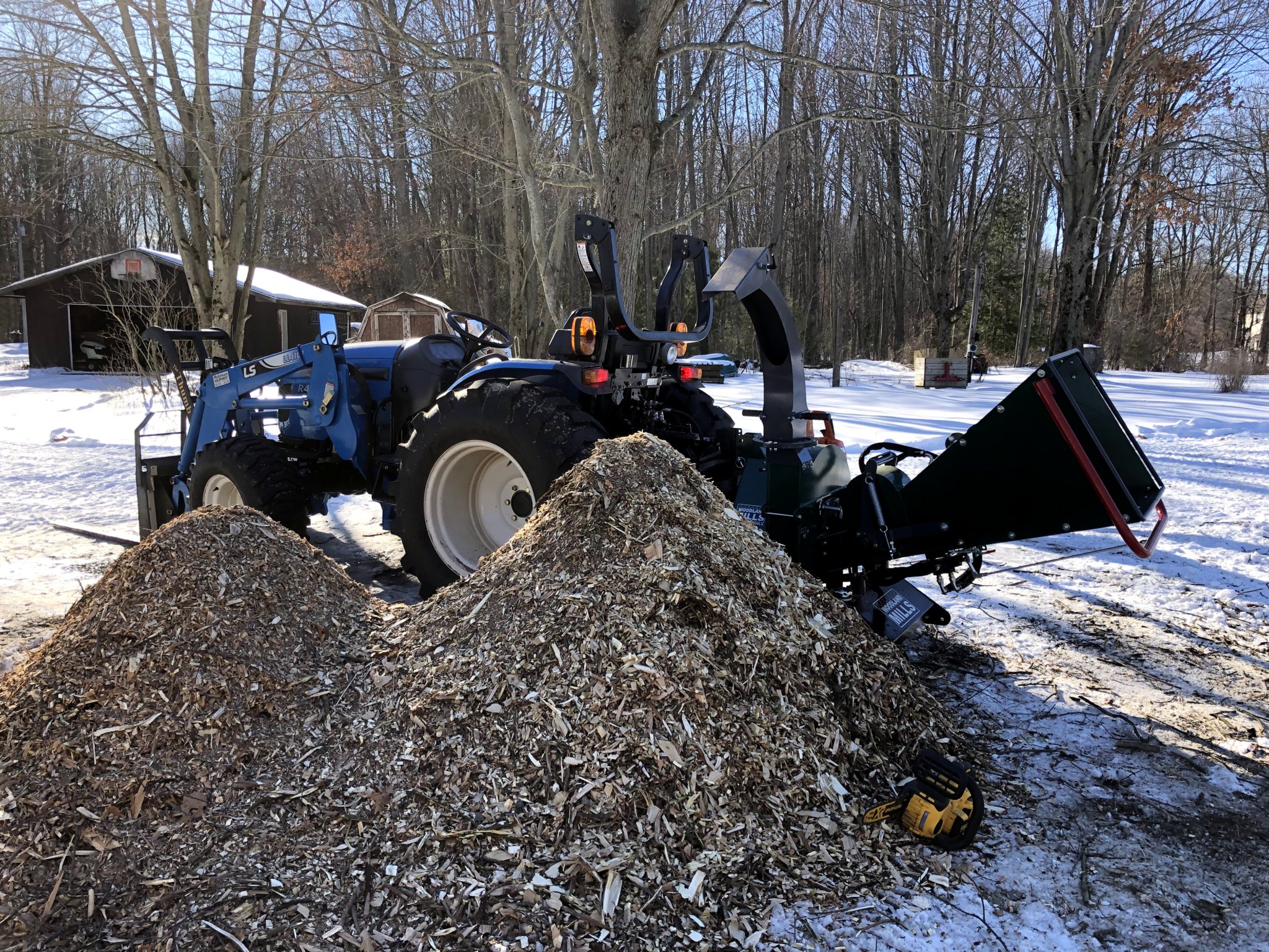

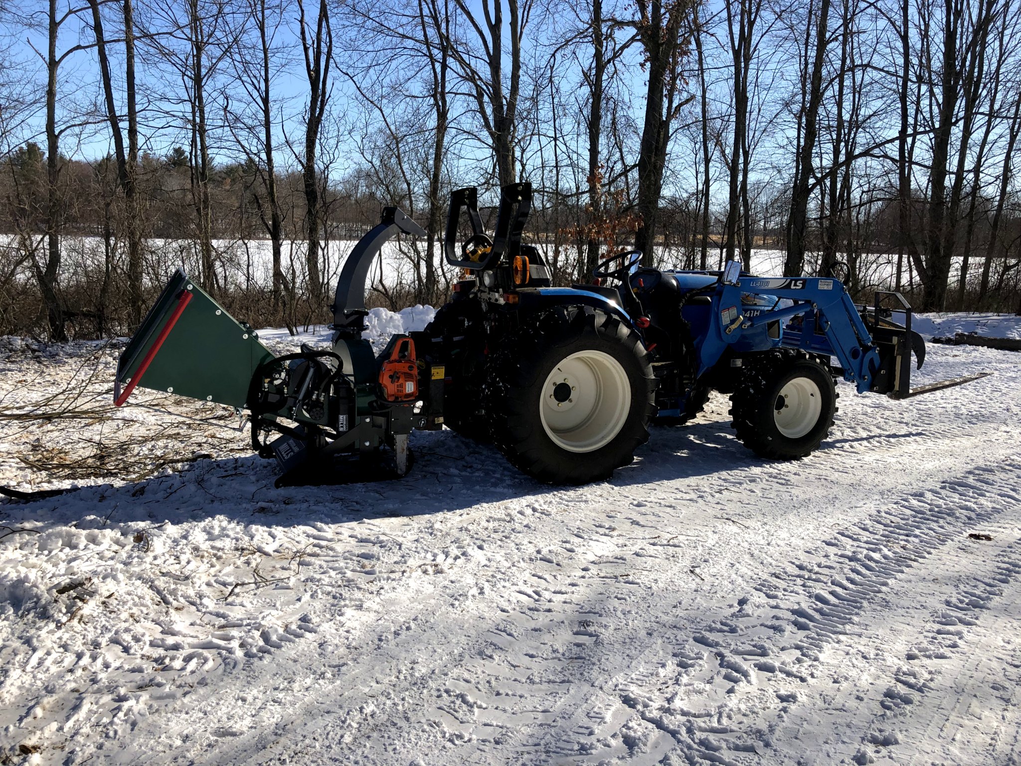

Chipped for about 6 hours the last 2 days, Plugged it up once and learned what I can and can't feed into it! Tightened the directional control valve a 1/4 turn because it was popping in to neutral too easily, worked much better today. Very happy with it so far!
PS: I bought the saw holder with it, the end of my 20" bar is about 2" above the ground. I wish I would have bought 2 of them so I could put my little Dewalt electric saw on the other side ($59. + $25. Freight) The saw holder is well built and adjustable, it has a rubber? pocket surrounding the bar. IMHO well worth the $59. If you order it with your chipper. (Free shipping!)
