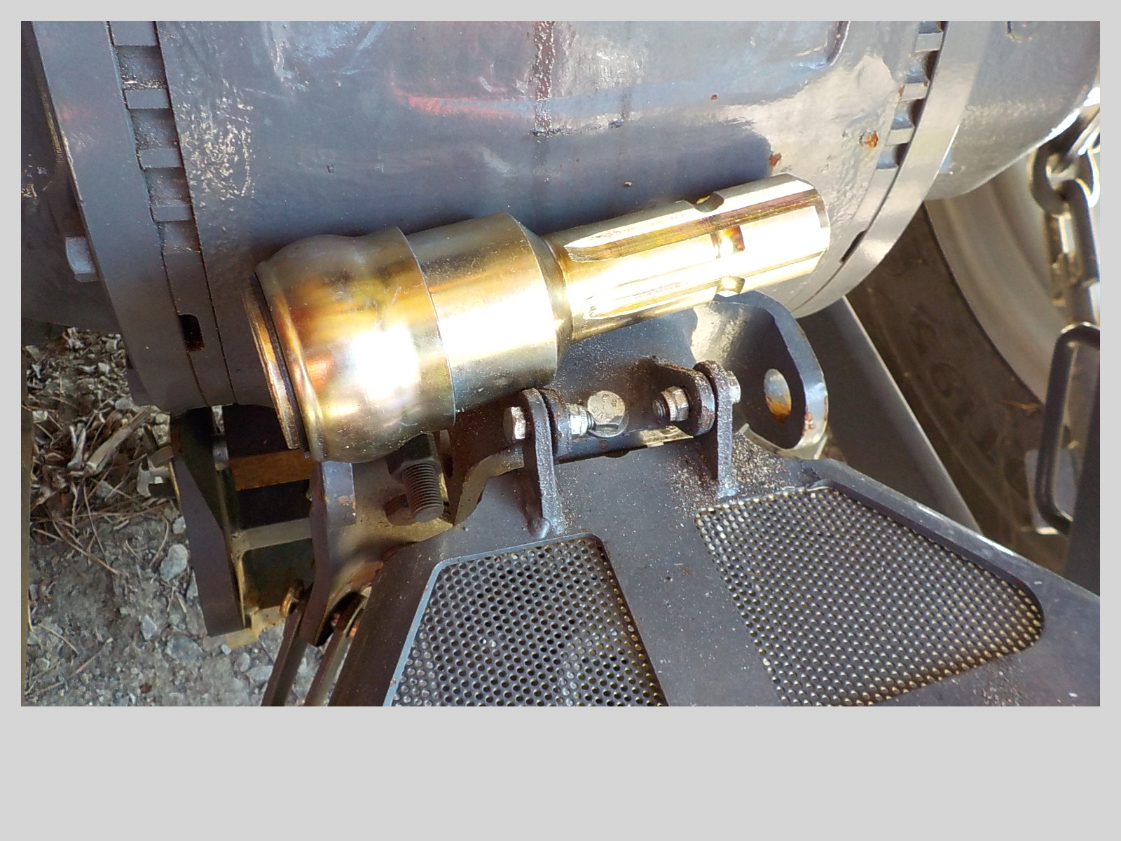

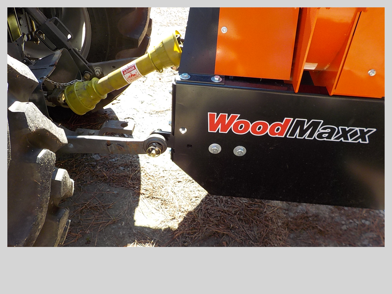

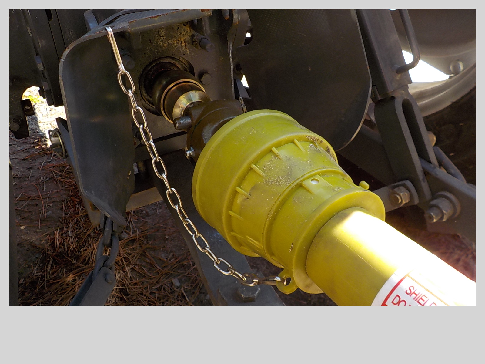

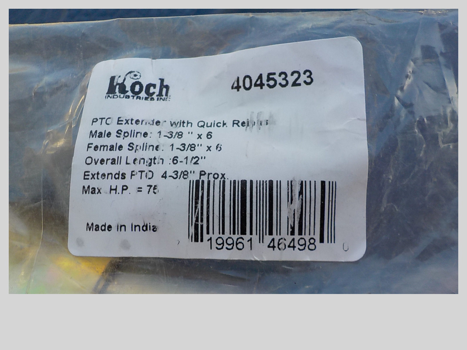

there were a number of pto shaft extenders available and the one that caught my eye looked heavier duty than the others, though it did have
a slip ring setup. It is very heavy duty, serious chunk of steel, went right on the shaft and the chipper hooked up perfectly, did not fall out when raised and still had a little
play when all the way down. I ran the chipper and it worked fine.
Then everything went downhill after I put the chipper away in its new prime spot in the shed. When I tried to hook
the Massey up to my Land Pride mower, the extension made the pto shaft too tight, actually too long now, so I'll just take off the adapter. Slid right of the tractor easy peasy. And then would not, despite my best efforts and getting utterly slimed in grease from head to toe come off the pto shaft. Stuck. Sigh. My strong fireman helper will just yank it apart tomorrow but a bit annoying. Never have a problem getting pto shafts off, but seem to be tortured trying to get them on. Someone needs to invent a Good Grips pto adapter...
Big tree down in the woods will be next project tacked with the chipper. The front woods look really nice now with all the junk cleaned up, like a shady glade.

   / Woodmax three point chipper #49
I use an extender for my chipper too. I remove it when I remove the chipper
Extenders are very handy when one needs them, but I also think they can be tough on the PTO stub shaft bearings. And, none of us want to collapse a PTO drive shaft to where it damages the PTO itself!
