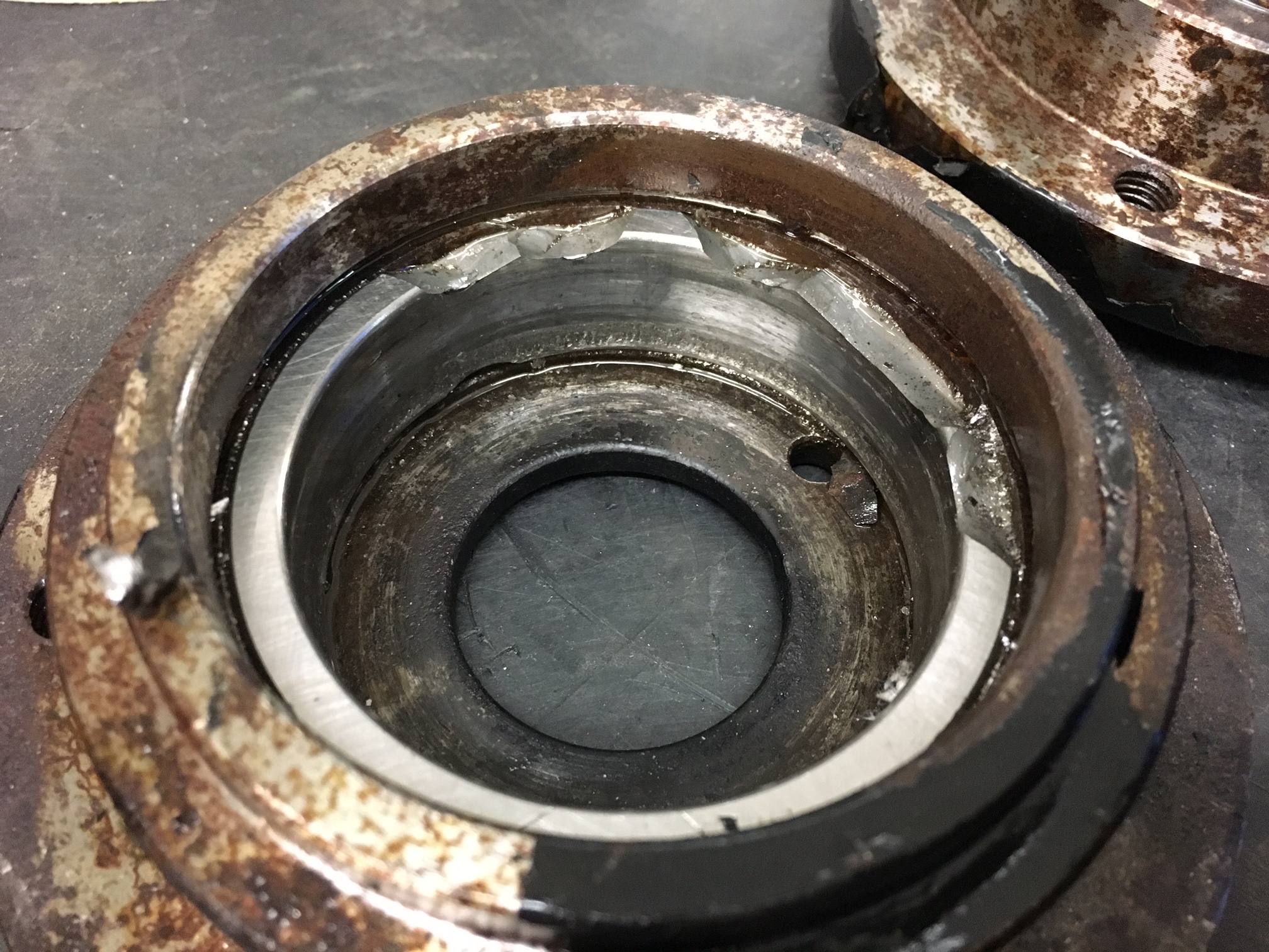

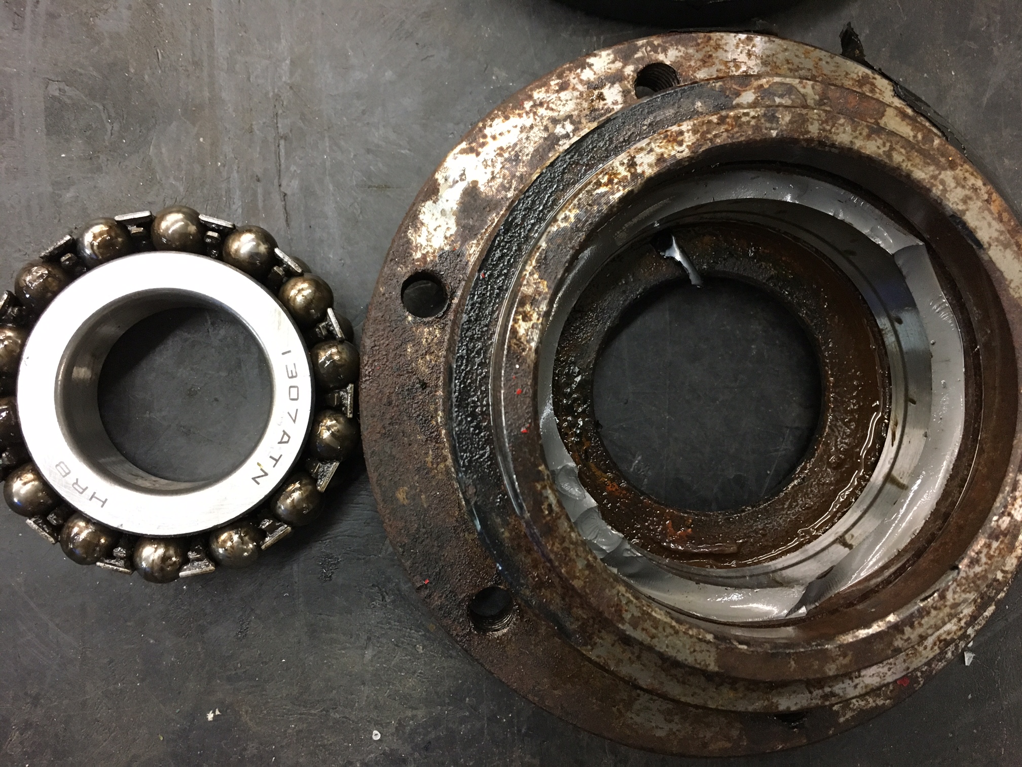

There is no way the damage I have is from over greasing - defective bearing from the start or improper assembly are my guesses for now until I have things further apart. Lack of lube is not the cause either. This unit does not sit outside - ever. So should not be a corrosion issue.

Hopefully the pictures work- Bearing housing with the bearing next to it is the drive side which was not seized yet, but didn't feel the greatest. Non-drive side is the other, should be able to see the nice groove in the race where the bearing failed. One thing you can't read on the bearing because of lighting is "CHINA"
Anyway, I've got two busted outer races to get out of the bearing housings, and one stuck inner race to get off the main rotor stub shaft - what fun ahead!

I am definitely sorry to see the trouble that those bearings have caused you. I would not install anything but a known bearing brand FAG, SKF, Sealmaster etc. to replace the pair and send the other bearing back to them with a no thanks I do not want them anywhere near my flail mower. Please purchase some dry ice to get the inner races out of the housings by shrinking them to save yourself a lot of work.
Or, if he has a welder, weld a bead around the inside of the outer race.
