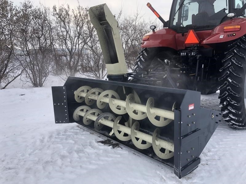

Notice this one on a big tractor.

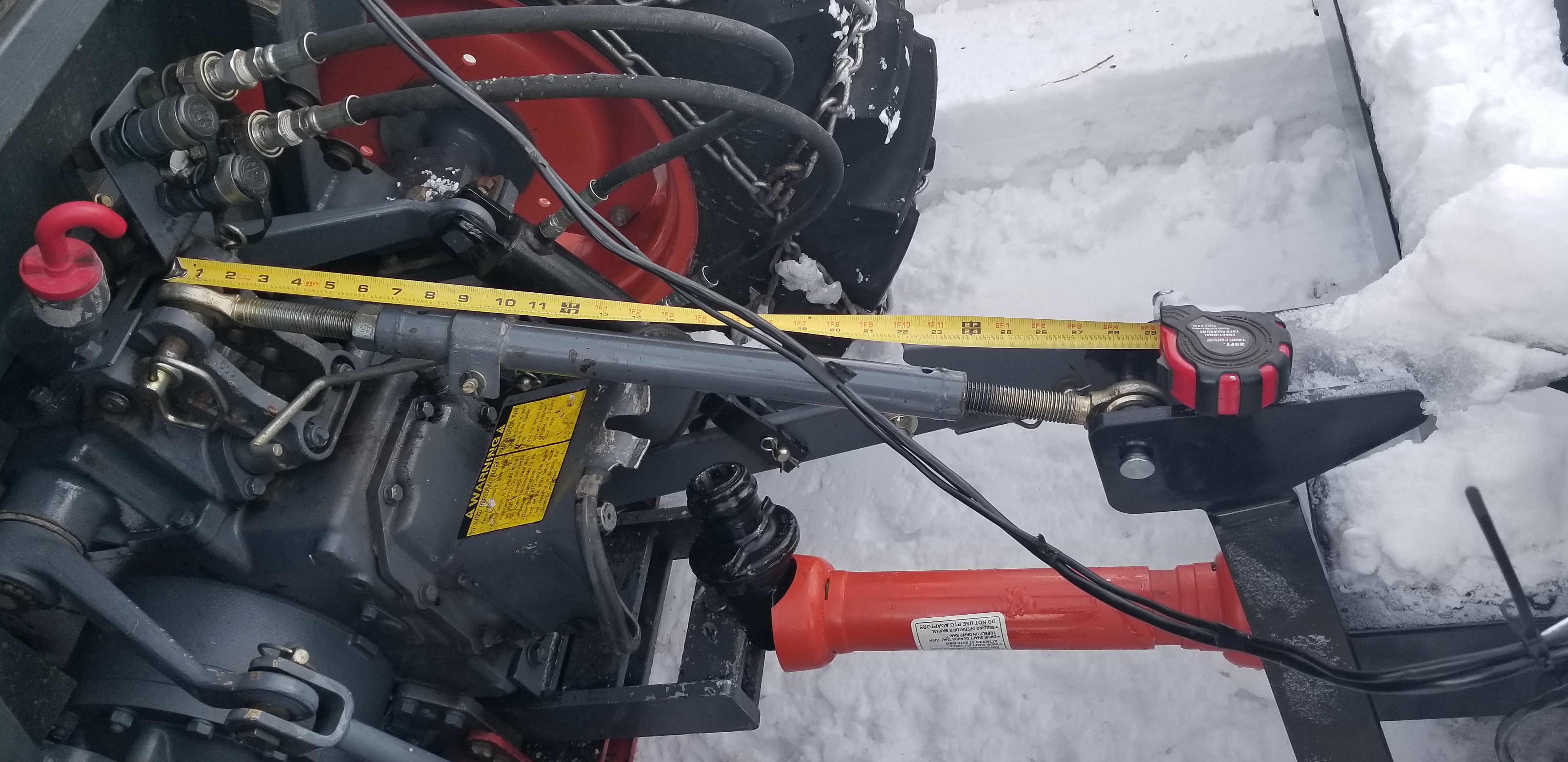

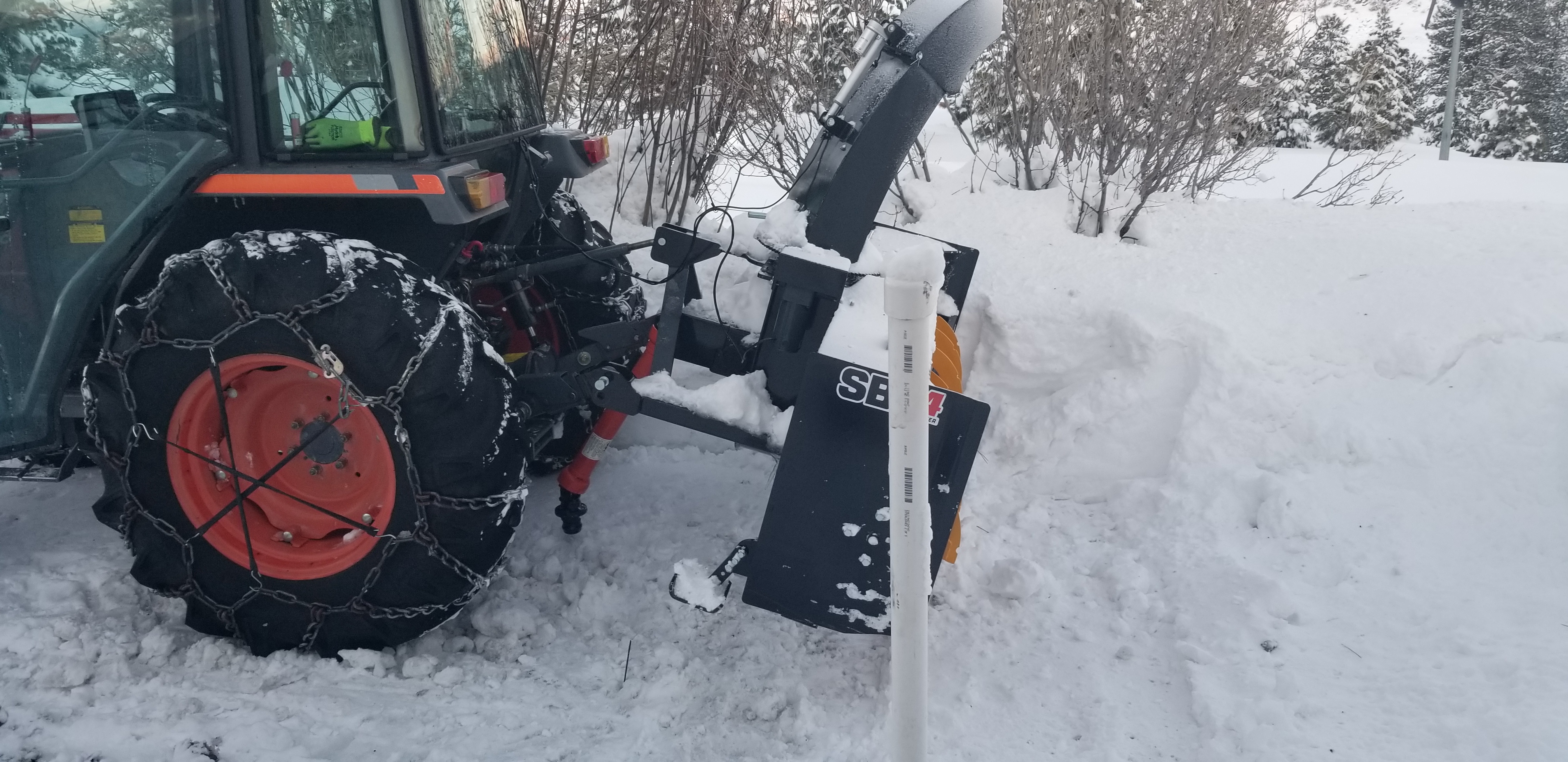

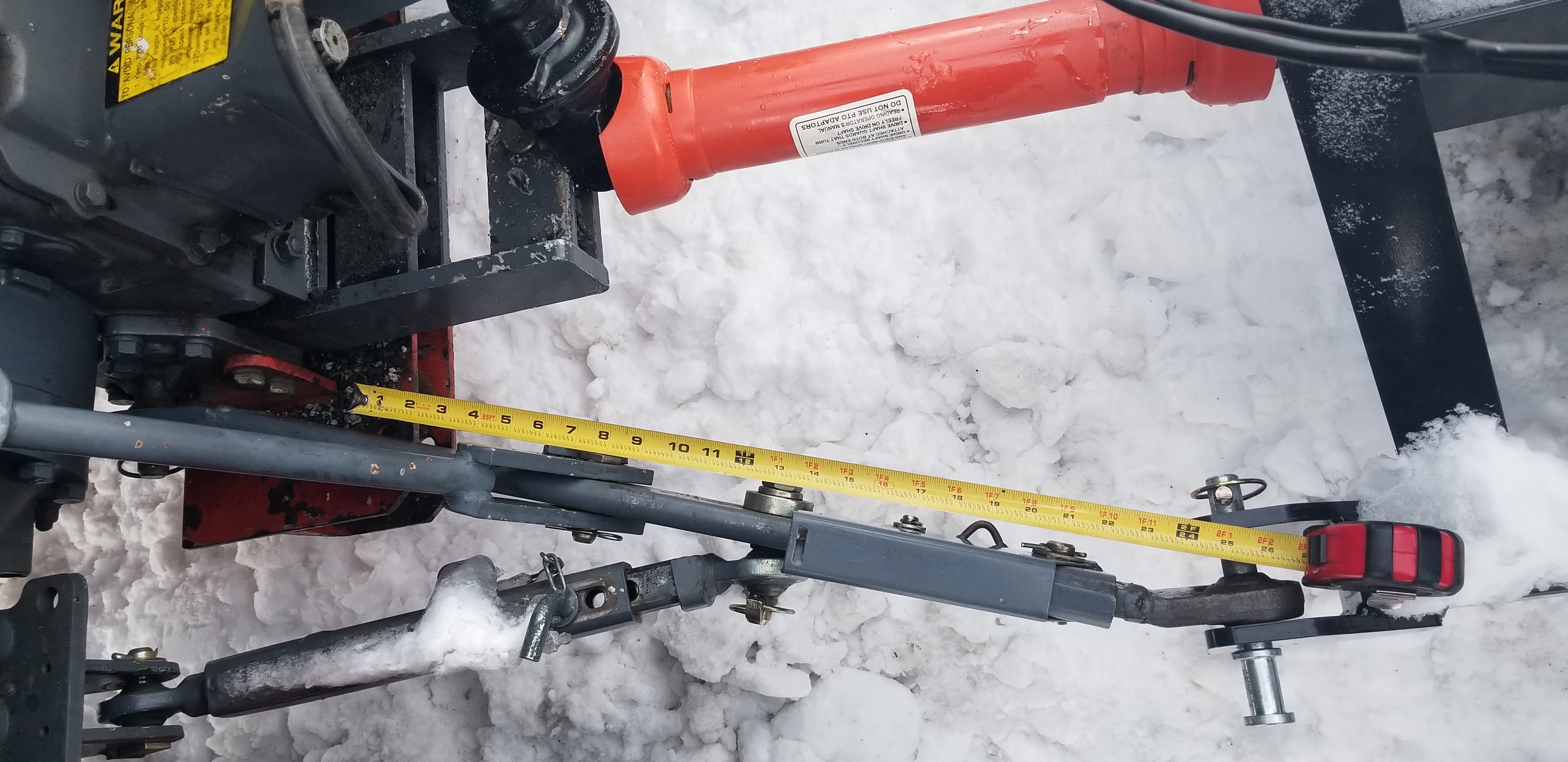

You guys got me going... there was a little bit of daylight left (alpenglow), so I went outside to take photos. The driveshaft DIDN'T matter. Same thing happened. I measured the approx length of the lower arm, starting from the same estimated place the top link is located and it was roughly 25.5". The top link measured approx 29". I think that is the problem; the 3 point isn't raising straight up and down.... as the arms come up, the top rod pushes the top of the blower out 5". So I guessing I need to get a mobile welder out here to raise up the top link "tower" so the lengths are closer together. Thoughts?

When I see a big tractor with a QH, the top link is probably 4 to 5 inches above were the top link would normally connect to the blower.
