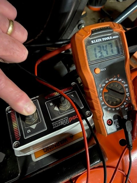

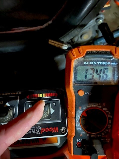

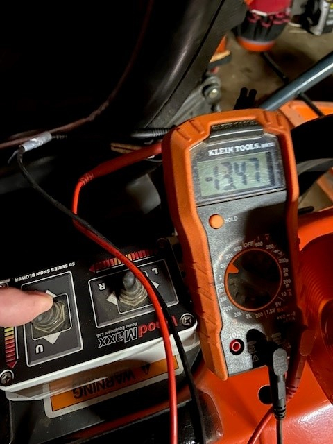

OK I went out and put my volt meter in each plug and recorded the readings - you will see in the attached pics.
Plugged the leads into the two feed wires for each motor.
- Chute Rotation Left 13.46 V
- Chute Rotation Right -13.47 v
- Deflector Up -13.47 V
- Deflector Down 13.47
I think it still could be a bad ground wire in your case Sierraau
So, "bad ground" means that I need to do away with the fender ground and maybe run a sheet metal screw into one of the cab supports, or do I need to run a ground back to the battery?
