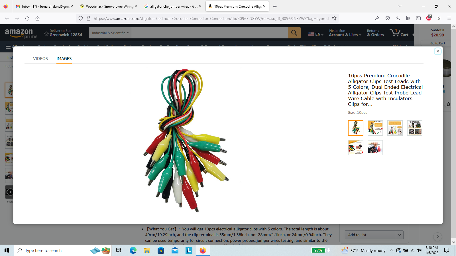

You need a couple of alligator clip jumper leads,
they are available many places any auto parts store as well as Harbor Freight and such.
They will aid as they will grip your meter leads and wires or terminals.

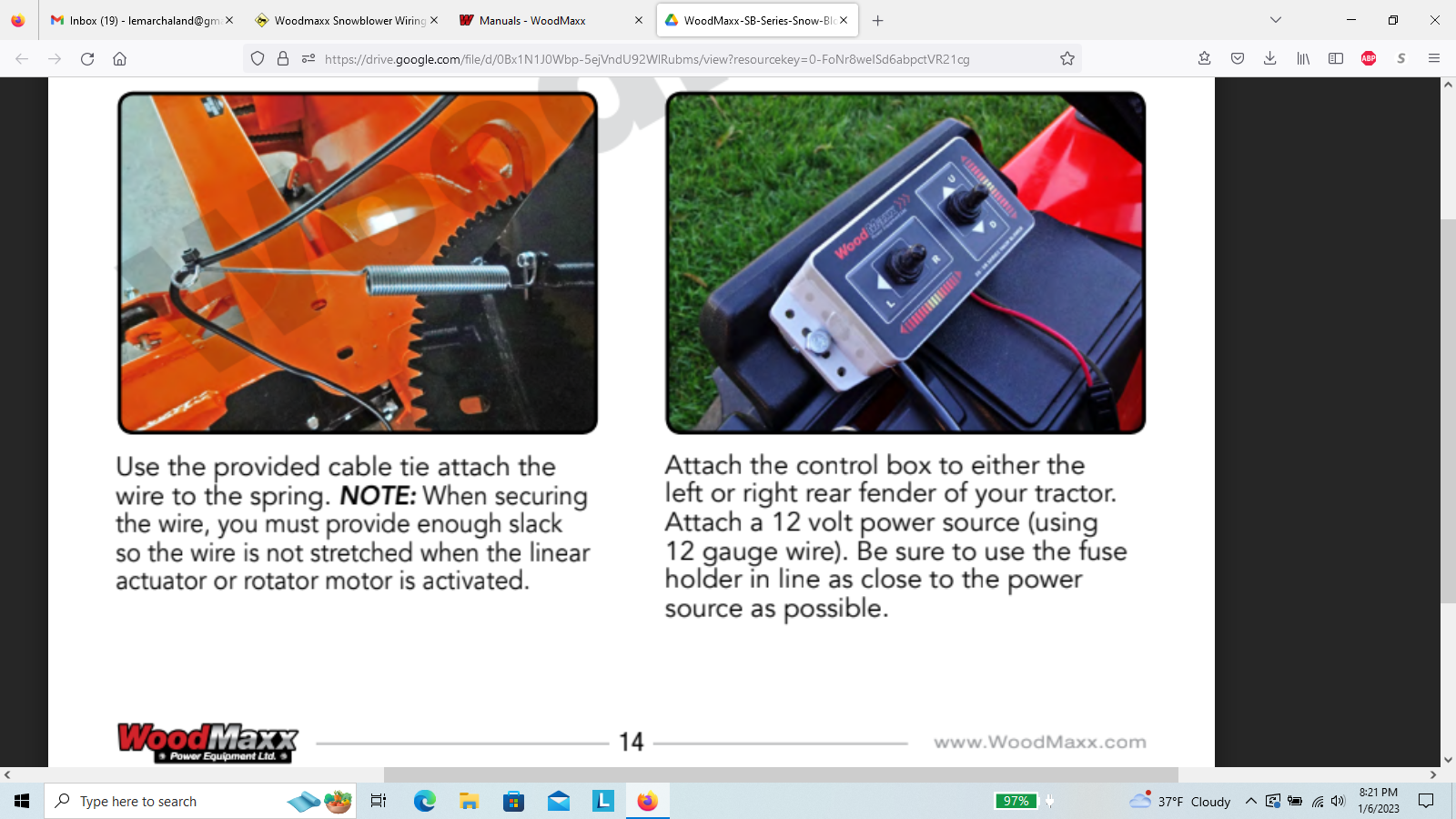

I just noticed that you ran a #14 wire for the negative lead to your common grounding point, that might work but;
#12 is recommended.
   / Woodmaxx Snowblower Wiring question
#79
#12 is recommended.
That's what happens when i don't read instructions. Why do they want a 12# wire when both the leads coming out of the controller are 16 or 18#. Working on my tractor is my new hobby. This thing is really messing with my mind. I just don't get it. But I will go buy some #12 and see if that works as a direct connection with both the + & - and nothing else involved.
