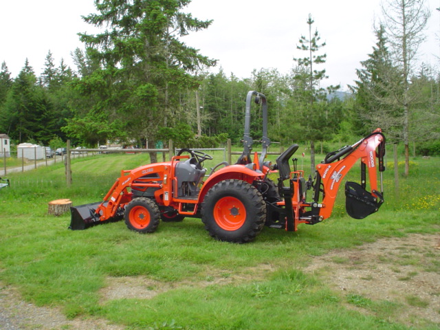

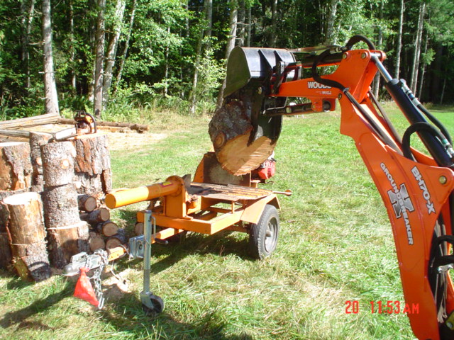

/ Woods backhoe problems #4

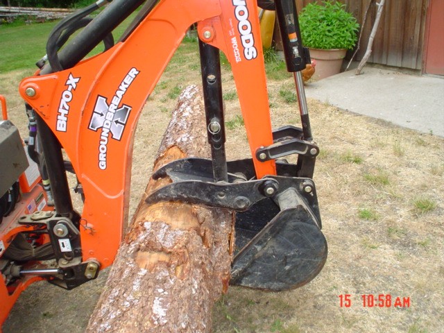

Used mine yesterday and works just like when I got it new about 21 months ago. :thumbsup:
