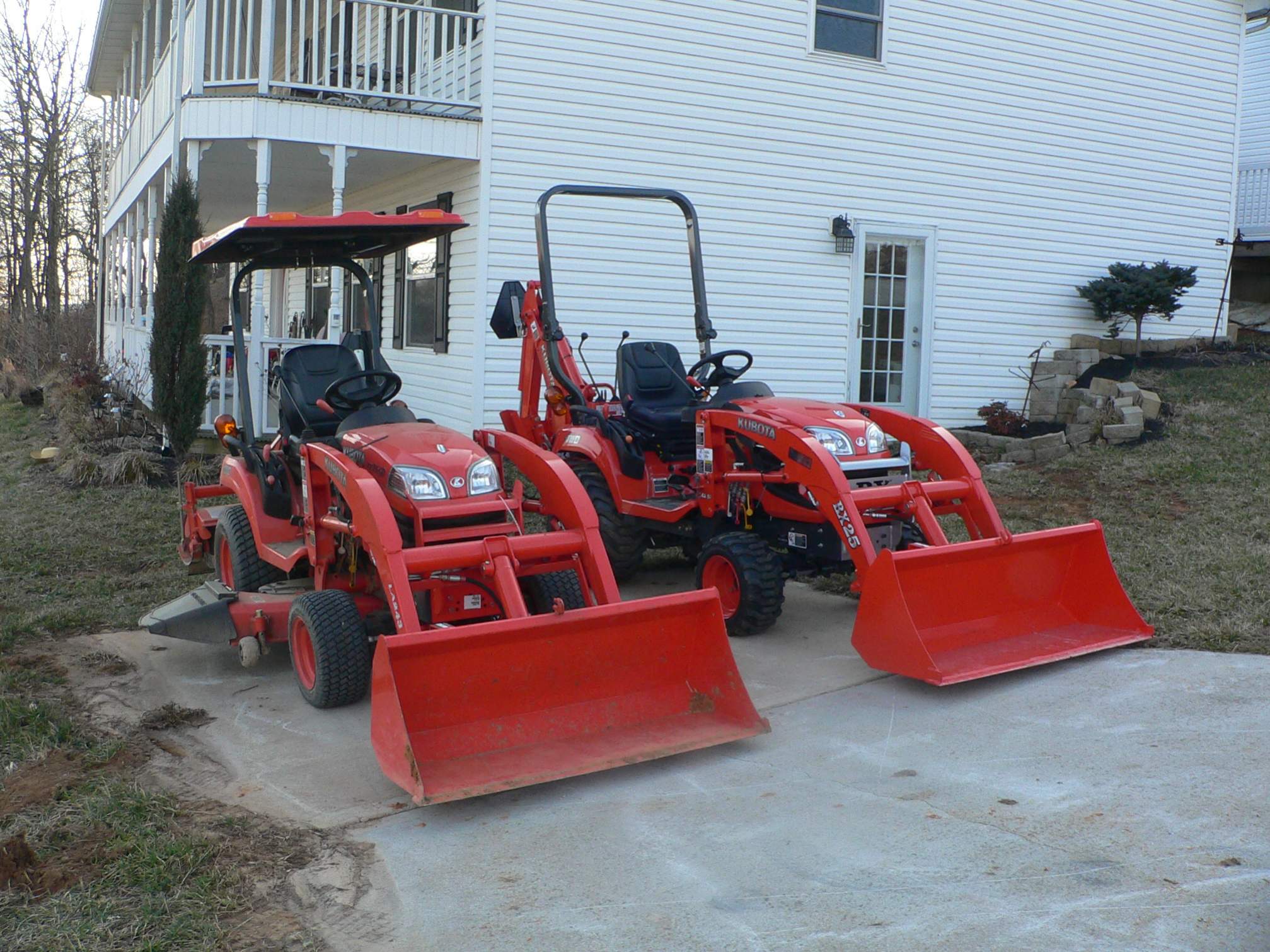

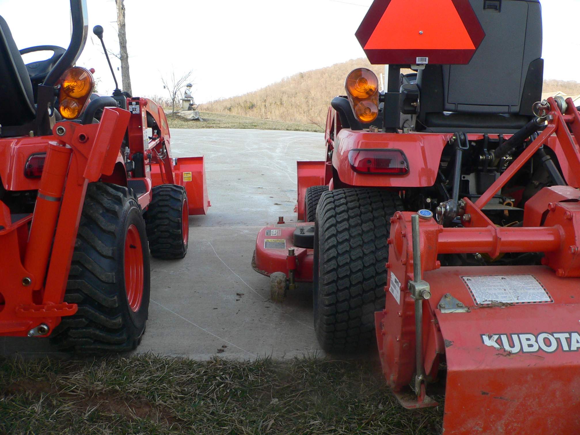

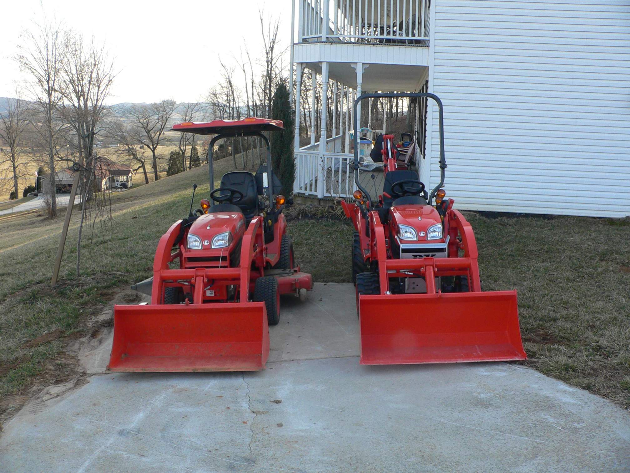

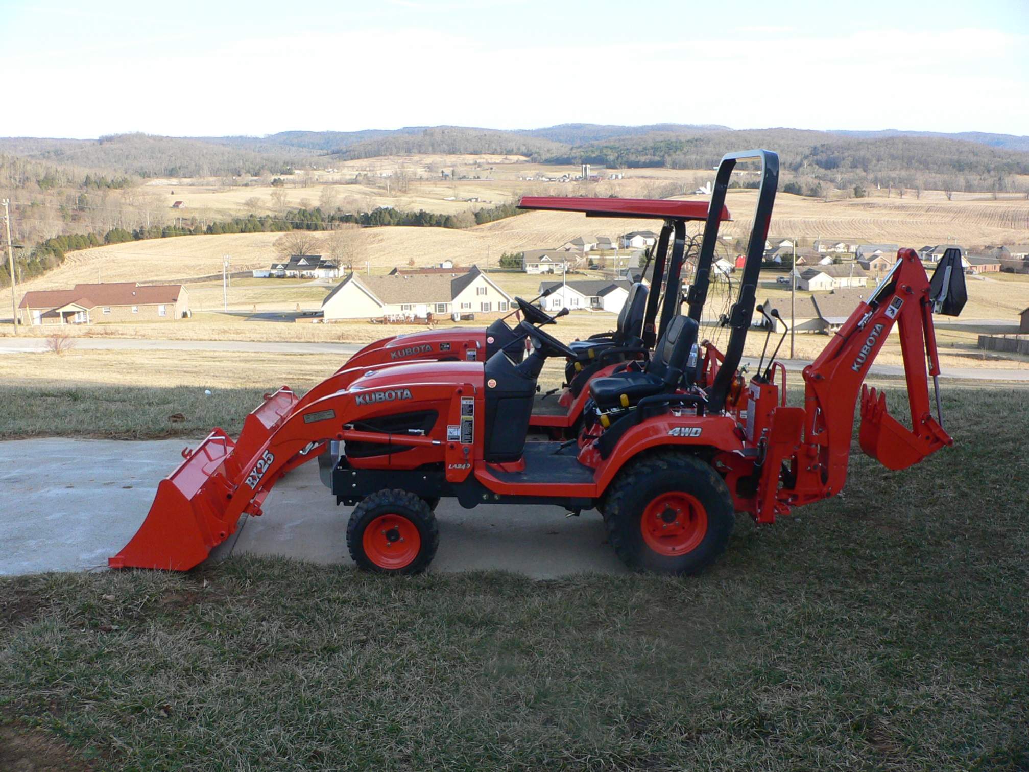

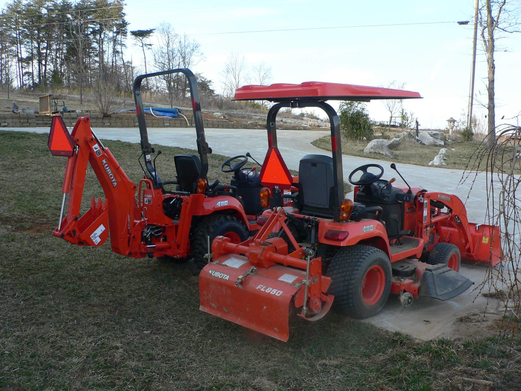

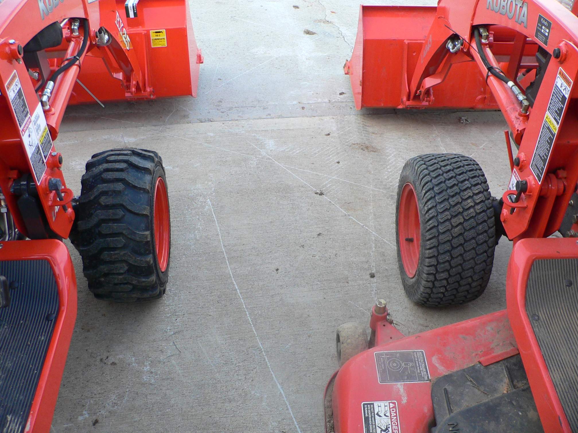

Side by side BX25 and BX2660. Are you nixing BH idea?
