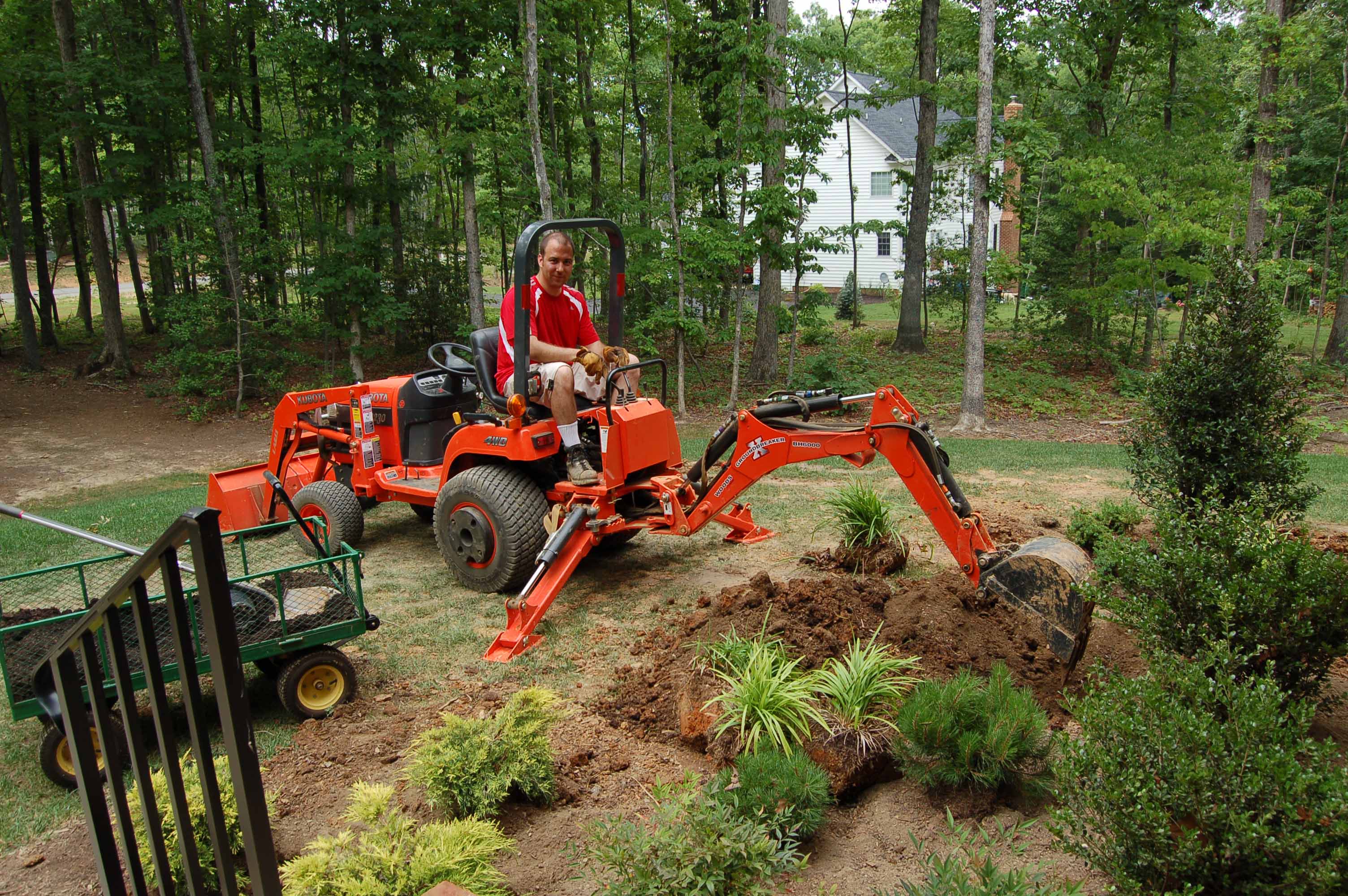

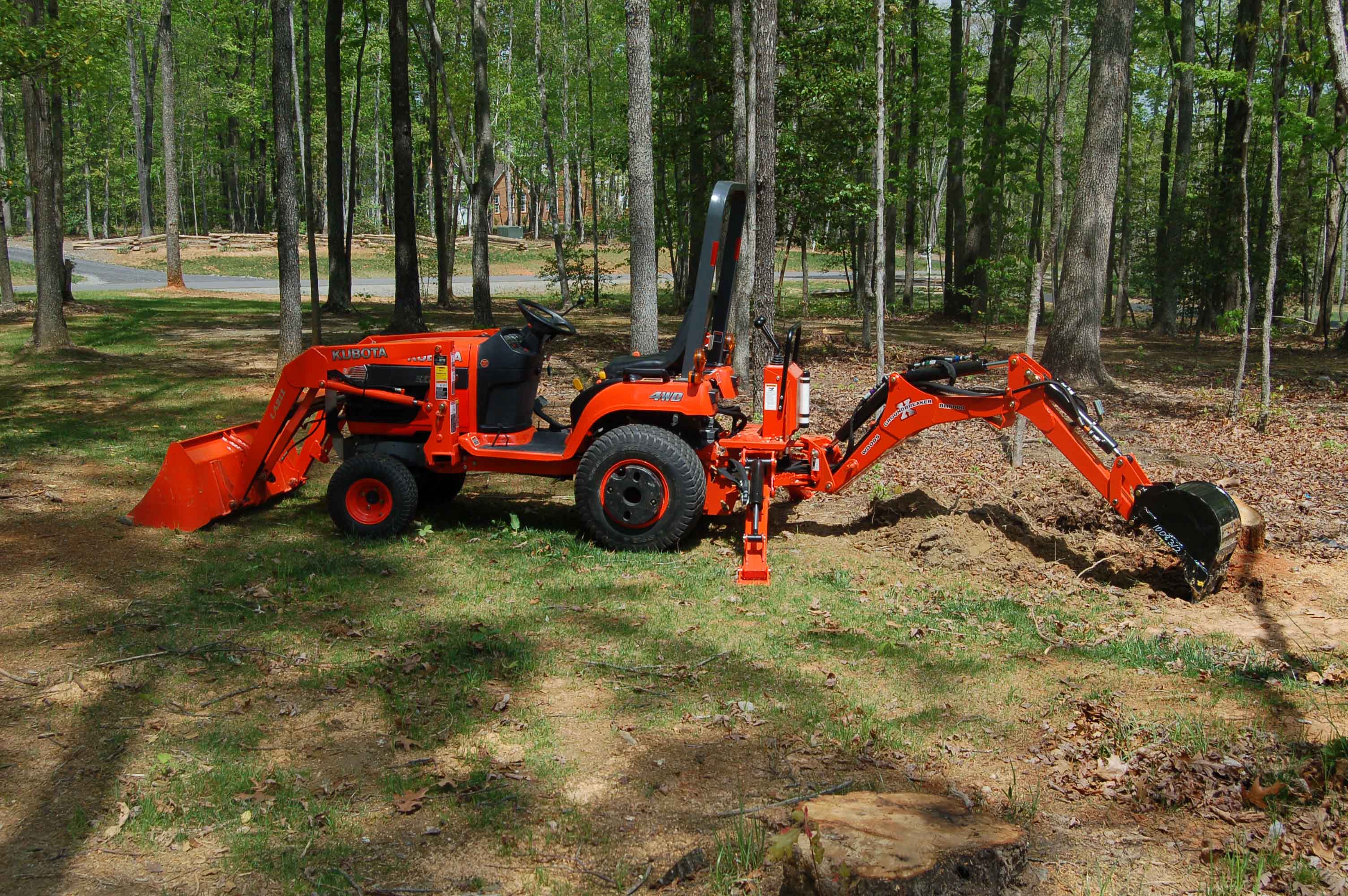

I can tell you that the Woods unit is every bit the backhoe as the OEM unit. I'll go a step further and say that the Woods unit on my personal machine IS A BETTER BACKHOE than the BX22-generation OEM backhoe (for those who don't know, the BX22 being the BH-equipped contemporary to my BX2200/2230 generation machine phased out after 2006). That was actually a factor in my decision to purchase the backhoe later. I didn't care for the straight boom and the lower-end construction of the Kubota BH of that generation. I'll also say that the BX23/4/5 BH has caught up with, and in some ways exceeded, Woods, making the decision more of a wash...the financial savings making the all-Kubota machine a clear(er) victor.
