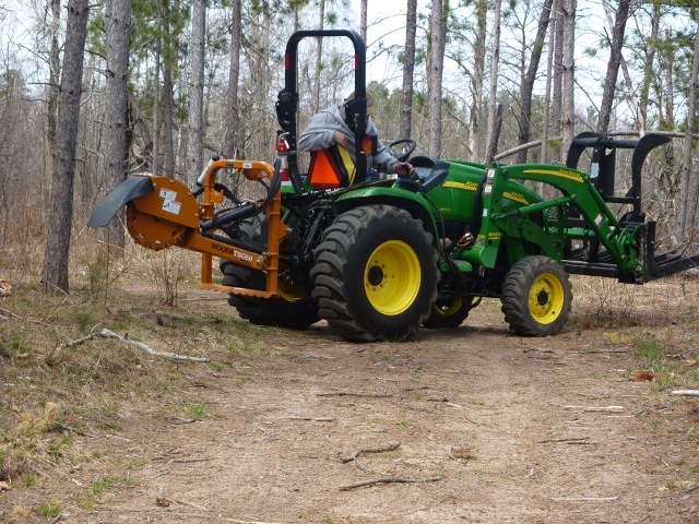

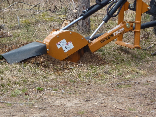

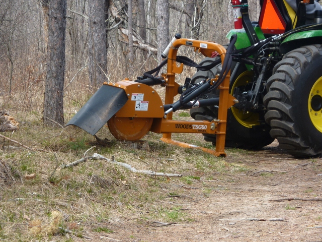

I put in another 1/2 day of stump grinding with my woods grinder. I now have ground out over 200 pine stumps in about 7-8 hours of use.
My stumps are all red pine and a few years old. The trees were mostly sheared just a few inches off the ground. The higher stumps definitely take more time. I grind mine about 6 or 8" below the ground so I can later run my disc or tiller though the area. (I run the disc first as I normally find some missed treasures).
At times my grinder will spit chips and debris up to 50 feet behind the cutting wheel - NOT a good place to watch! I don't have many rocks...but I bet a rock could go twice that far. No debris comes toward the tractor....nice!
A quick tooth inspection shows the teeth are still looking good and most have about 50% of the paint remaining.
The slip clutch is tough to set up. If....no....WHEN it slips you immediately know by the smoke. Just a little tighter (like 1/4 turn on the bolts) and I stall the engine before the slip clutch gives way. I am leaving mine set as such and hope it is protected from a shock load. :confused:

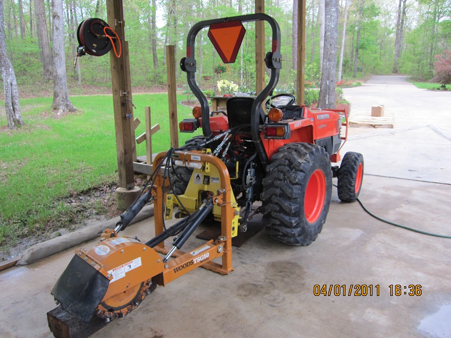

I am using a Kubota L2800 with my Woods TSG50 and it will stall the tractor if I get a little too aggressive with it. I have loosened the slip clutch so it will not stall the tractor since I only have 23 PTO horsepower. I have also put in flow control valves in the hydraulic lines so I can slow down the cylinders as much or as little as I want.

300+ stumps now. Teeth still cut like new. I dont see any appreciable wear to the teeth or the wheel.....but most of the paint is off the teeth and the right side of the wheel has qutie a bit of the paint wore off. Still.....I dont see any major wear....and I expect to grind another 300 stumps and still be going strong with the original teeth (I hope). I do not have any rocks... but my soil is pretty sandy and I grind the stumps without regard for the dirt and sand to a depth of about 8".
I have ground a few oaks and some other hardwoods...but most are pine and a few years old....so they grind quite nicely. I suppose the oak take 3 to 5 times longer. I get up to 30 pine stumps ground per hour.
For my purposes....this grinder has proven to be the right machine.

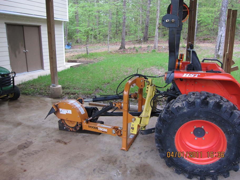

Yes, two rear remotes, but it is kinda nice to use it with the hydraulic top link, especially if you are working into a bank.
So three is handy and you would need four if you have top 'n tilt - - Yeah, tilt could be useful for this.
{A bank of the dirt type, not financial institution, although I could probably cut a hole in the wall and....... Oh, fergettit}
I think I will saw off anything above about ankle bone height in future, so the 16 above isn't useful anyway.
I can't see needing to go the full 16 below grade... not for anything I would want to do later.

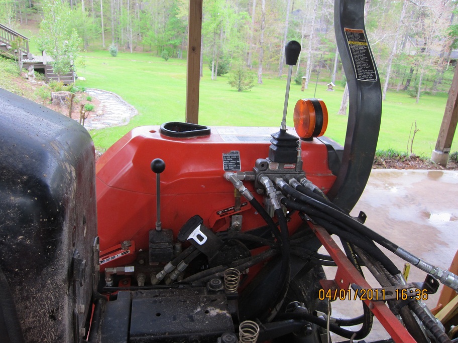

I already had top and tilt and added a second power beyond joy stick two spool controller. I think woods sells a kit that will enable you to use it with a single spool valve. I like the top and tilt with the grinder and it enables you to grind on slopes a little deeper. I think the bottom plate on the grinder will keep it from going much deeper than 6-8 inches. But is plenty for me.

Is there any reason you couldn't plumb it to the power beyond circuit and mount a dual spool valve on the grinder? This way you could stand beside it to operate rather than looking over your shoulder.

I guess it is possible, but may not be practical. I don't have any problem not seeing and I am standing beside my tractor at the right rear wheel when operating it. Not in the drivers seat.

I use the loaders joystick valve to operate both the sweep and the up / down cylinders on the grinder (plus the rockshaft to set the "frame" on the ground). I use my 3rd svc to operate the loader boom...and do not have use of the curl function when I have the grinder installed. I have the hard-line kit that goes to the front...and that has a set of couplers near the other loader couplers....so its all "plug and play" for me. :thumbsup:
