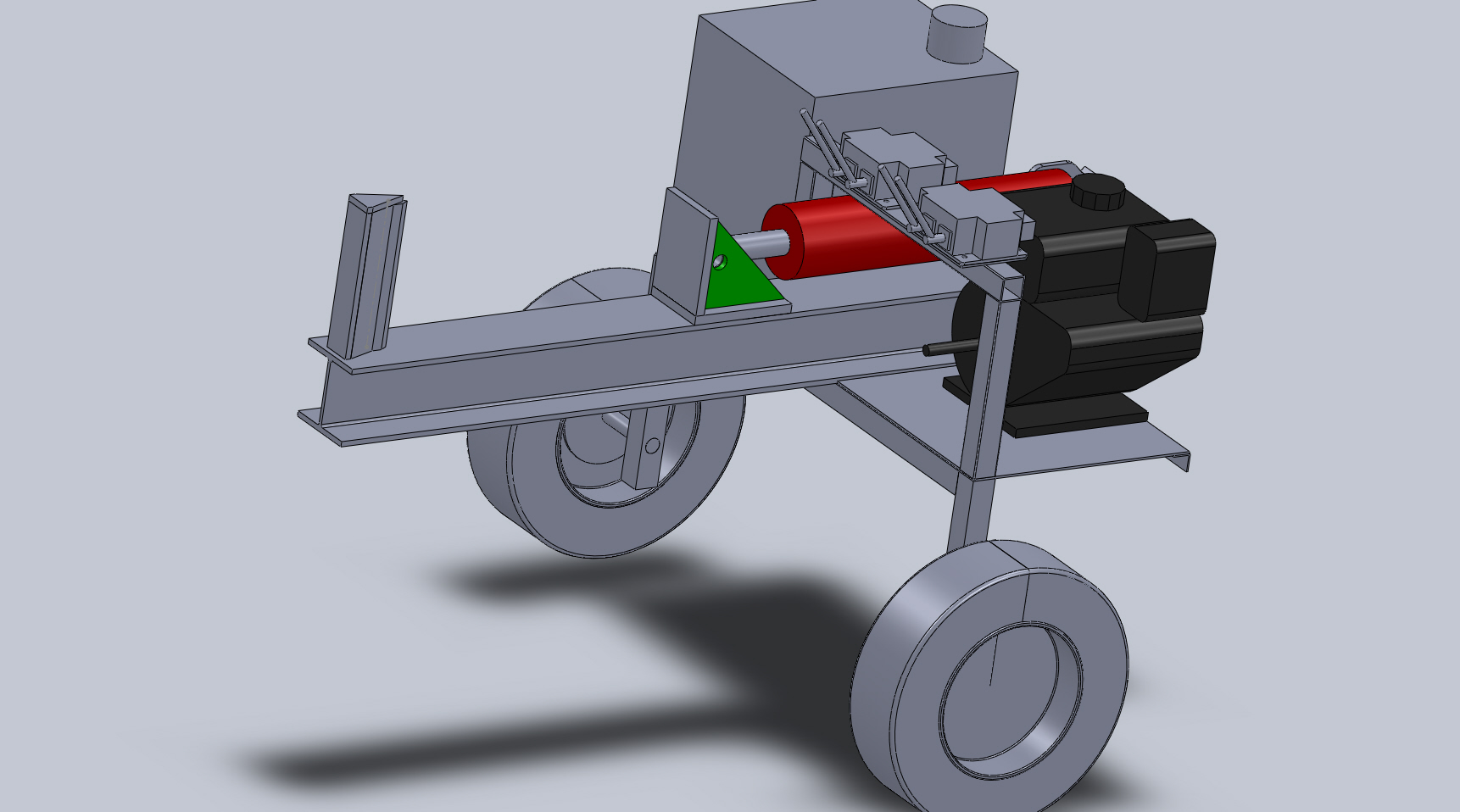

Attached is a quick rendering of the Ibeam section minus the "accessories"

This is off topic but I see these nice 3d drawings of project you are doing what do you use for software?
   / Woodsplitter Build (Timberwolf clone)
That was drawn in Solidworks which i fortunately have access to. I prefer Solidworks over AutoCad as it works the way i think.... Scary really considering how buggy SW is... That doesnt reflect well on my thought process does it?:laughing:
One advantage is it gives me the ability to check for interference and range of motion. In my model of the splitter on my computer, i can move the split cylinder in and out in real time to determine where my wedge should go for example. I could also move the wedge and log lift if i had drawn them. Its a great tool.

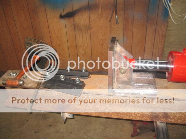

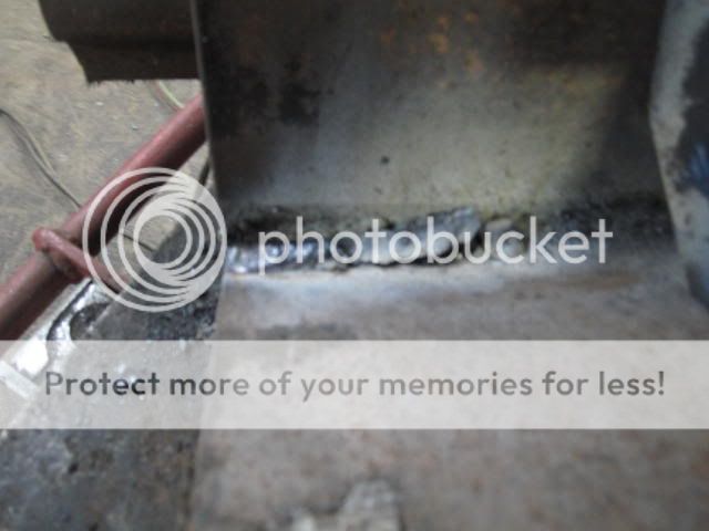

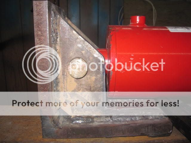

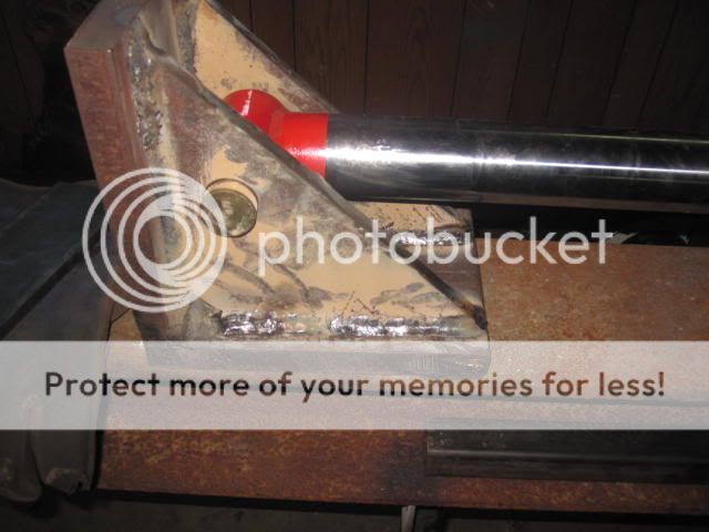

Capped the end of the beam. 6011 root with very, very old and wet 7018 cap. Cut out the cylinder mounting plates and gussets. Bored out 1 1/4" pin hole.
[/IMG]
[/IMG]
[/IMG]
Motor, cylinder and tank...$1900 :licking: . Yes i know im cheating by buying a tank, but it only ended up costing about $100 more than building it myself. If you ever had to grind out weld and chase leaks like ive had to do, its 100 well spent.....

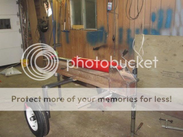

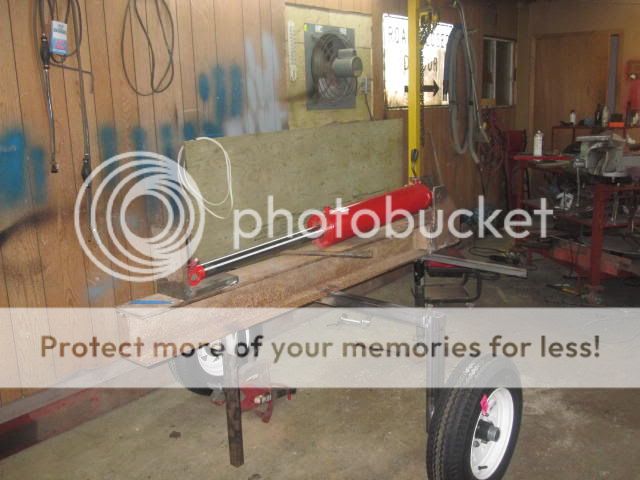

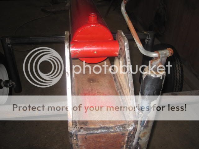

A few more pics.
Keeping the pin in place helps to keep the plate aligned when welding
Rod mounted showing welds to mount plate. Notice the old trailer jack. Was bent and had to cut out a section to straighten. Recycling at its finest:) There will be a piece of plate connecting the uprights before its finished
Sittin up on its wheels for the first time

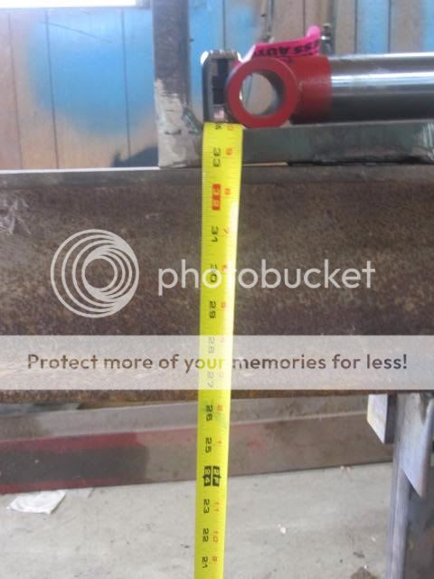

32 2/4" off the floor for a comfortable work height
