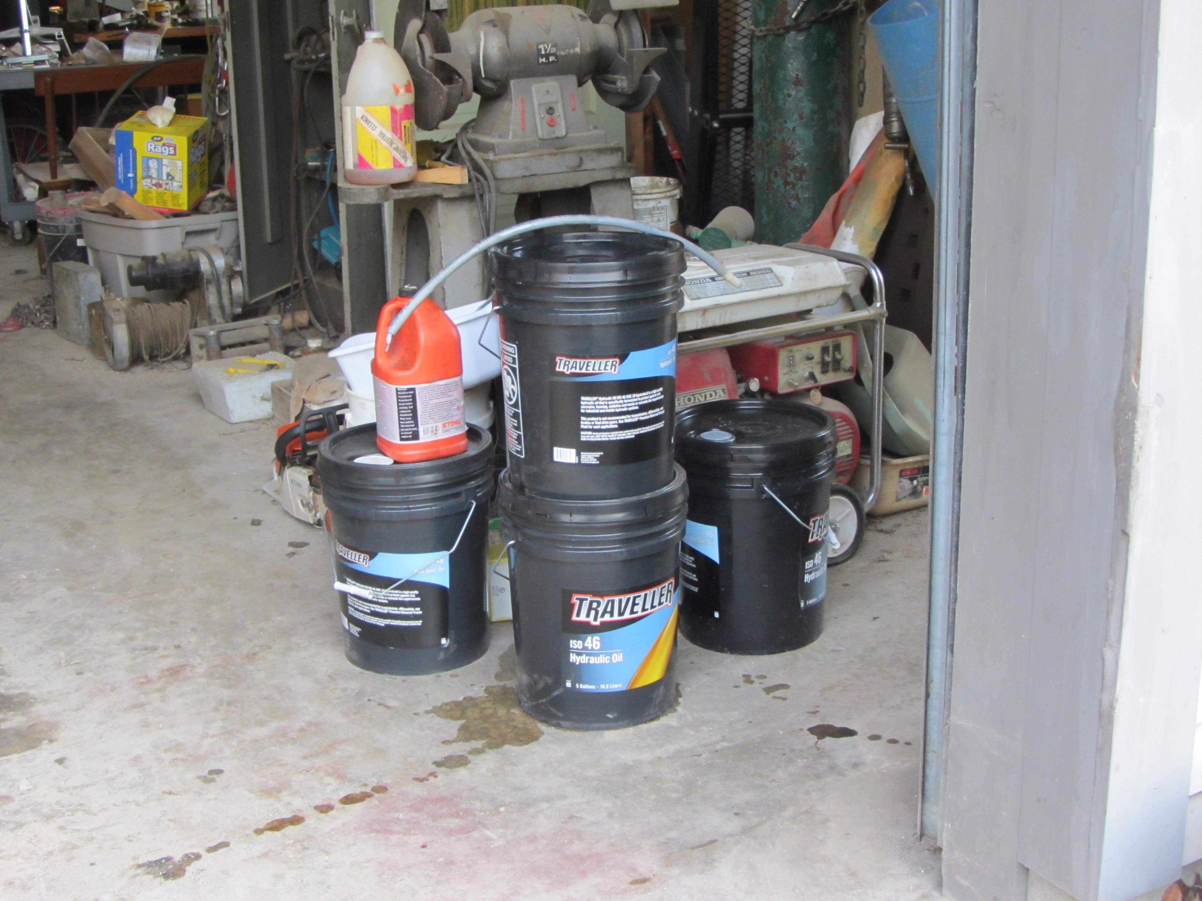

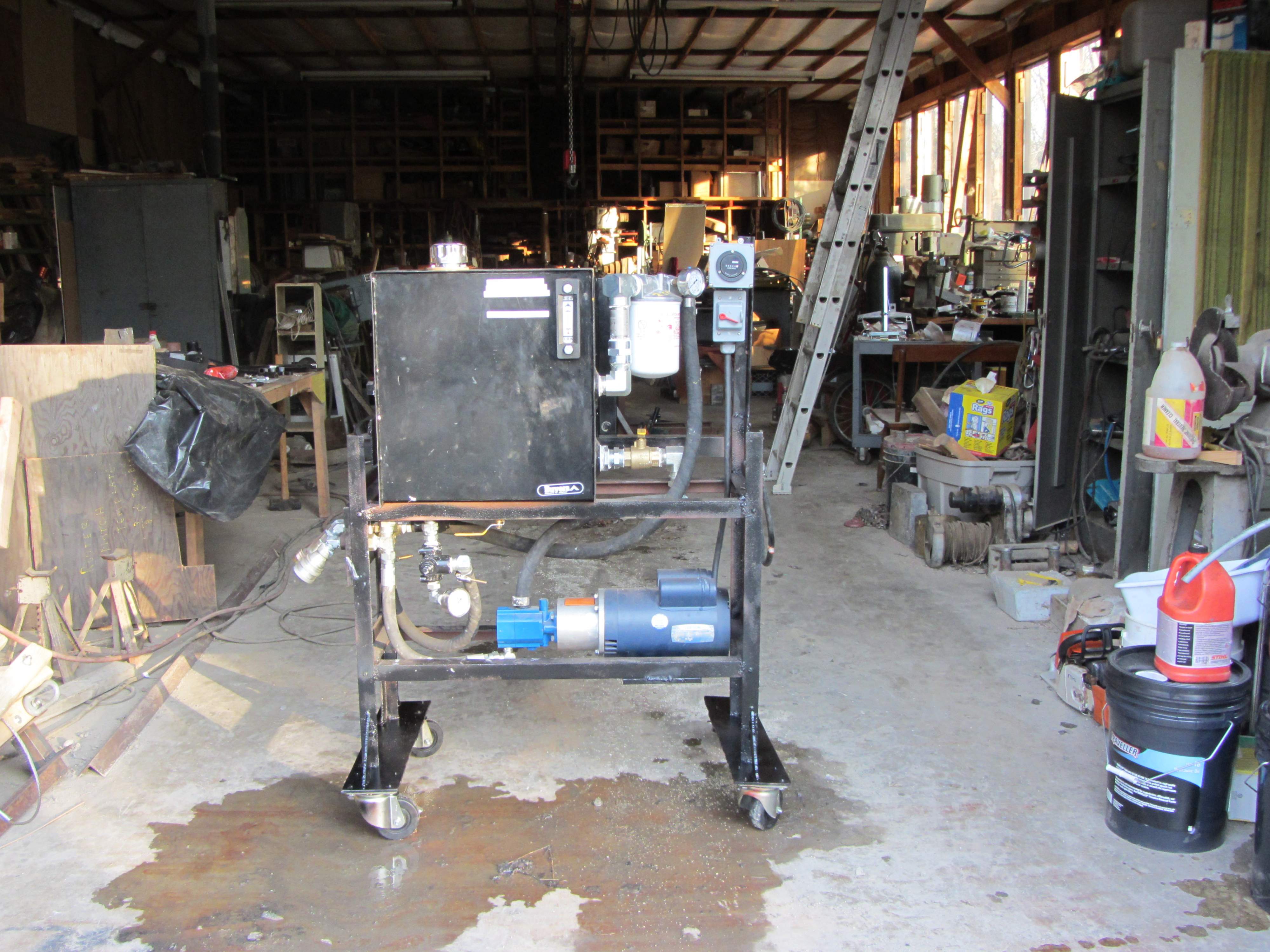

All right The pump package is finished Ready for oil I got ISO 46 oil good efficiency between 0 and 60d F. Should be ok. Who wants to split wood colder or hotter. Maybe oil tomorrow and let it go over the relief valve at 300psi for a while. Let all the little bits make it to the filter. Everything coming back from the beam will return through the filter. The casters are really nice for pushing it around.
Rain tomorrow. I can probably weld on the beam just inside the door. Although it will be in the 50's on Friday.
I forgot to mention that the electrical switch is a 2 pole 30a switch . It is the biggest switch I have ever seen that looks like a normal wall switch. Should handle the 20A load with out any problem at all. Currently I have a 220 15A plug on the line cord. I will probably change that to a 30A plug.
The line cord is 12g but pretty short so I will leave that. I am debating with myself on the out let in the shed. I have run my other splitter off a 12g ext cord from a 220 outlet for 10 years. I want to put a more permanent outlet in and I am trying to decide between 10g romex or 3/4 PVC and pull some 10g pump wire through it. It is all 8ft off the ground and under a roof. PVC is the right way. The feed to the shed is 10g and terminates in PVC now.

Put in 18 gal of oil. Turn the pump by hand for a bit. Backed out the relief valve. Plugged it in. Held my breath and turned it on. 500 psi ran for a while.
All seemed good. Took a breath. Cranked up the pressure at 2400 psi the 20A CB popped. Not unexpected. At 1900 psi it runs on the 20A CB. Then I noticed an oil drip. It was coming off an 1 1/4 pipe. I almost had a heart attack BUT it was a 1/8 pipe plug ,second port for the return gage at the filter.
I never even looked at that fitting other than to notice it had some kind of red sealer on it. I have a spare 4 way out on the beam. Reminds me to use pipe dope on the plugs. The return gage read zero as it should.
No pictures you will have to take my word for a line cord, a gage at 1900 psi and another gage at zero
Swapped out the cb to my shed for a 30A. Now I have to wire out there.
I suppose to test the beam near the shop I will have to run it at 1900 psi. OR make an adapter and plug it in my welder outlet. Think I will do that
