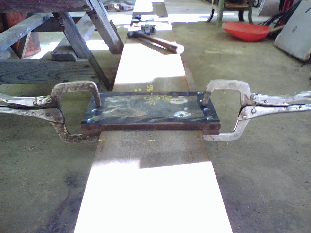

WF8 x35 8ft long. Yard had that exact piece lying around. The flange thickness is .495 so with a 1/2 spacer the sled should work out nice.
/ Woodsplitter build #2 #2
I found the same beam 8 foot long and just finished my sled with a 1/2 spacer..worked good..a little play but nothing serious...Signing up for a cool electric splitter thread:thumbsup:

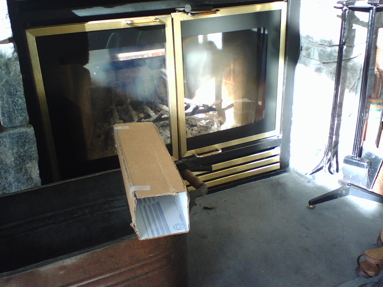

I never figured out what size log is optimum for my fireplace. I have an insert with doors and outside air supply. I made a card board log. Started with 5 x 6 x 16. Too big. Ended up 4 x 4 x 16. So that sets the size of the box on the wedge. It uses a after burn air supply to reduce particle emissions so it wants to burn hot. Smaller log sizes do this.

Pictures Cardboard model of log size

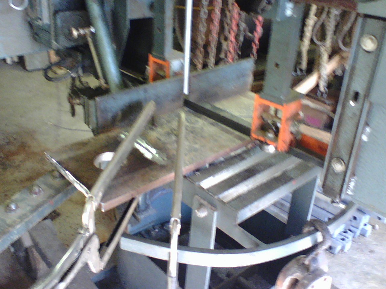

Motor base plate in saw sorry about the focus phone camera old
Hole in the plate is a left over from another project
Sled fab in progress.

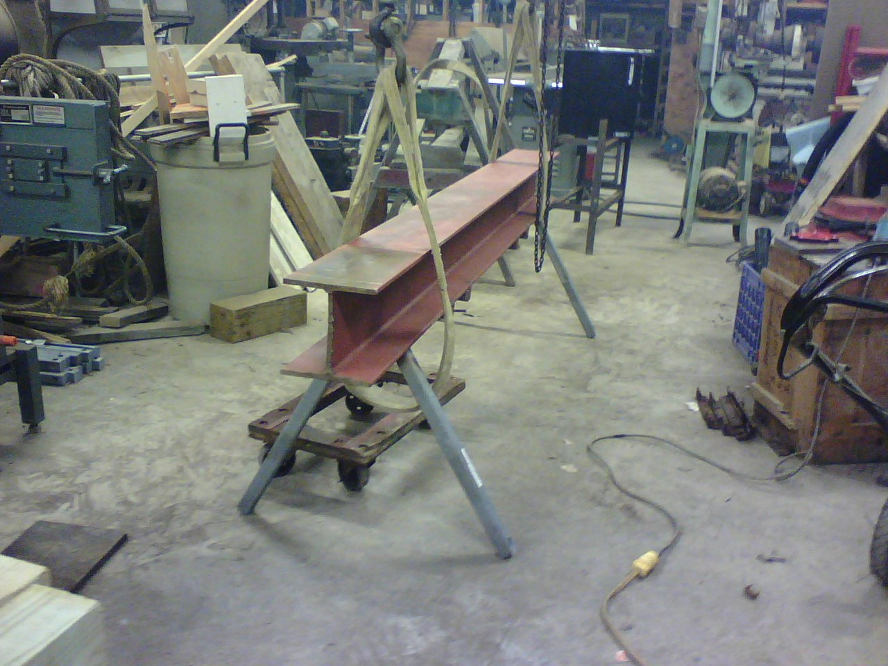

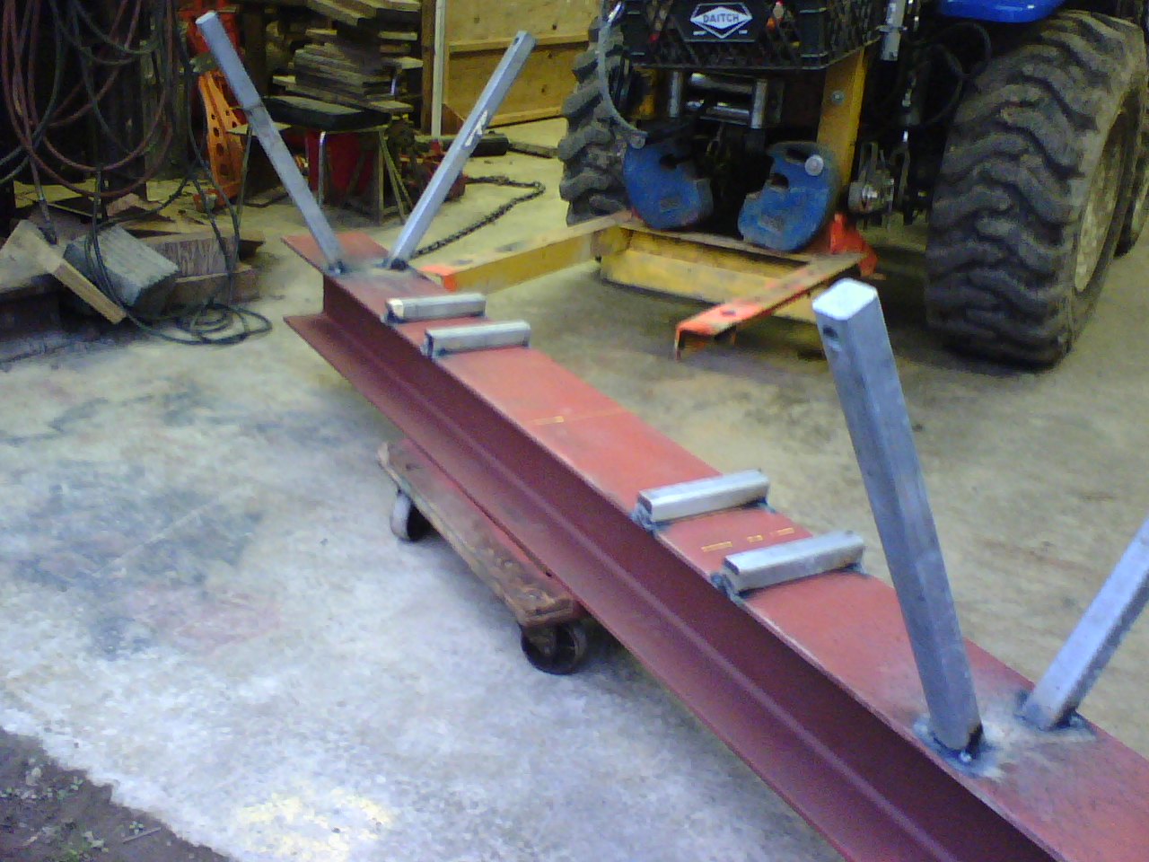

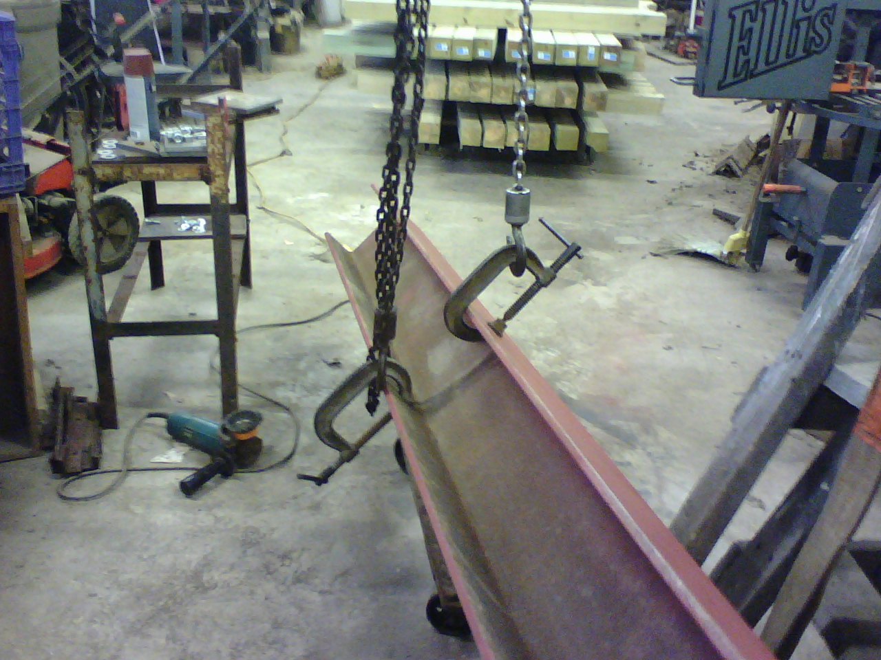

Welded fork pockets and feet on the beam. Did not follow my own advise to bolt first and weld later. I tacked the legs on and during a rotate a clamp slipped and a leg hit the floor and broke off . So in a moment of panic I welded the legs on better. Only thing is now when it is right side up I cannot move it.
I like to move it to the big door for welding. I can always turn it upside down to move it. It rolls pretty easy in the slings.

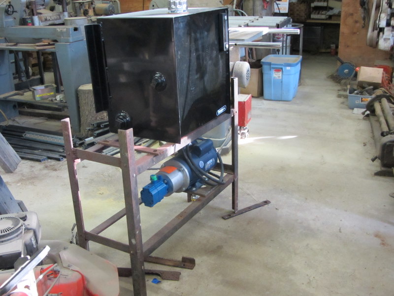

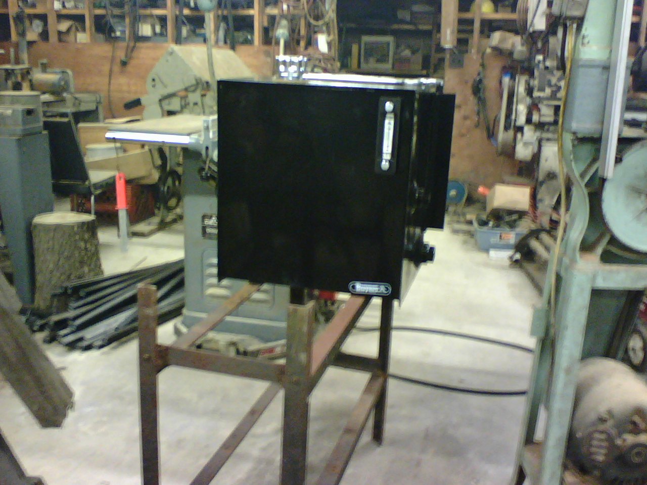

Tank arrived. I am contemplating how to mount it . Like shown I will need a valve in the suction line , otherwise have to dump the tank to work on the pump. Or I could put the tank down and the pump on top. After all suction works. Notice that pile of 4 x 4 in one of the pictures. That is 1/2 of what I have for a project on the Appalacian Trail. Pre fabing handrail posts for 300 ft of handrail on a walkway /bridge 5ft high. I have so many volunteer hours I got a hat. The crew is coming over to work on the posts Monday ( all retired volunteers like me) but for 1 guy who is a paid fire fighter. I said I would provide lunch . Brats. So between Thanksgiving, and posts work on the splitter is going to be a little slow. I think I am going to grind off the legs and weld them to a plate and bolt the plate on. Then I can move it with out rotating.

I am an idiot. The reason I have fork pockets is so I can move the thing right side up. I only have to rotate it to weld on the bottom. I cannot weld upside down very well. I think I only have one plat to weld upside down, the base for the wedge attach. SO I think the legs are good except for adding a brace across them.

UPS dumped 5 boxes in the last two days , including a camera I can put in my pocket. That's how I took the following pictures. Got valves from Surplus, cylinder is on backorder 12-10. Got plumbing fittings from DHH, Some on backorder there as well. I purposely did not order all fittings I needed as they have a $20 min and there are bound to be some changes. Got a piece of Grader blade from Discount Steel. Not cheap but exactly the right piece for what I am doing. 30d bevel off the flat on one side. I got 36" 18 for the top leading edge of the box and the rest for 3 verticals inside the box. I though it would be machined but it is hot rolled. The bottom plate of the box wedge is 18" wide and 12 deep. The top is 18" wide and maybe 16 deep, it is the split out table. I had some 5/8 plate I could have burned out the pieces from but them I found some 3/4 drops at the steel yard and figuired I could weld them together. SO I spent some time milling a 60d bevel on one edge of 3 pieces , actually almost 48" of bevel. Thats for a butt weld. Once I started that bevel I had to keep going. Thats the bottom plate. For the top plate I decided to bevel both sides, i.e top and bottom of both butting plates. It's 4 passes on the mill instead of 2 but smaller bites each time. I only have the grader blade piece to do 18" twice. I stripped the teeth right off a brand new Milwaukee hole saw about 1/8 into a plate. Right after I took that
picture. HD will probably replace it. I had to go to a boring head and chipped a carbide boring bar. Must be some reallt hard junk in that plate. I like to use shaft collars. They are cheap , accurate and square. I line up the shaft collars, tack them and then line up everything else with the shaft in place and tack . In the pictures everything is tacked and the 1 1/4 shafts move freely. I guess tomorrow I will be cutting more 1/2 plate for gussets on the splitter box base. I also have to get started on the power pack. I think I have enough fittings to start roughing out where everything goes in the frame. Whoops I have to wire brush that frame and prime it first. I built that frame 40 years ago for a speed reducer to run a shaper. Sold the shaper and then used the speed reducer to turn a spit for roasting pigs. Those were the days. So now it gets recycled again for a hydraulic power supply.

Curious..what size hydrolic tank is in that pic? 10g?
#17
22gal but you can only get 18 in it. Sized to upgrade to 22 gpm if required at some point.

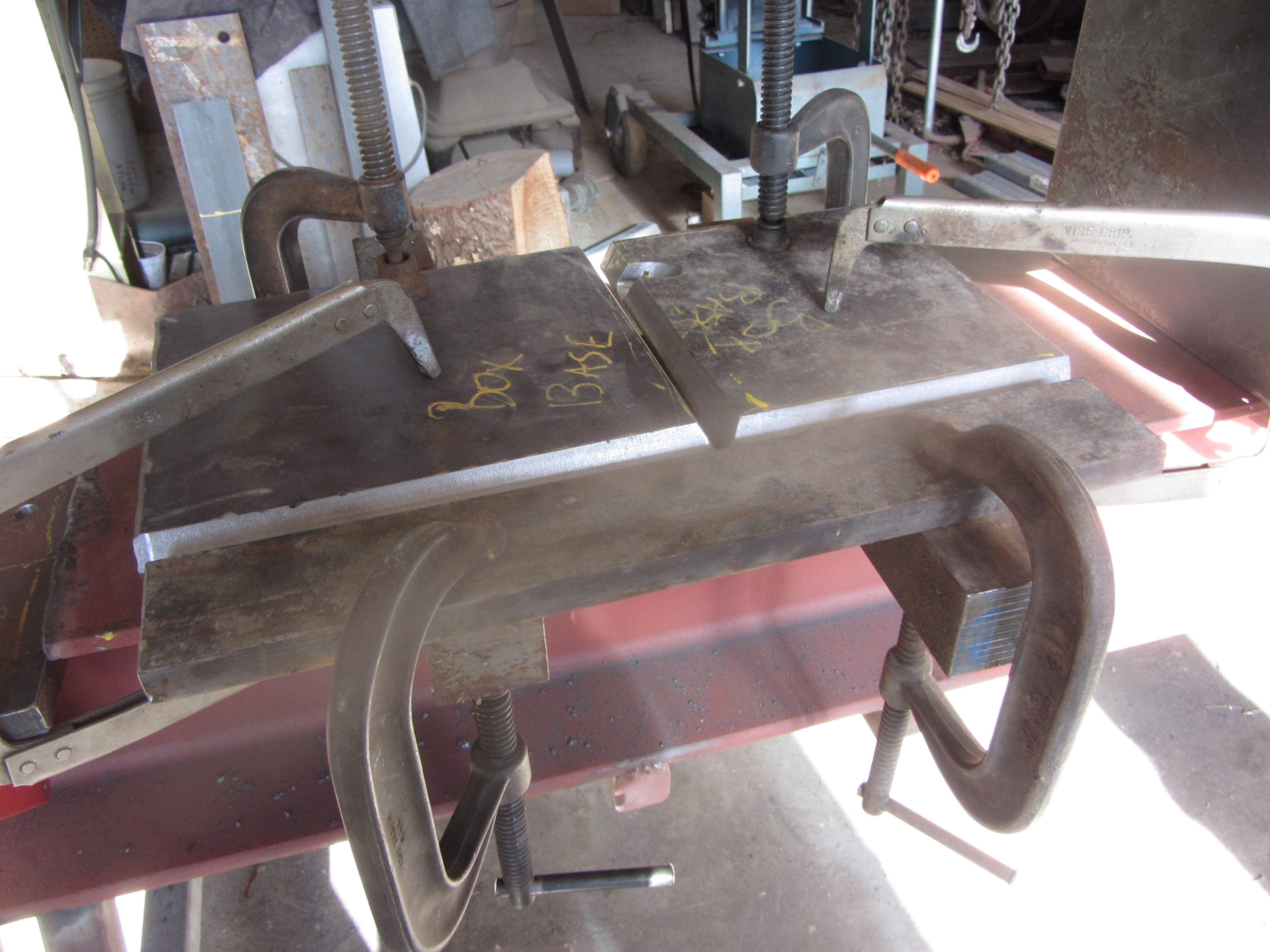

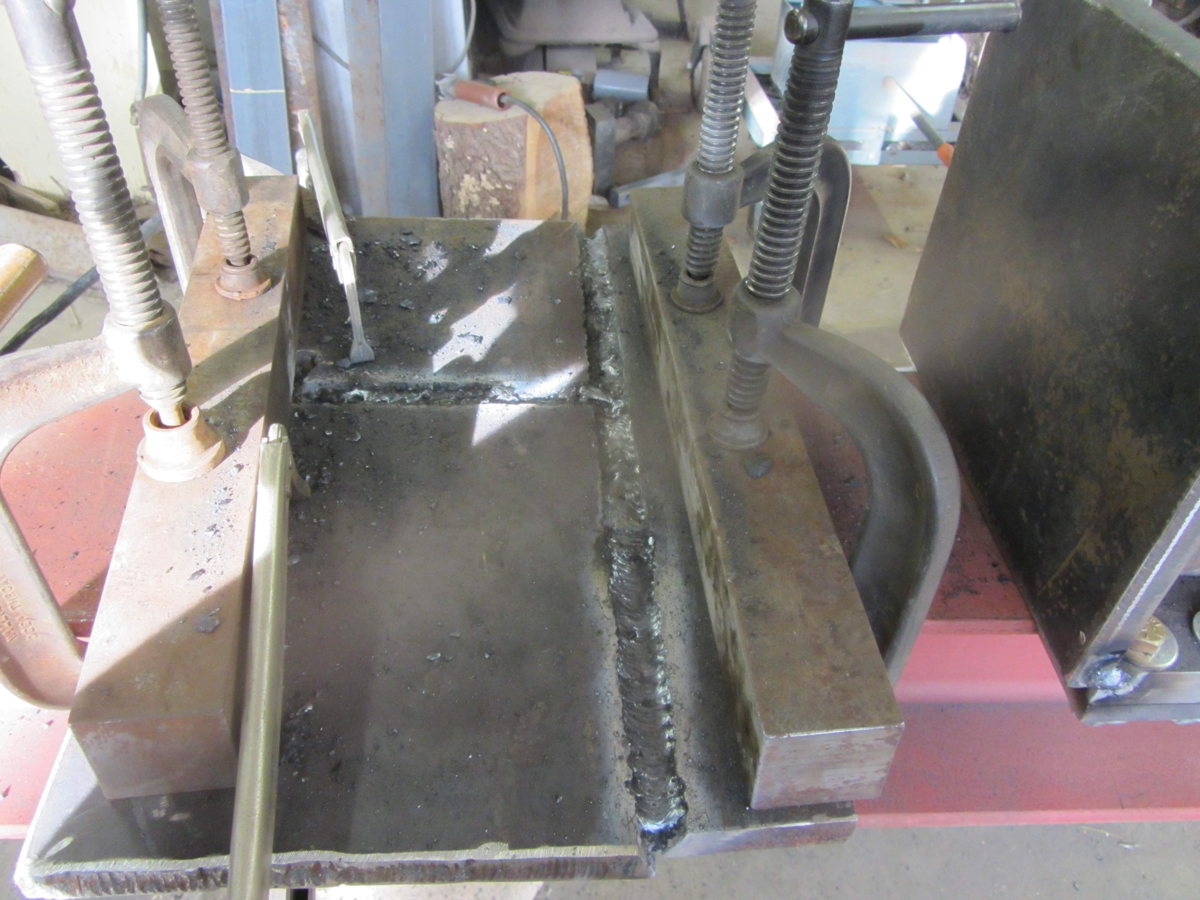

Todays work was welding the base plate used 2 # of 5/32 MG 500 rod. Nice rod once I got up to 145A and stopped making voids. This was the 60d bevel on one side. I won't do that again. I clamped it down pretty good but one side warped up a bit. I think I can work around it.
I also beveled the grader blade 60d but shallower and both sides. When I weld that not only clamp it well but keep flipping it from side to side and alternating welds end to end etc. Out of rod till Monday.
