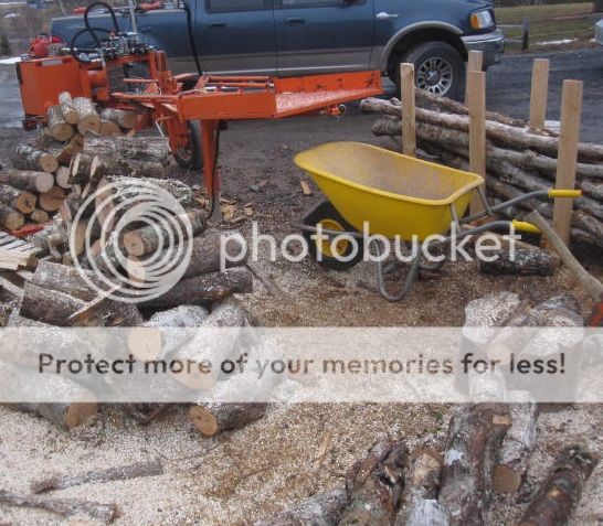

How does the out feed system work in real life ? I have a tw5 with a home made table like yours and I am thinking of making an elevator or a feed table - just curious how yours has worked .
Splitter season again.
Did a few mods and repairs including installing a new pump and autocycle valve under warranty. I also put additional support for the tank and motor mounts.
Straightened and re-enforced the tube outfeed. Previously it was regularly bent when wood would come off the wedge and catch the edge. The ramp/re-enforcement is made out of 1/4" thick steel
Painted and labeled control levers. This should cut down on grabbing the log lift lever and launching logs into orbit! I hope :)
I also built a 3' outfeed extension. Hopefully this will get spits out further from my work area and allow me to get a bigger mound of splits before having to stack

Do you have any pictures of you out feed table in use ? or set up on the splitter ??
   / Woodsplitter Build (Timberwolf clone)
#65
The outfeed is permanently attached. The far one does fold up when not in use. I will likely be reworking the outfeed tables to have higher sides as part of the conversion to a processor.
About the best I have for in use pics are these:
   / Woodsplitter Build (Timberwolf clone) #66
The yellow thing at the end of the outfeed has to become a 150.00 hay elevator
It became a $20,000 wheelbarrow :laughing::D
