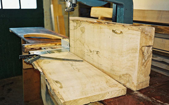

How do you rip a 4’ by 8’ in half? Most folks that that bandsaws are limited to 12” or 14” if you are blessed with a larger one.
Also a bandsaw really needs a longer fence and table to support anything large.

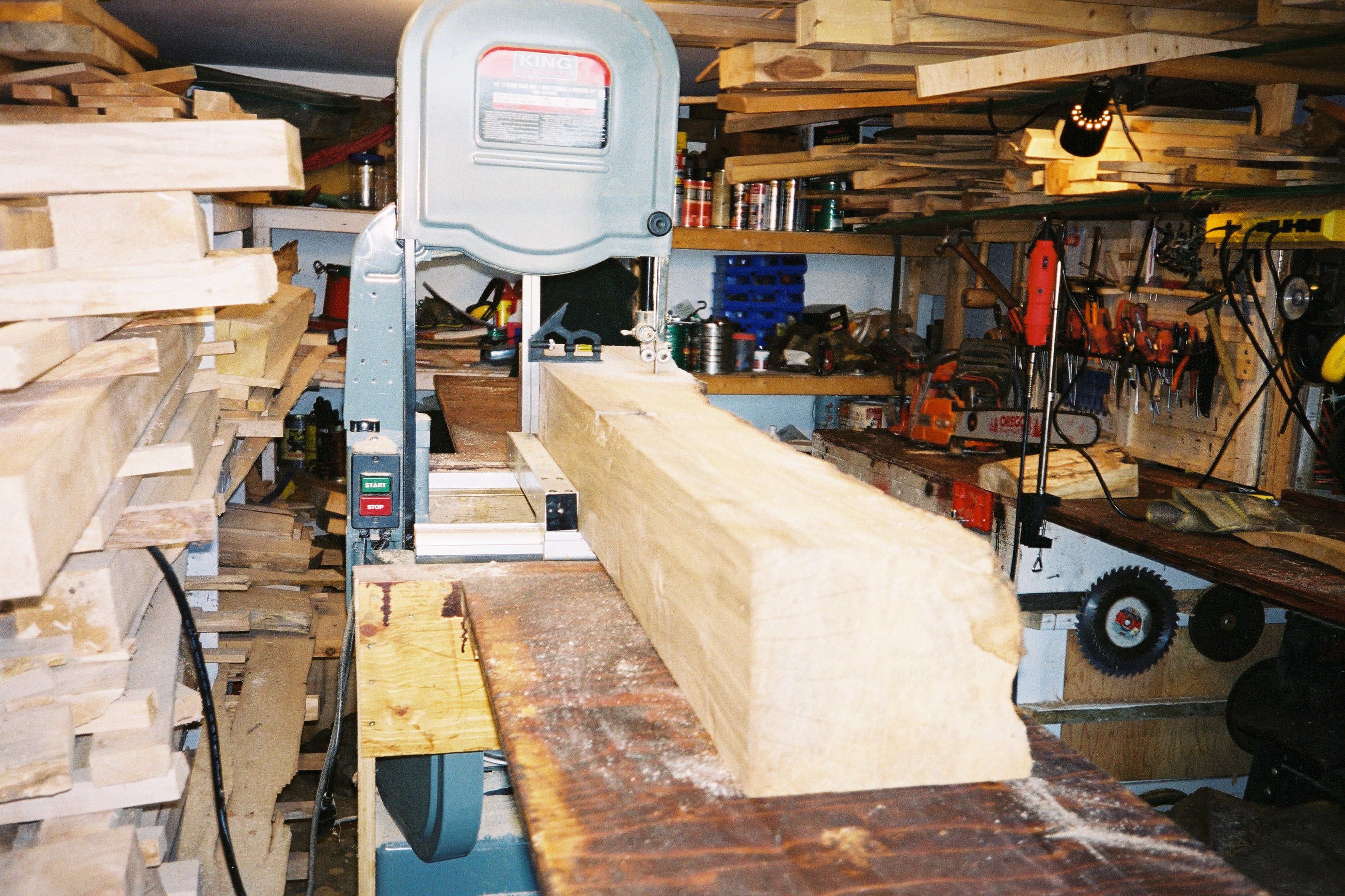

Skillsaw and a 2x4 work well for this. Lots of folks now use tracksaws.
In feed/out feed tables. No long fence needed; just a post opposite the blade works for many people.
With the right blades one can get a pretty clean cut. bandsaw c_edited-1.jpg

What you are showing is "resawing" not "ripping".
Correct... and resawing almost always requires planing and ripping afterward. Neither of which are best done on a bandsaw.
   / Woodworking crosscut tools: Feedback needed #59
Agreed. It’s an apples to oranges comparison. Bandsaws aren’t made to rip lumber and table saws aren’t made to resaw. The bandsaw cuts need cleaned up with a jointer or planer. A table saw cut is a finished edge. Good luck trying to cut boards a precise width while accounting for the width removed on the jointer.
   / Woodworking crosscut tools: Feedback needed #60
A rip cut or "ripping" is any cut or cutting with the grain...does not matter what kind of saw is used...it's mostly about the blades or band blades...
