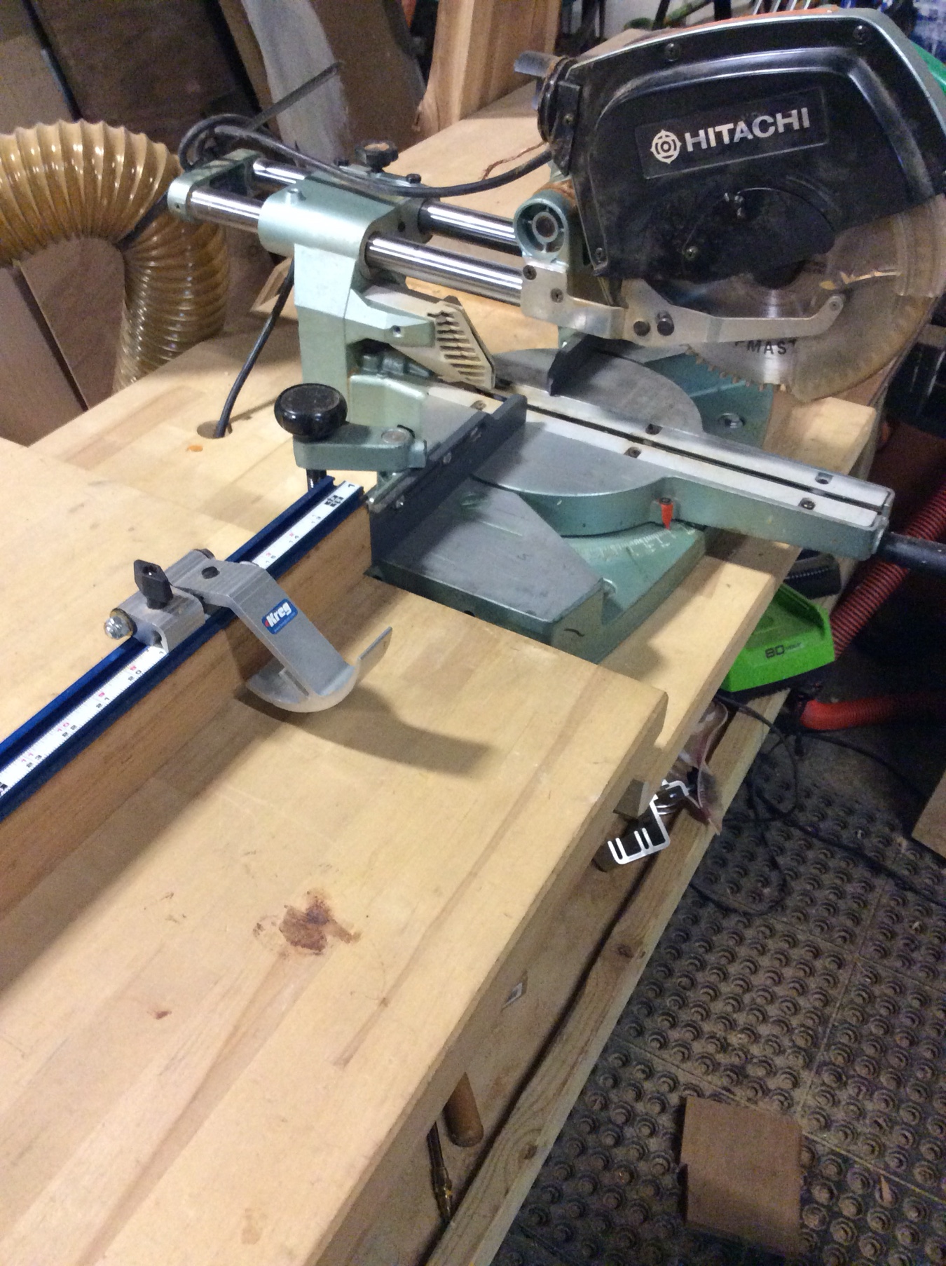

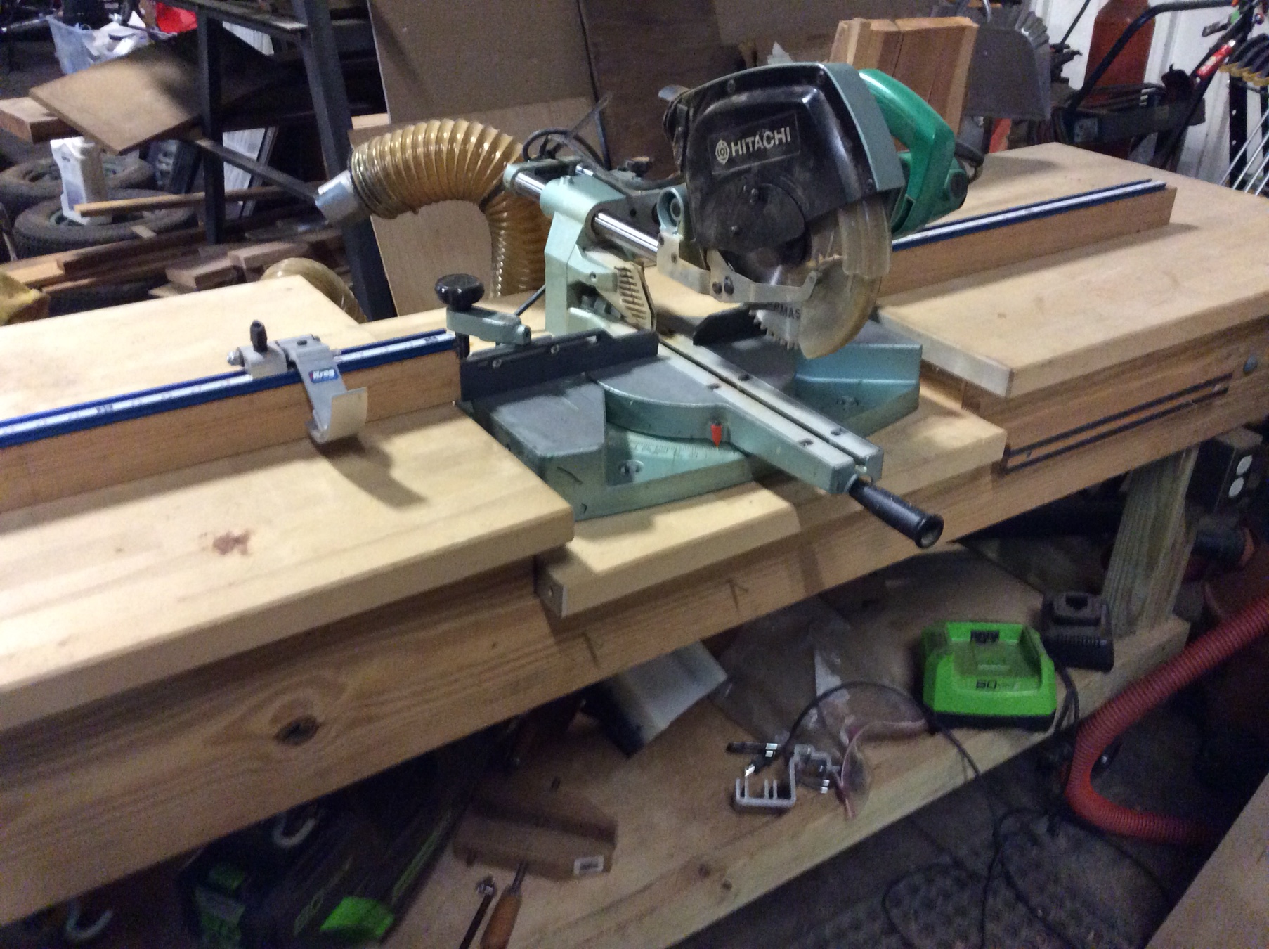

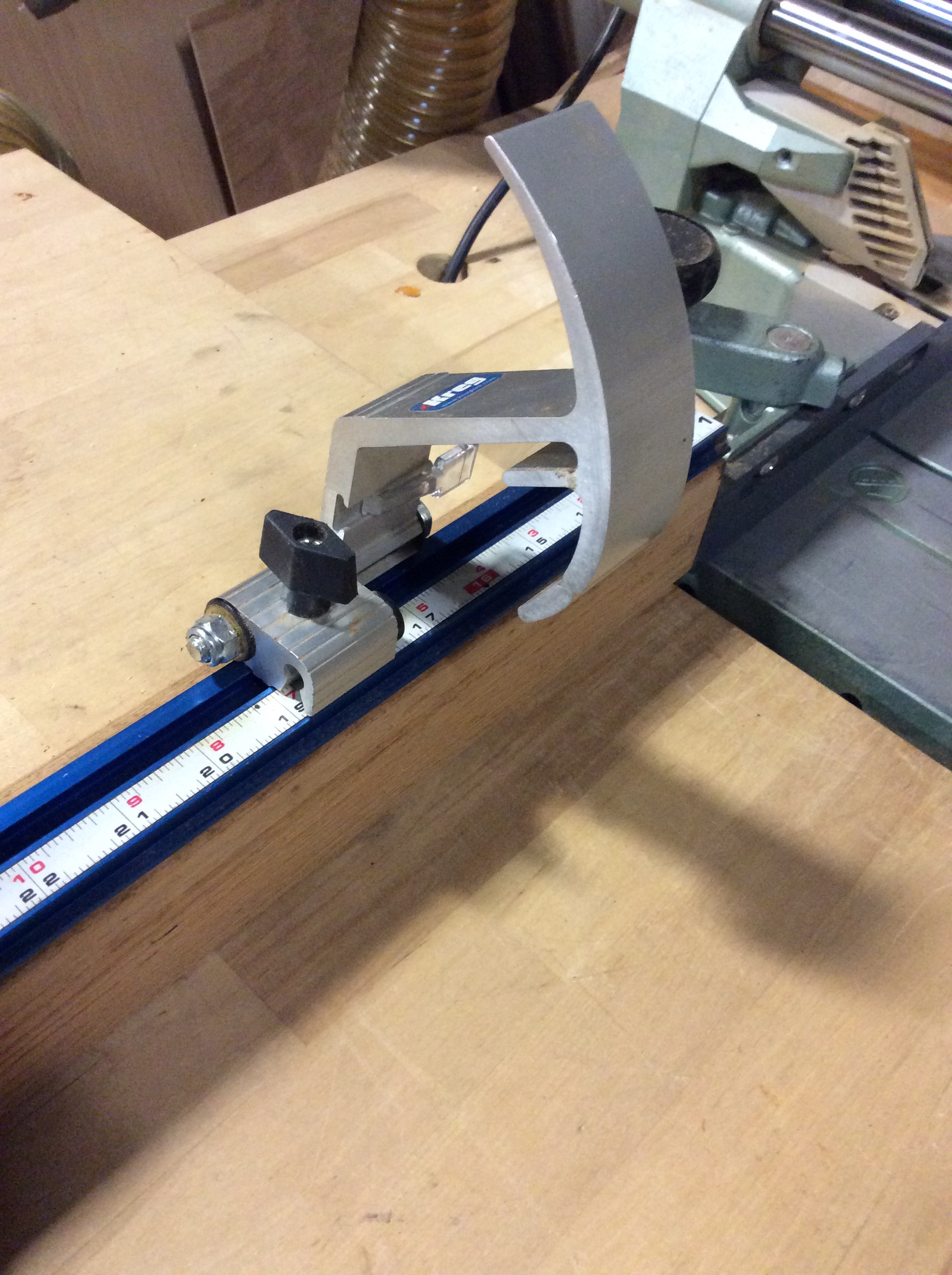

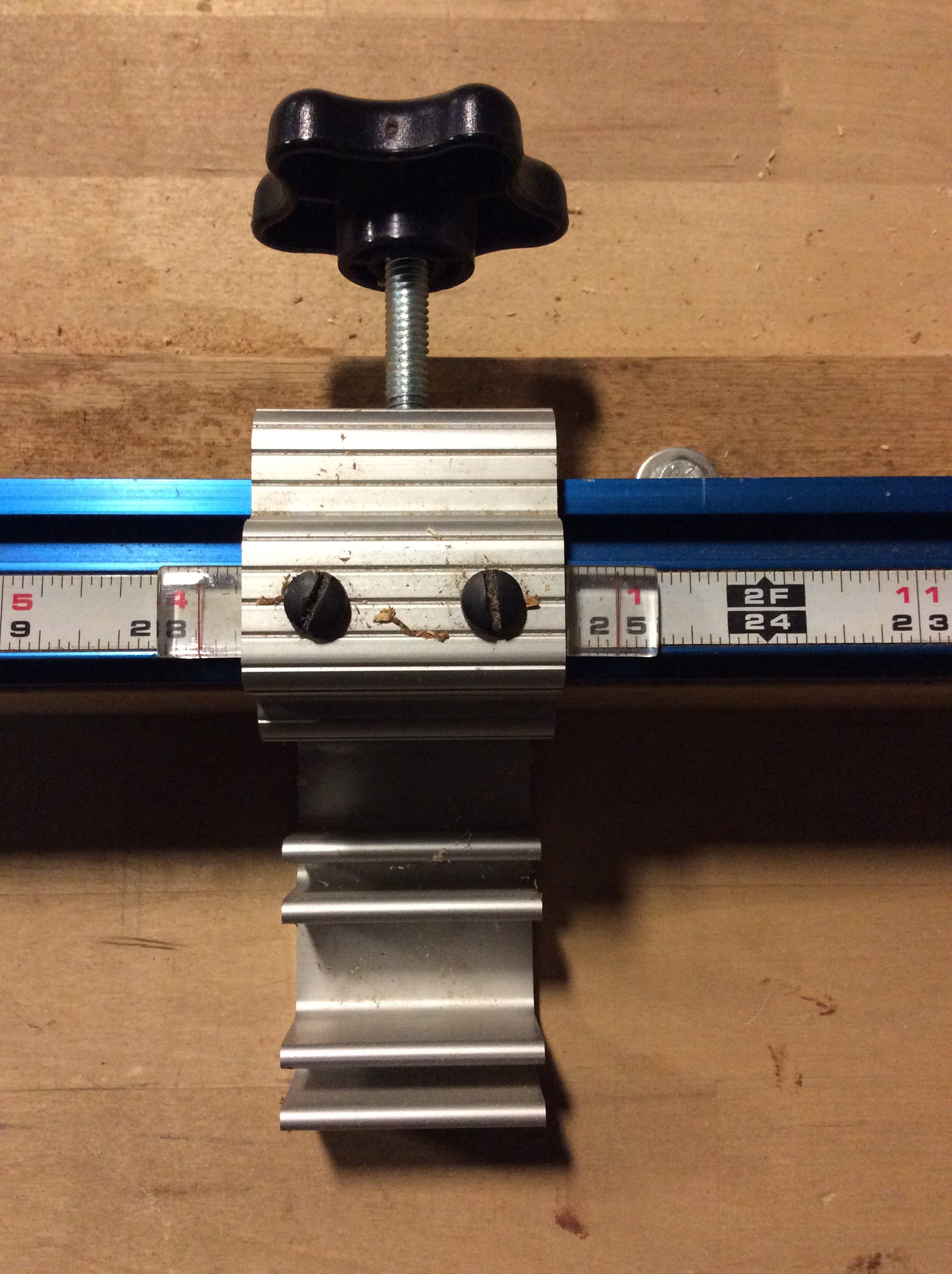

You should consider a smaller sliding compound saw, like the Hitachi 8 1/2”. It has plenty of capacity for most work and is way smaller than those giant sliders (I have both). But my Hitachi is permanently mounted and I use it for all my furniture building. I strongly recommend installing an Incra fence system with a flip stop so repeated cuts can be done perfectly without measuring. This set up takes up very little space and works great. Mine doesn’t have a laser, but with the magnifier on the flip stop, you don’t need it. Plus I don’t trust lasers anyway. IMG_0797.JPGIMG_0796.JPGIMG_2407.JPGIMG_2407.JPG
Either of these stops work great but I like the flip stop so I can square a longer board without losing my set index.IMG_2407.JPG Plus these saws are relatively cheap, around $300
