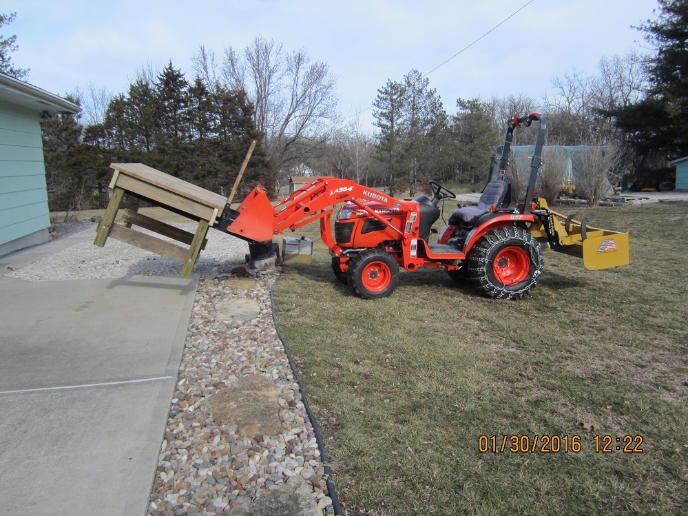

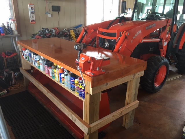

My shop space is rather limited so I fabricated a work bench over my tractor bucket? It works great for projects, and also makes a decent serving table and place to sit around for a cold one.

Nice! Also a good operator competency test. That first control input after you start the tractor better be correct and precise.

I like the shallow spray can shelf, may have to do that on my next shop reorganization...

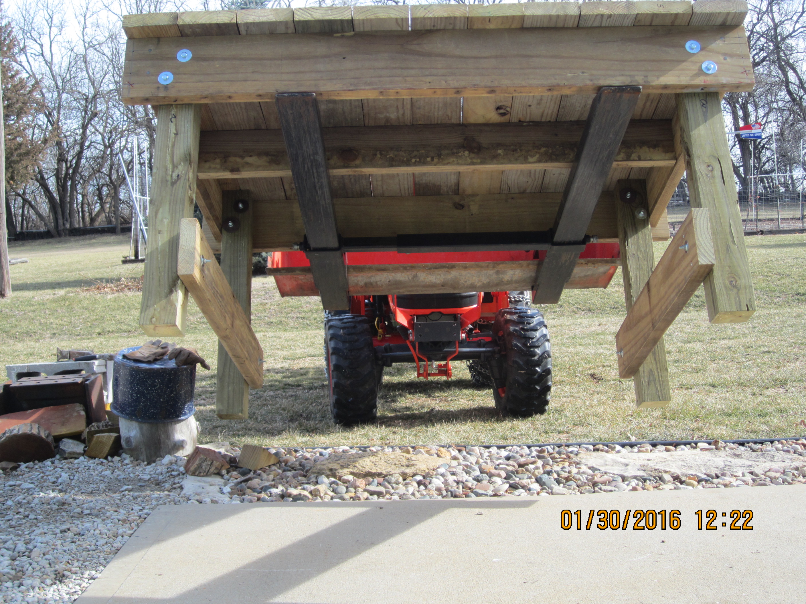

I actually left six inches of clearance on each side and three inches above so entry and exit is pretty forgiving. I also designed it so I can raise the bucket four inches and lift the bench level for moving outside the shop when the weather is too nice to be inside. The vise is a blue Kobalt from Lowe's but my better half convinced me to paint it Kubota orange. I added a bungee cord to keep the spray cans in place for when moving the table around or making 'adjustments' with the vise and a large hammer.

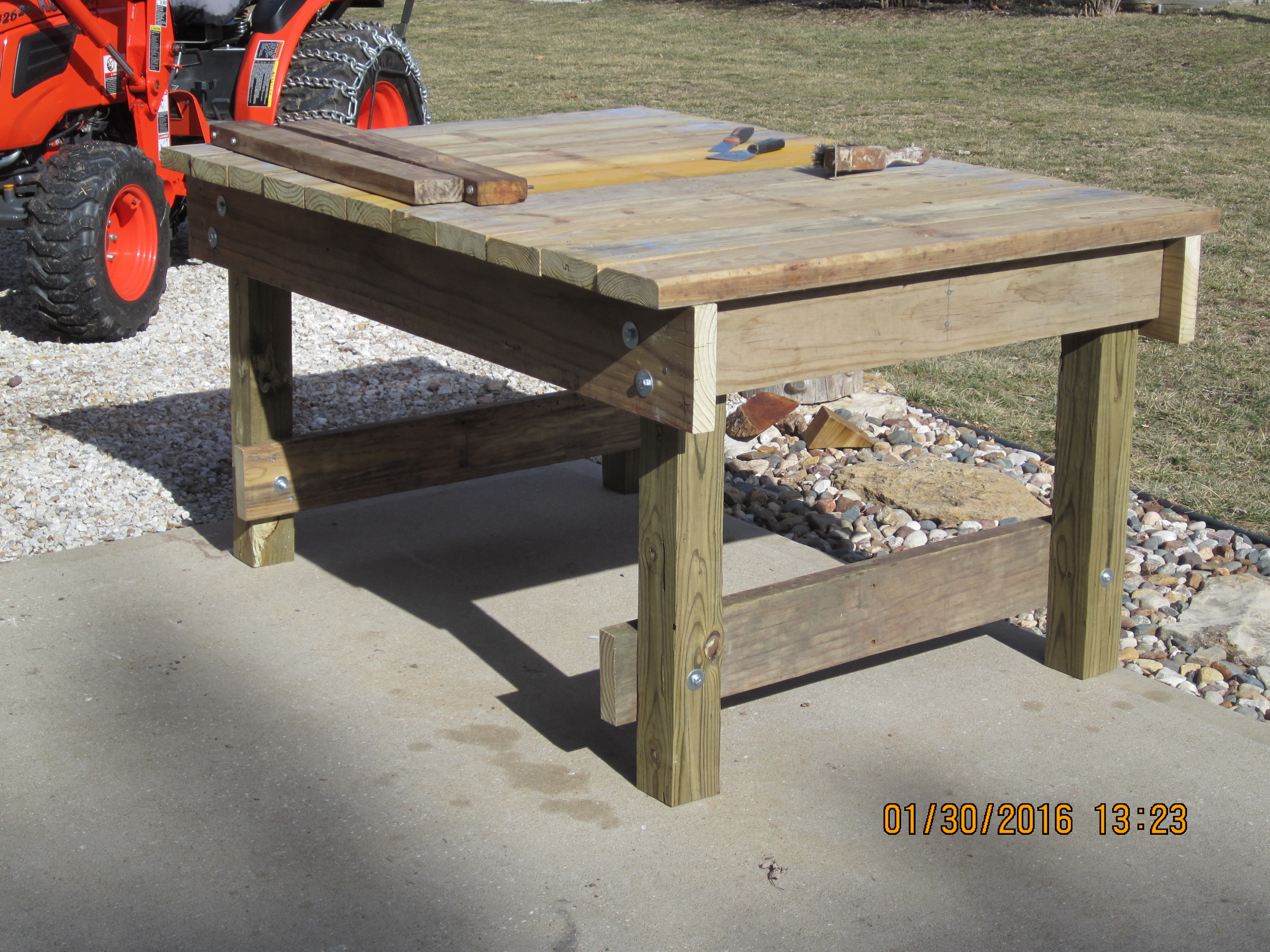

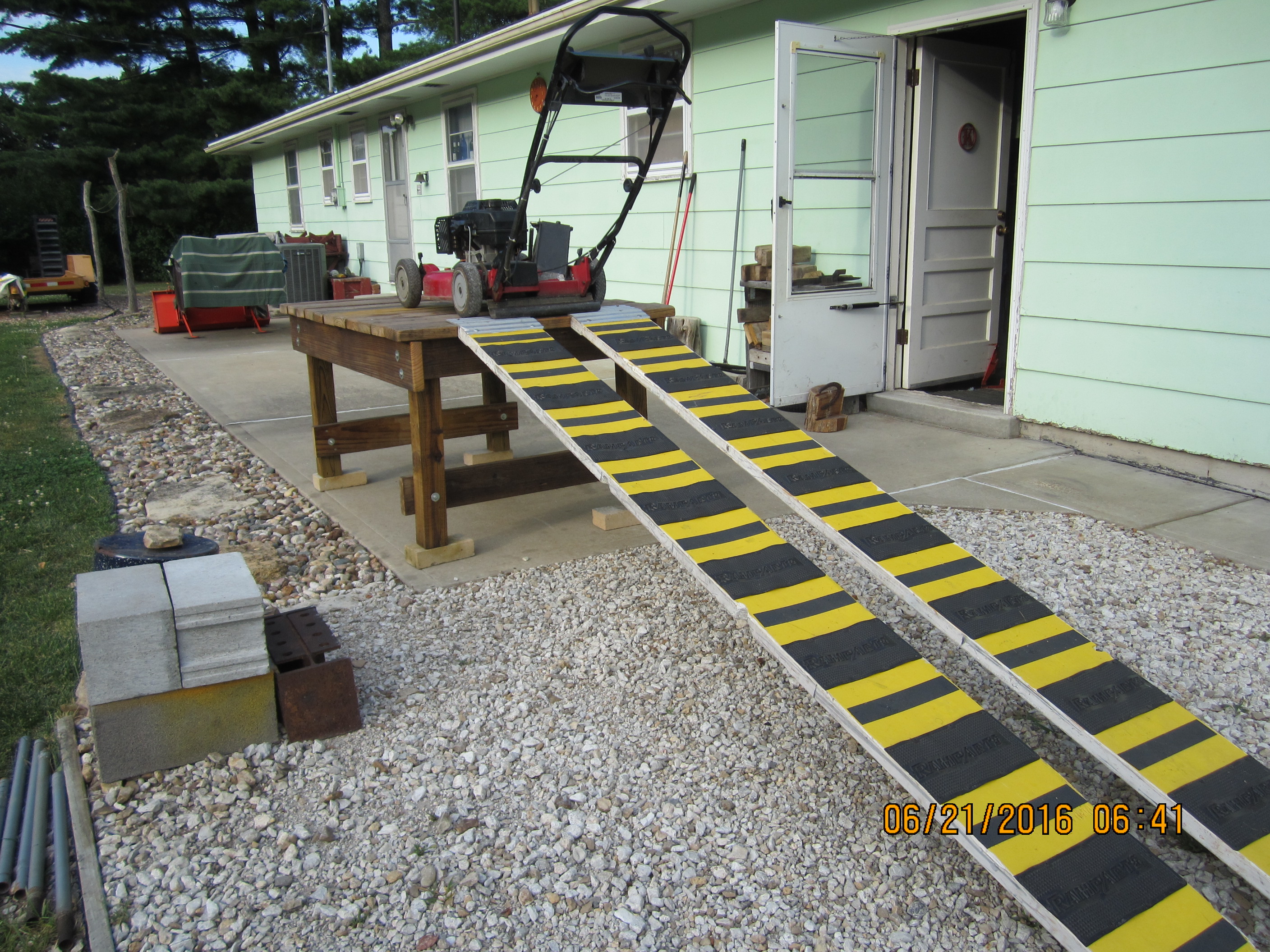

JC, Your indoor/outdoor workbench is really nice. Above is one I made mostly from scrap lumber. It's right outside the garage door and quite handy.001.JPG
