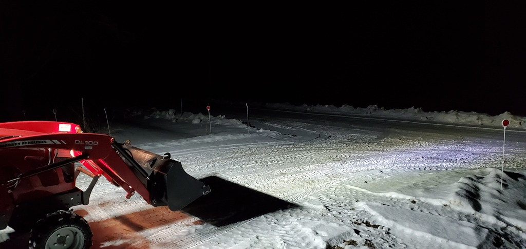

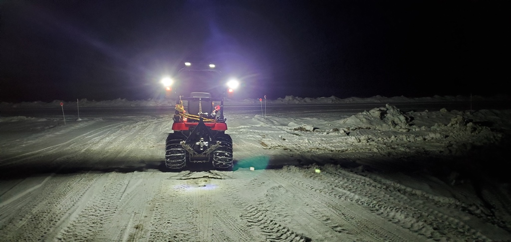

79$ amazon for my 19" led, 6 4" led.
19" and 4 of the 4" mounted. 2 4" face backwars 2 face down onto 3pt area.

only had this one for one season, I do have block heater and battery maintainer. maintainer is really the most critical.
I wired (fused) direct off battery to 2 switches I mounted in left plastic wraparound piece so they would not get hit on accident but are easily reachable. one switch powers the 19" led facing fwd, other powers the 4 4inch lights which 2 face rear and 2 face onto my 3pt.
19 inch and the 2 facing 3pt are mounted to top of rops with a 4x4 spacer (I am not a tlb so my rops sits lower) to prevent head blocking light.
2 rear facing are hung right off the lower side of the blinker light guards. my gc2400 has guards welded to rops.
yeah I did have to drill rops, made informed decision on it but that method is not for everyone.
