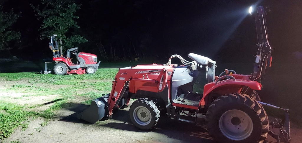

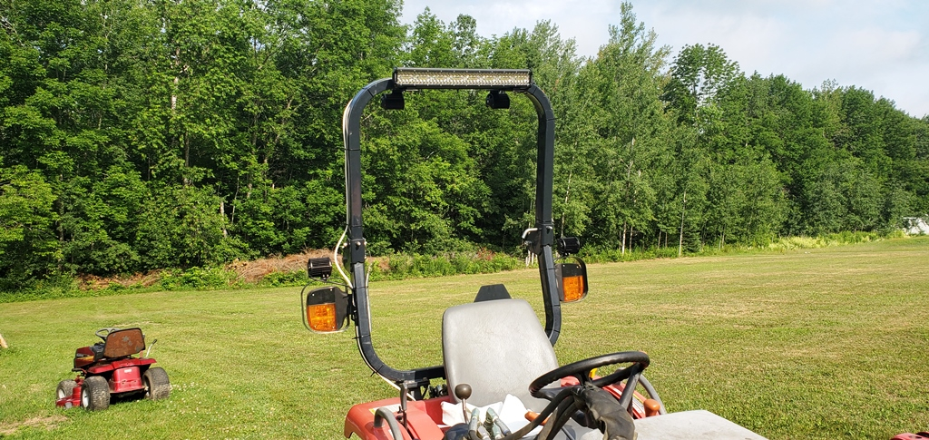

only had this one for one season, I do have block heater and battery maintainer. maintainer is really the most critical.
I wired (fused) direct off battery to 2 switches I mounted in left plastic wraparound piece so they would not get hit on accident but are easily reachable. one switch powers the 19" led facing fwd, other powers the 4 4inch lights which 2 face rear and 2 face onto my 3pt.
19 inch and the 2 facing 3pt are mounted to top of rops with a 4x4 spacer (I am not a tlb so my rops sits lower) to prevent head blocking light.
2 rear facing are hung right off the lower side of the blinker light guards. my gc2400 has guards welded to rops.
yeah I did have to drill rops, made informed decision on it but that method is not for everyone.
Thank You for your reply! I did notice the pictures from a earlier post , But I couldn't see how the where mounted because it was to dark ! But they where putting out some excellent light & thanks for the info on the install.

MF1532 will have pics later of rev/pto lights (was daytime when finished) but 80$ for lights before tax.
fused power run from battery to 2 switches in right rear fender then one switch runs main fwd light and other runs the rev/pto lights. slack built in to allow tilting ROPS backwards as needed. 14g marine wiring used, sadly nobody locally has black coated marine wire.
fwd light only on
