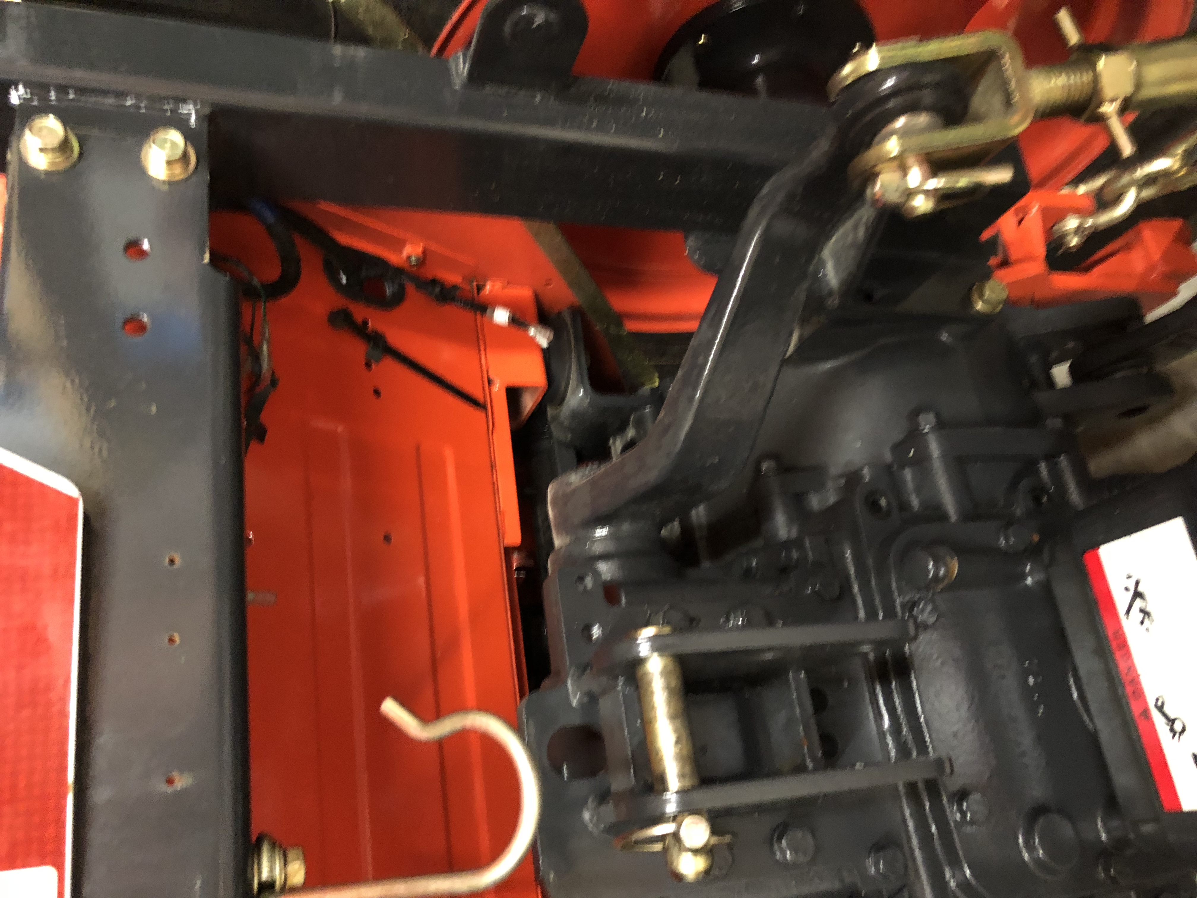

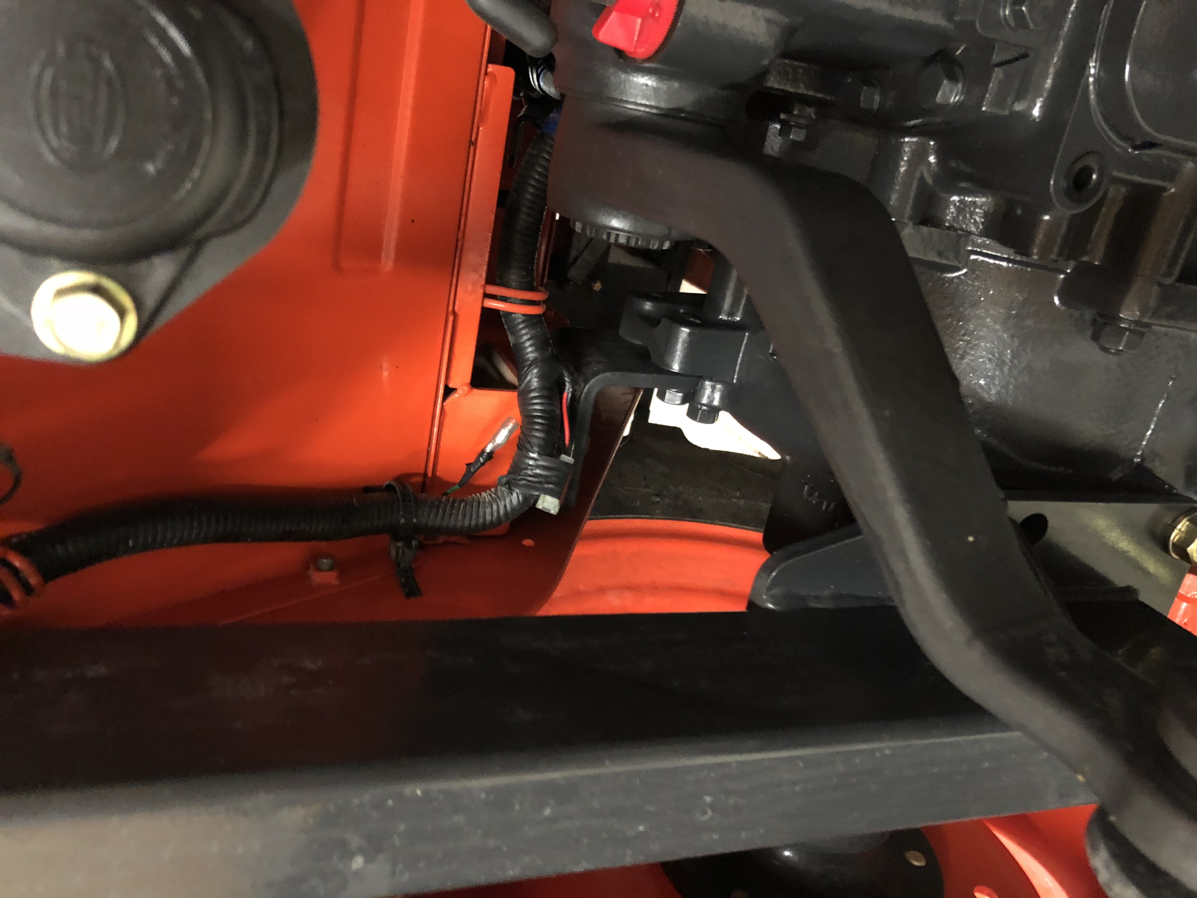

Hi there. Want to add from and rear work lights to my DK 4510 for winter snow removal use.
What is the best wiring choice. I see some unused connections on the back. Any chance these can be useful?

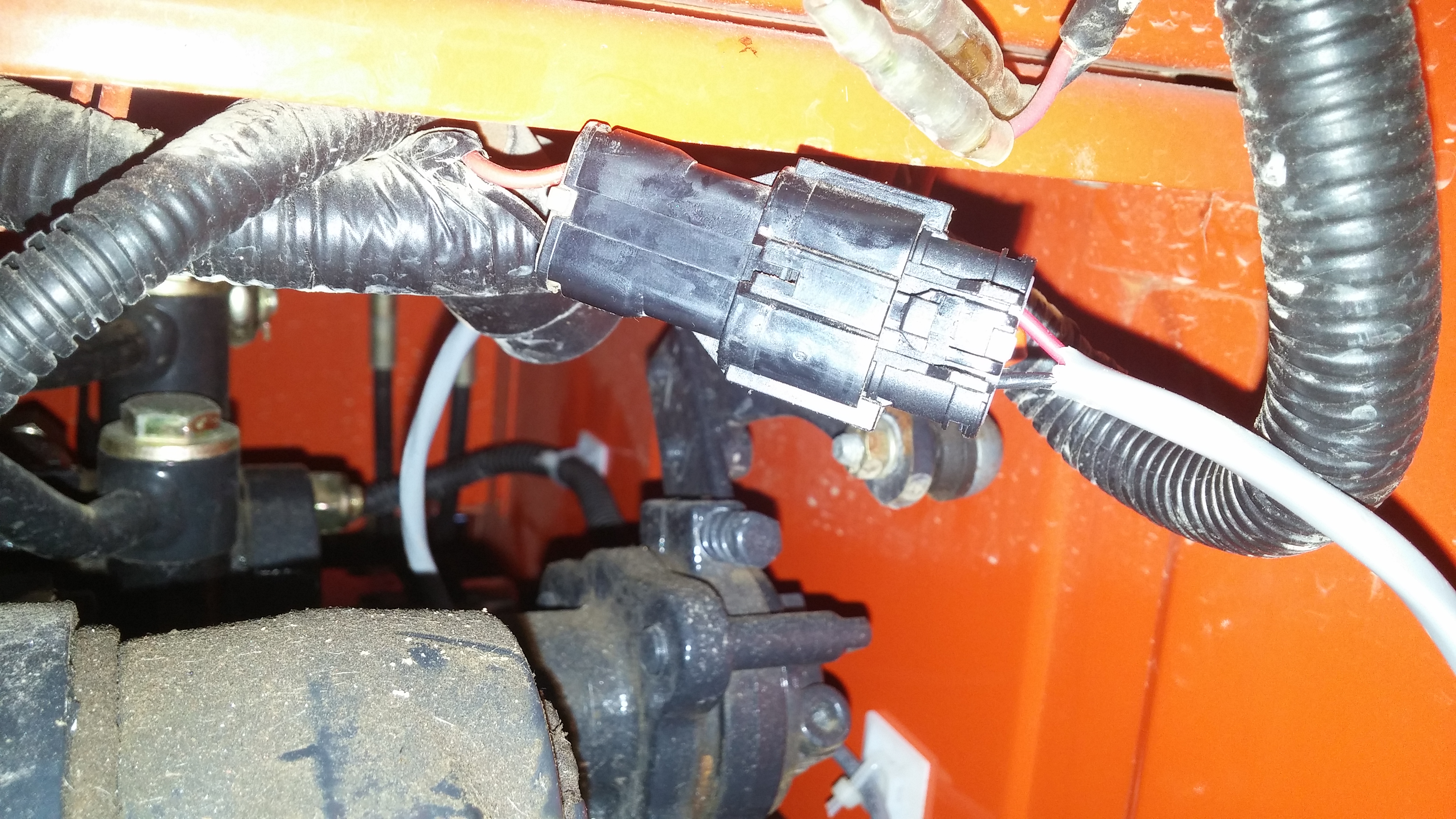

most tractors are built with wires for a rear light even if doesn't come with one (a dealer addon) turn on the switch and check voltage at the unused wires. If there is 12 volts on the wires now then they are there for rear light.
/ Work light LEDs DK 4510 #3
Not sure if yours has it but most Kioti's have a spare fuse with a rear connection point. On mine I actually found the connector on line that fit it and used the power to wire in my 3rd function valve. Here is a picture of mine, Rear right hand side. 20170409_135707.jpg
/ Work light LEDs DK 4510 #4
Not sure if yours has it but most Kioti's have a spare fuse with a rear connection point. On mine I actually found the connector on line that fit it and used the power to wire in my 3rd function valve. Here is a picture of mine, Rear right hand side. View attachment 567067
What is the name of the connector? I’m trying to find one on Amazon but not having any luck. Thanks
